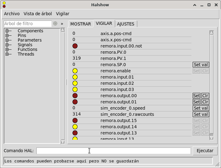

I'm still researching Remora, you never stop learning, as it says in the remora documentation Index signal is shared with the digital input pin, that is, the databit on the pin where we physically connect index pin must be set in the QDC configuration as well: or it would look like this:
"Thread": "Servo",
"Type": "QDC",
"Comment": "QDC Encoder A-IN11 B-IN12 I-IN14",
"PV": 1,
"Data Bit": 17.
"ChA Pin": "P4_00",
"ChB Pin": "P3_23",
"Index Pin": "P4_15",
"ENC No": 2
since in firmware *(this->ptrData) points to the inputs and this->mask= 1 << this->bitNumber
set the index input *(this->ptrData) |= this->mask;
clear the index input *(this->ptrData) &= ~this->mask;
everything working now although with some modifications, I was looking at the functions included in the QDC driver fsl_enc.c:

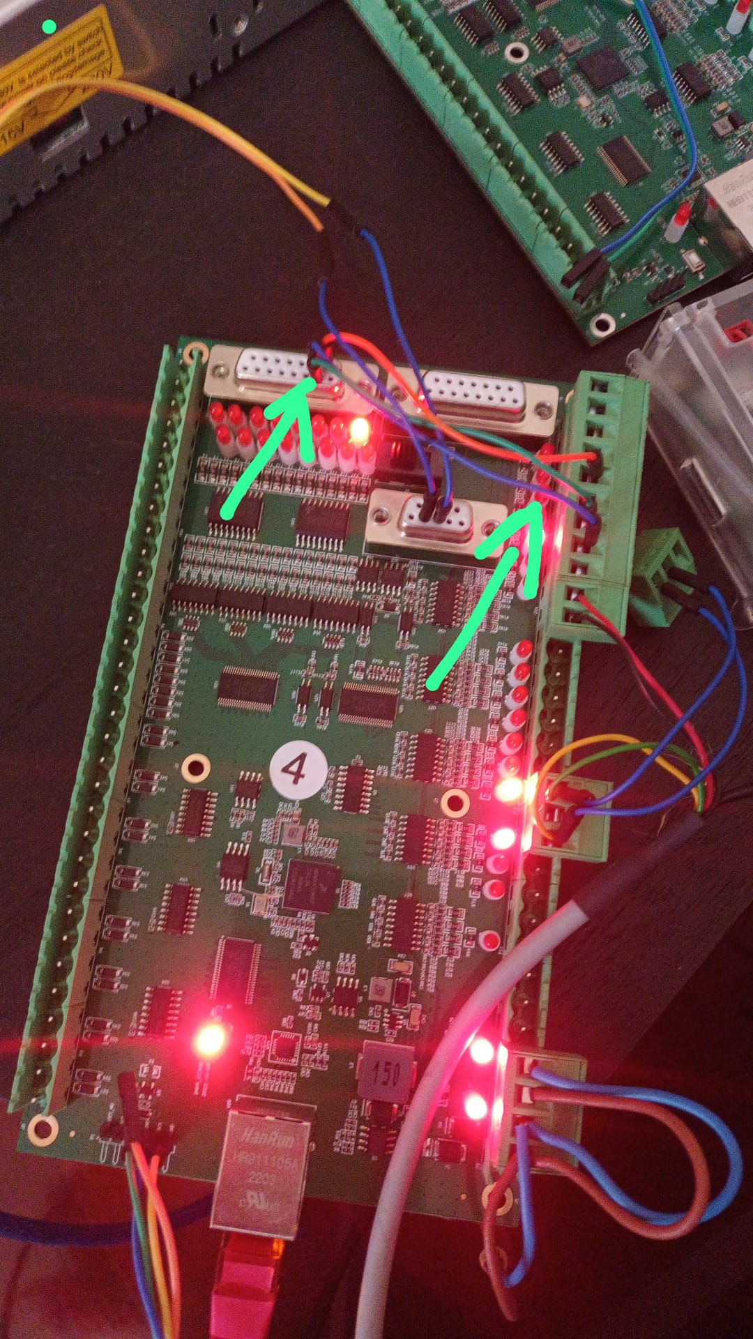

- GeramyL
- Posts: 74
- Thank you received: 6
09 Oct 2023 02:21 #282582
by GeramyL
Replied by GeramyL on topic Remora - ethernet NVEM / EC300 / EC500 cnc board
How are you tracing your pins out? I'm not sure if you saw my comment about and i'll use the common names for these pins, XP-, XD-, YP-, YD-, ZP-, ZD-, AP-, AD-, BP-, and BD- that these pins may not be setup correctly, I have had to wire all my negative lines on the stepper drivers straight to common instead of using these pins. It seems these negative pins are flipping from positive to negative and all kinds of crazy thing, that I could tell. I could be wrong but I don't think so. Do you have these pins mapped out? Maybe we can sink these to ground, make them a input. Also you might be able to use these pins also for other stuff as well, whats the specification on the actual chip thats connected to these pins, are they input, output, or both?
