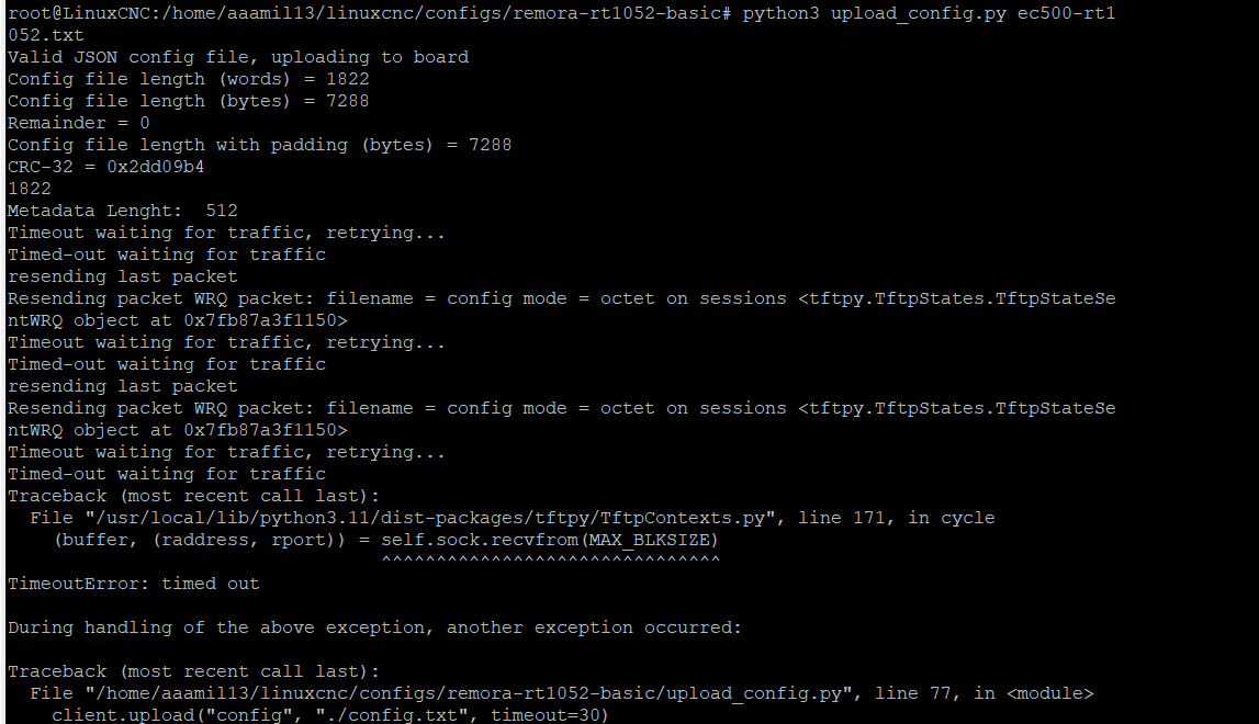

God bless you scotta, I was on my way to give up with EC500, but with the last build everything work great, except TFTP, but I rebuild it with changed default JSON. Thanks for the great work you do. Ping is between 200-400 us, stepgen works perfect with no follow error. Continue to test but for now works perfect.

For the tftp error try
Sudo apt install python3-pip
Pip3 install tftpy
That did it for me. Sorry for the formatting but I'm on mobile but you get the idea.
Pip3 will install the python3 tftpy module. Pip will install only for the 2.7
28 Sep 2023 18:09 - 28 Sep 2023 18:14 #281810 by aaamil13
Not a Python problem, just TimeOut while trying to upload config file. Tried to upload with script and TFTP in terminal ( the file produced from script) but with no success.
tcpdump port 69 -vv
tcpdump: listening on eno1, link-type EN10MB (Ethernet), snapshot length 262144 bytes
21:04:06.187537 IP (tos 0x0, ttl 64, id 53926, offset 0, flags [DF], proto UDP (17), length 43)
    LinuxCNC.43235 > 10.10.10.10.tftp: [bad udp cksum 0x2851 -> 0x29d8!] TFTP, length 15, WRQ "config" octet
21:04:36.211690 IP (tos 0x0, ttl 64, id 61158, offset 0, flags [DF], proto UDP (17), length 43)
Unfortunately can't read debug messages on UART ( seems that TTL level shifter burned while been connected to RS232)
So i decided to compile with integrated config JSON and that is ok for me. The good news is that Version 2.0.0 with DMA is much better, the possibility to control pulse width and 500khz stepgen ( tested at 90khz and it is ok ).
