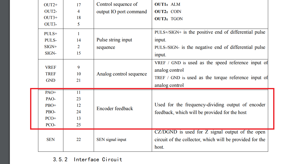

14 Oct 2023 20:06 #283014
by GeramyL
Replied by GeramyL on topic Remora - ethernet NVEM / EC300 / EC500 cnc board
Actually to think about it I do have some 220v servos and encoders. Do you think the motor would work with the servo drivers without the encoder plugged into the driver itself and use the driver as open loop and close the loop on the remora board??Hello everyone here, it has taken me a few hours to change the interruption from the Index pin to GPIO mmmmm, dark things hahaha, but well the news is very good at the point I am now you can use the 4 ENC (Qdc) Well, following Scott's brilliant idea of using the GPIO interrupt for the Index pins, we have more pins free in XBAR, I urge those who have motors with encoders to try and comment on the results, I hope that encoder arrives soon Scott, greetings.
My repository in case you want to take a look.
***** I have created another branch for the interruption version per GPIO module QdcIndexGpioInterrupt branch, in the main branch there is the interruption implementation through the Index signal of the ENC Modules (Qdc)******

15 Oct 2023 12:02 #283058
by rbobey1989
Replied by rbobey1989 on topic Remora - ethernet NVEM / EC300 / EC500 cnc board
mmmm, I don't think those servo drivers operate in open loop......

15 Oct 2023 18:20 #283082
by GeramyL
PAO+ PAO- PBO+ PBO- PCO+ PCO-
11. 23. 12. 24. 13. 25
Encoder feedback
Used for the frequency-dividing output of encoder feedback, which will be provided for the host
Looks like it has encoder feedback on the driver.mmmm, I don't think those servo drivers operate in open loop......
Encoder feedback

15 Oct 2023 18:21 #283083
by GeramyL
It’s a K1 Series AC Servo Driver

15 Oct 2023 22:36 #283098
by cakeslob
Replied by cakeslob on topic Remora - ethernet NVEM / EC300 / EC500 cnc board
yeah, if you use the servo driver feedback out, you can use it that way

15 Oct 2023 23:56 #283101
by GeramyL
How many encoders are supported on the ec500? Which wires would you use to relay back to linuxcnc?yeah, if you use the servo driver feedback out, you can use it that way

16 Oct 2023 00:30 #283103
by cakeslob
probably a b c, not sure about sen. not sure if C is the same as Z/index though.
not sure the encoder status on the ec500, if its software encoder it should be 6 i think. Dont know where you guys ended up with the QEI encoder thing.

16 Oct 2023 17:20 #283134
by GeramyL
So is that just one encoder then or 3?probably a b c, not sure about sen. not sure if C is the same as Z/index though.
