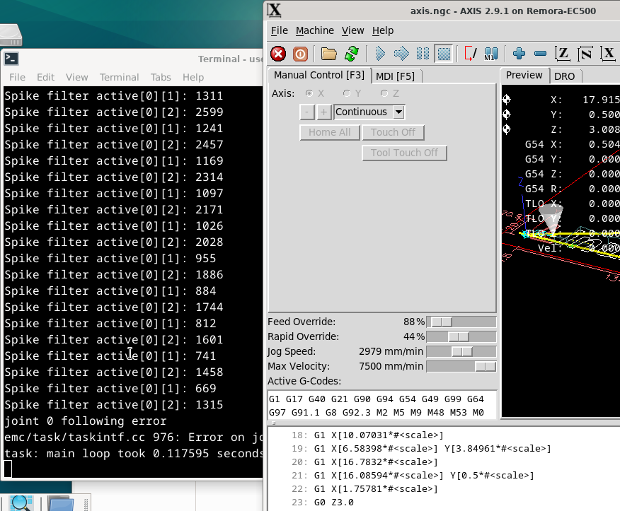

- hanskuster
- Posts: 20
15 Nov 2023 22:30 #285551
by hanskuster
I updated to the newest firmware and modified according to the info from scotta (forum.linuxcnc.org/18-computer/44828-rem...rd?start=1360#285461)
After many tries and tests I found that the stepper motor moves though, but only under certain conditions which I have no explanation for:
- I had to change the [JOINT_0].SCALE from 3000 to 6000
- when running the sample program axis.ngc the stepper move only sometimes, maybe bigger rapid moves?
Whenever the stepper moves, then I get many "Spike filter active..." in the console.
In Jog I can move the stepper only in bigger moves like 5mm and up. On smaller steps the motor doesn't move at all. Only its position on the display changes.
Any Ideas?
Regards, Hans

- scotta
- Posts: 959
- Thank you received: 489
16 Nov 2023 20:43 #285656
by scotta
The following line must to match the controller board servo frequency.
should be
ie 1khz
Wow, I've never seen the spike filter active in the Ethernet version. I think this is due to miss match between the LinuxCNC servo period and the controller board servo period.
Hey Hans,
Since we are using external hardware, I dont think that we use a basethread. That is mostly for parallel port setups.
Its good that it shows up in the preview
Hi cakeslob,
Any Ideas?
Regards, Hans
SERVO_PERIOD = 3000000should be
SERVO_PERIOD = 1000000ie 1khz
