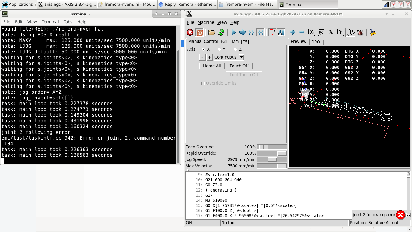

Hello everyone, I've been having a problem for days that I can't resolve.
joint 2 following error
emc/task/taskintf.cc 942: Error on joint 2, command number 104
The NVEM card communicates perfectly with linuxcnc, but when I ask it to start gcode I always get this error.
Could someone please help me.

Do you get this error if you do a full chip erase and upload the firmware without uploading a config.txt file?Hello everyone, I've been having a problem for days that I can't resolve.

- FCS Industrial
- Posts: 10
08 Nov 2023 05:56 #284841
by FCS Industrial
Replied by FCS Industrial on topic Remora - ethernet NVEM / EC300 / EC500 cnc board
Hello Scotta, thanks for responding.
Yes that's right. I get the same error when loading the chip completely without loading config.txt or with it.
I confess that I've tried everything, and I have no idea what could be happening.
My NVEm is STM32
My NVEm is STM32

- FCS Industrial
- Posts: 10
10 Nov 2023 02:09 #284995
by FCS Industrial
My NVEm is STM32
- scotta
- Posts: 959
- Thank you received: 489
10 Nov 2023 20:34 #285046
by scotta
Can you jog at all? Please share your hal and config.txt file and I'll take a look. It has to be a configuration issue.
My NVEm is STM32
