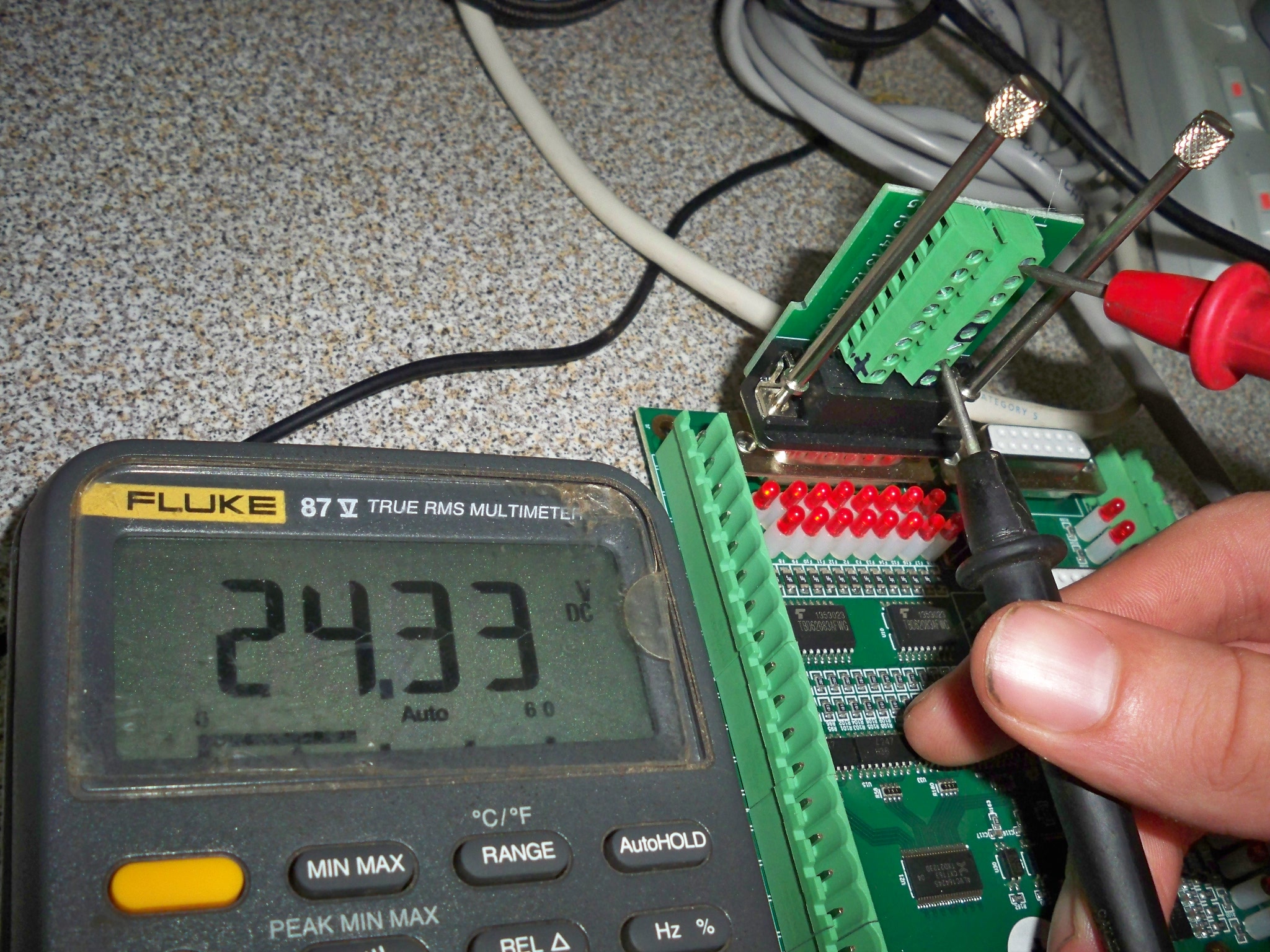

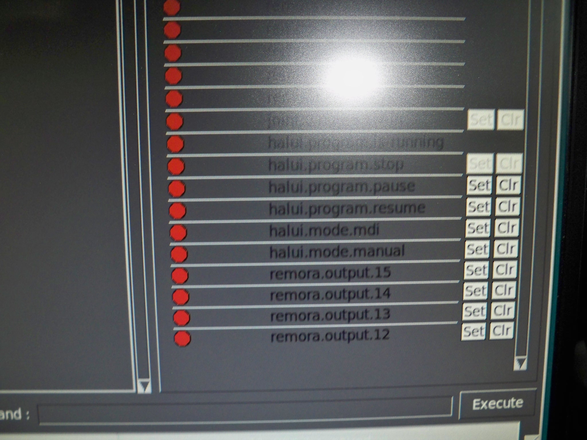

Hi Alex, I've just tested your config.txt on my EC500 with latest firmware version v2.2.1 and the outputs are working as expected.Hi there Scott
I have flashed my EC500 with the latest firmware & am having a bit of a strange problem. Output pin 14 does not seem to be toggeling for me.
my machine is setup so that when the power on button is pressed in LinuxCNC output 14 comes on enabling the relay for the main drives...
net switch_on halui.machine.is-on remora.output.14 remora.output.13
When I turn the machine on most of the relays turn on (in the EC500) as part of the power up cycle and then turn off but output 14 seems to stay on.
I have disconnected all of the wires from the DB15 board & measured with a volt meter.
If I toggle remora.output.15 & measure between 1 & 15 on the DB15 it goes from 0 to 24v
if I toggle remora.output.13 & measure between 1 & 14 on the DB15 it goes from 0 to 24v
if I toggle remora.output.14 & measure between 1 & 7 on the DB15 it stays at 24v
Which is strange because it seemed to work as expected before I flashed the new firmware.
I have uploaded the same config file as before. (attached)
When attached to the relay & turn off it would sometimes have 8v measured !?!
I have attached the hal files also.
Could you please check to be sure there is not something in the software that could cause this.
Alex

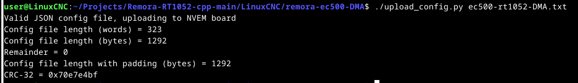

I have a EC500 board which I flashed with the firmware remora-rt1052-2.1.1.bin
When I upload "ec500-rt1052-DMA.txt" with upload_config.py I get the message "JSON config length incorrect" from the EC500 console.
I tried different files and all gave the same result.
Regards, Hans
Addendum:
As a test I flashed "remora-rt1052-1.1.0.bin" and then I can upload the config file.
So that seems to be a bug in the most recent firmware file.

Hi, I've tried to replicate your issue. A full chip erase and firmware flashed from repo. Using your config.txt I get the following successful result..Hi all,
Regards, Hans
Addendum:
pi@remora:~/linuxcnc/configs/remora-ec500-DMA $ python3 upload_config.py ec500-rt1052-DMA-issue.txt
Valid JSON config file, uploading to NVEM board
Config file length (words) = 323
Config file length (bytes) = 1292
Remainder = 0
Config file length with padding (bytes) = 1292
CRC-32 = 0x70e7e4bf## Entering IDLE state
Receiving new configuration. Stopping threads..
timer stop
timer stop
Checking new configuration file
mod = 0, padding = 0
Length (words) = 323
JSON length (bytes) = 1292
crc32 = 70e7e4bf
JSON Config file received Ok
Moving new configuration file to Flash storage and reset
pages = 6, sectors = 1
Configuration file moved
Remora RT1052 starting

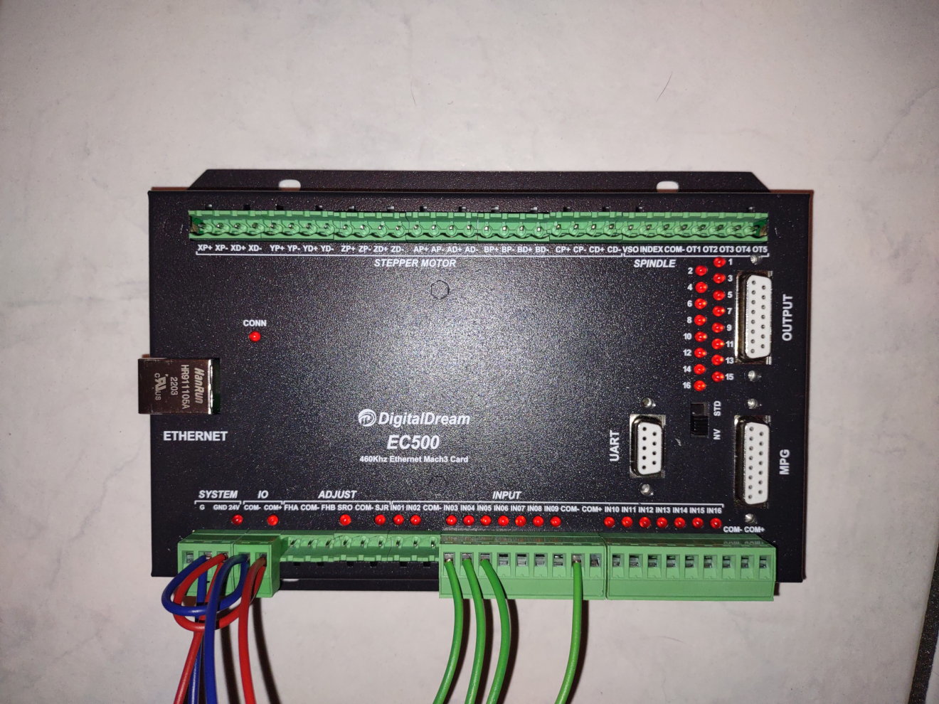

Hi there
I wonder if I could just get you to confirm that.
I have flashed remora-rt1052-2.1.1.bin & am still seeing this at 24v all the time.
I have uploaded some pics. Its not so clear in the picture but all of the LEDs are off.
If yours is working normally then I'm thinking it might be a hardware failure on my board.
Alex
Alex
