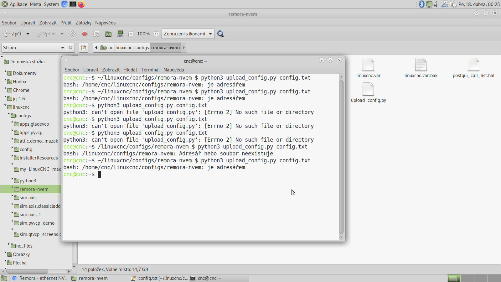

17 Apr 2022 22:29 #240513 by royka
first cd /to/the/folder/where/upload_config.py/is then python3 .......

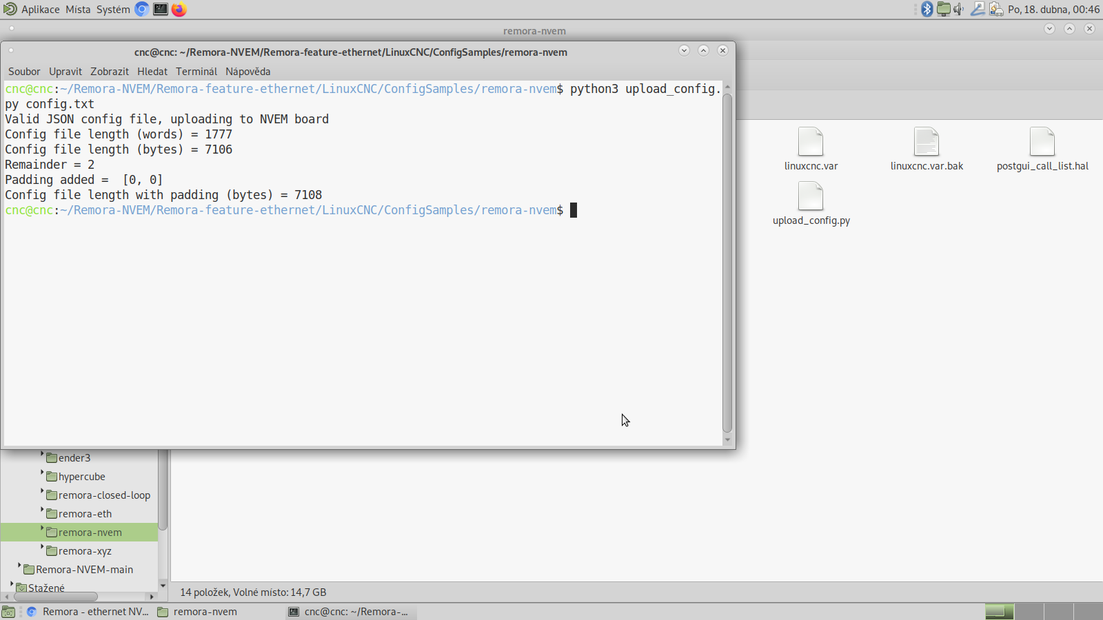

Okay. I'm functional: D I didn't know I needed to open a terminal window in / home / cnc / Remora-NVEM / Remora-feature-ethernet / LinuxCNC / ConfigSamples. And run the command in the terminals: python3 upload_config.py config.txt. Thanks. Still get windows and flood commands, fog flood and blow for the touch probe tool

I've got back down to the shed to test a few things. After a full erase and upload of the latest firmware bin, the following is what is output on the serial port. LinuxCNC is able to connect and following errors are reported as expected as no modules have been loaded. After upload of a config, all ok with no following errors. I will look to include a default config in the bin file somehow though.
