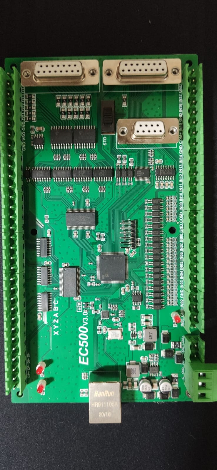

The number of Ethernet controllers supported by Remora firmware is increasing
. The Digital Dream EC500 is now 99% working with just the NVMPG and spindle analogue to resolve.
The owner of the board below will start testing soon. This board I hope (fingers crossed) will have the spindle analogue working as it uses the same components as the NVEM v3 I have. The EC500 board that I received looks to be an older version using a op amp for the analogue out.
With the number of boards increasing I'm proposing to change both the repo and the naming of the LinuxCNC component.
Propose to change / new repo to Remora-Novusun and have sub directories for the NVEM and EC500 etc.
The LinuxCNC Ethernet component to change to Remora-nv
Would this cause to many issues for people?

24 Jul 2022 13:41 #248167
by kwarup
Replied by kwarup on topic Remora - ethernet NVEM / EC300 / EC500 cnc board
Hi Scot, EC500 will have better frequency more than 40khz ?
- scotta
- Posts: 959
- Thank you received: 489
24 Jul 2022 21:34 #248193
by scotta
The default is 40khz but in the config and LinuxCNC loadrt command it is possible to increase the base thread frequency. Capped at 120khz at the moment.
MX_master's posts has got me working on a DMA step generator which should get the step rate significantly higher, I hope.
The following user(s) said Thank You: kwarup
