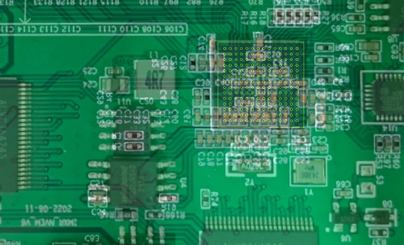

by scotta
To give an idea of what will help work out the IO. Using Rog's earlier photo's we get this the result below. A rule / scale in X and Y is the photo would also help scaling and stretching the images to get them to line up. This is going to be challenging... anyone remove solder mask of a board before? Being able to electrically trace this would also be beneficial.

by Bari
Replied by Bari on topic Remora - ethernet NVEM / EC300 / EC500 cnc board
If it is a dry film solder mask then it's likely polyethylene . You can try soaking it in xylene. If that doesn't loosen it then it might be an epoxy that will require some abrasive for removal.

10 Sep 2022 16:49 #251622
by MX_Master
Replied by MX_Master on topic Remora - ethernet NVEM / EC300 / EC500 cnc board
We can just solder out the chip using soldering station and hot fan. Any repair shops can do that work. After all the tests chip can be soldered back with re-balling technique.

10 Sep 2022 17:56 #251626
by scotta
I borrowed a SMD rework station to remove the optos from the EC500. Not sure if I'm that ambitious to attempt it. All those caps on the back of the board... :-0
