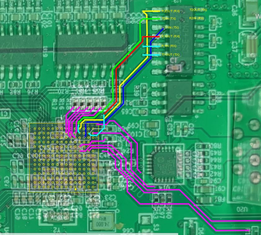

11 Sep 2022 21:36 #251706
by scotta
I borrowed a set of magnifying glasses. Should do the job. I'm thinking this will be the surest way as I've started to trace out using Rog's photos and cross referencing to the MCUExprsso config tool. But what appears to be a UART pin does not go to a UART enabled pad...? A close up of the tracks at the rear of the MCU would be super helpful.And loads of flux
it's pain they went with this style of chip. Harder to solder but once you have hot air and stencils it's do able. Do you have a microscope? I use a cheap Chinese one and does the job fine
- RogEnk
- Posts: 24
- Thank you received: 14
11 Sep 2022 23:58 #251712
by RogEnk
Replied by RogEnk on topic Remora - ethernet NVEM / EC300 / EC500 cnc board
- scotta
- Posts: 959
- Thank you received: 489
12 Sep 2022 02:29 #251718
by scotta
Hi Rog, something happened with the file / picture. It's not showing up.
- Bari
- Posts: 639
- Thank you received: 234
12 Sep 2022 02:40 #251719
by Bari
Replied by Bari on topic Remora - ethernet NVEM / EC300 / EC500 cnc board
Rog's post forum.linuxcnc.org/18-computer/44828-rem...ard?start=420#251712 pic looks fine here
- scotta
- Posts: 959
12 Sep 2022 02:42 #251720
by scotta
I get "The requested content cannot be loaded. Please try again later"..?
- Bari
- Posts: 639
12 Sep 2022 02:47 #251721
by Bari
imgur.com/a/wrr00rm a copy is here.
