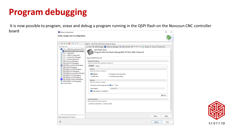

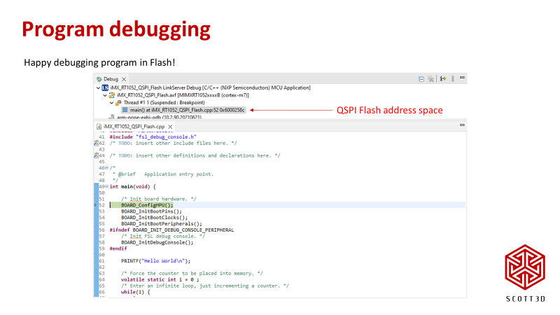

After frustrating myself with the J-OB v2 probe and J-Link software, which would successfully read the flash, but nothing I could do would allow erasing and writing the flash...
So back to MCUXpressoIDE to see if I could get a Flash debug setup working. And finally I have a working tool chain with a cheap and open source CMSIS-DAP probe (ST-Link v2 converted)
It was so nice to be able to load a program into the flash and step through the XiP address space
The LinkServer installed with MCUXpresso can be run from a command line script. This may be the easiest way for people to flash boards, but they will have to install the free MCUXpressoIDE.
I feel much more confident that we'll get Remora running on the RT1052 based boards now!

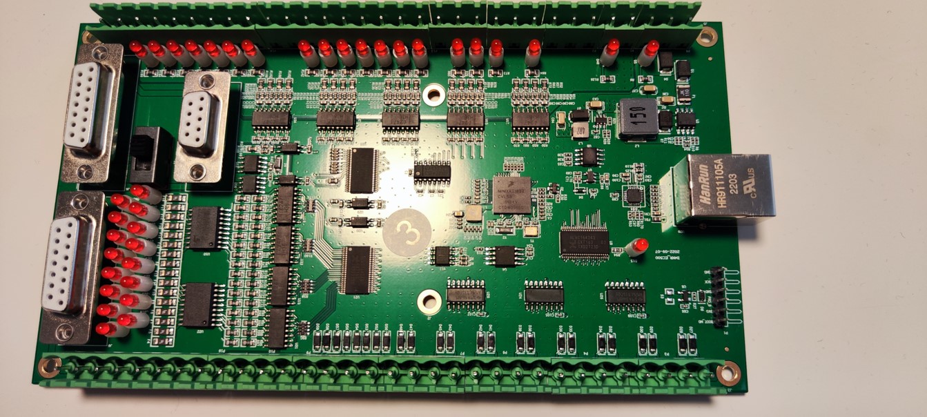

Now to remove the MCU from the board...

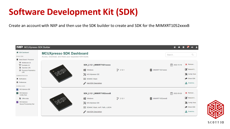

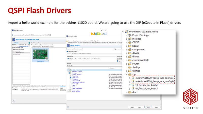

There has been a lot or research, trial and error to get to the point where we can program and debug the iMX RT1052 chip on these new Novusun CNC controllers. I've created a repo with a program template that is working with the EC300 controller board, but I see no reason why it wont work with the new NVEM, EC500 etc as the components on these boards appears to be the same.
github.com/scottalford75/iMX_RT1052_QSPI_Flash
This is also an opportunity over the coming posts to document how I got this working as some of the documentation on line does not work!

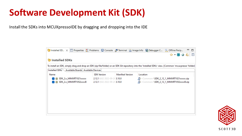

We'll be using MCUXpressoIDE for development and NXP has some tools to create Software Development Kits (SDKs). We'll need two SDK's. One for the RT1052 and another for the RT1021. The EVKMIMXRT1021 development board comes with QSPI flash so we'll take advantage of those drivers.
The following user(s) said Thank You: tommylight, MX_Master, mrbubble, Murphy, RogEnk

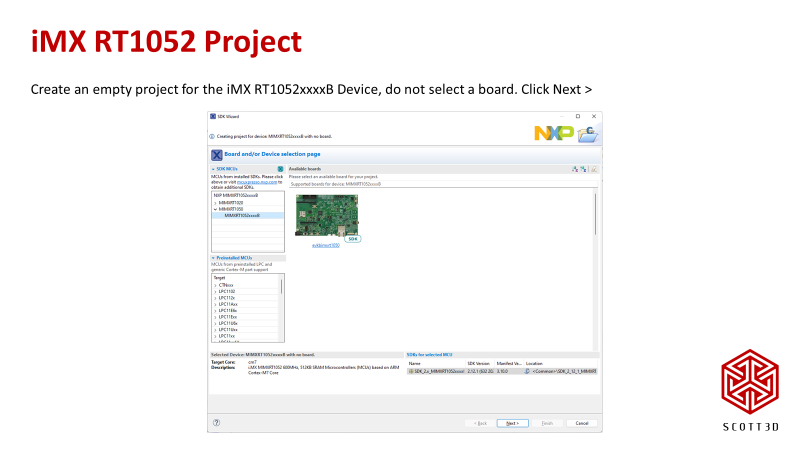

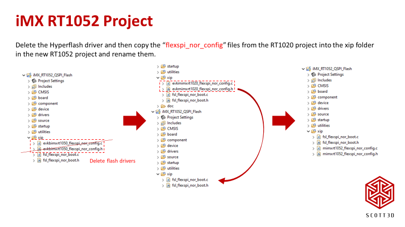

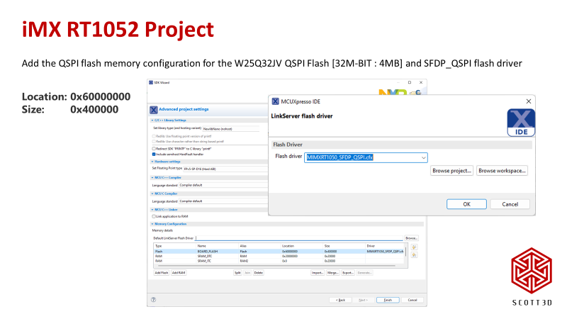

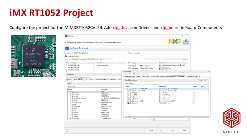

Now to the main game, creating the RT1052 project. Start a New Project and only select the Device, we don't want the overhead of the development board configuration, even though we do get some defaults come through. But we'll fix that.
Select the CVL5B package and add both the xip_device and xip_board. This will setup the linker configuration etc for us.

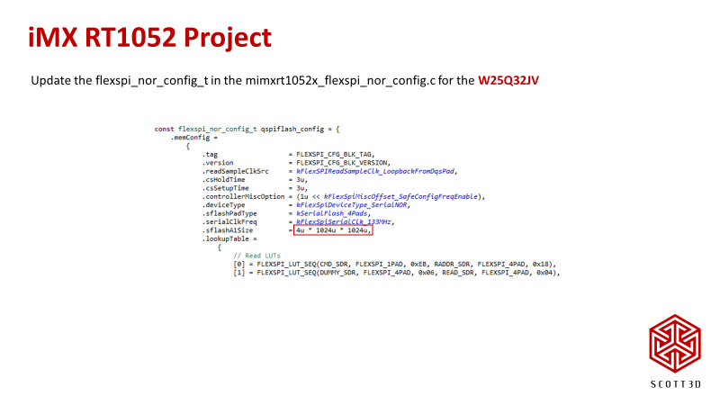

Click next and then configure the Flash. Click on Add Flash and then enter the details for the Winbond W25Q32JV flash. Also select the LinkServer flash driver. Use the MIMXRT1050_SFDP_QSPI driver. This was the key to getting up and going. This driver interrogates the Flash chip and self configures.
Next we will change the flash driver, the one that will be used by the BootROM to load our program, to the one from the RT1021. Delete the files from the xip directory and copy in the ones from the RT1021 and rename them.
The last step is to correct the flash size. Some documentation says to update some of the LUT settings, but the defaults work and the suggested changes fail, stopping the boot-up.

We can now test out debugging. A CMSIS-DAP probe is required and connect only 3 of the SWD pins. On the new NVEM and EC300 there is no 3.3v pin available, so the board needs to be powered.
Clicking on the Debug icon will bring up the Probes selection. Click ok and debug will start.
The LinkServer GUI Flash Tool can be used to run the separate program and erase scripts if needed.
Debugging will download the new program and launch the session. The program should halt at the breakpoint automatically set at main and we should be in the Flash address space of 0x60000000. Now to get programming....
The following user(s) said Thank You: skench, tommylight, MX_Master, mrbubble, RogEnk
