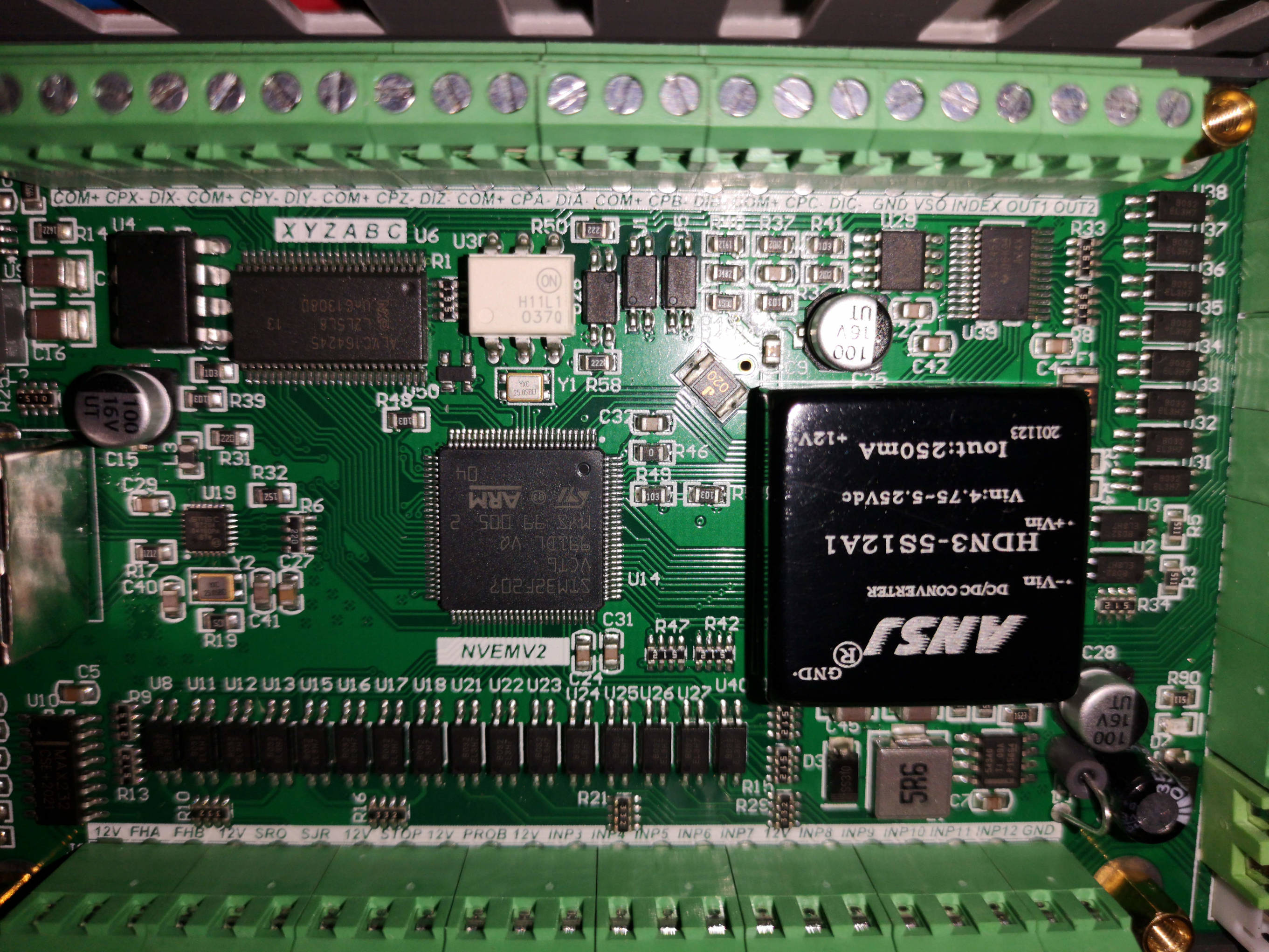

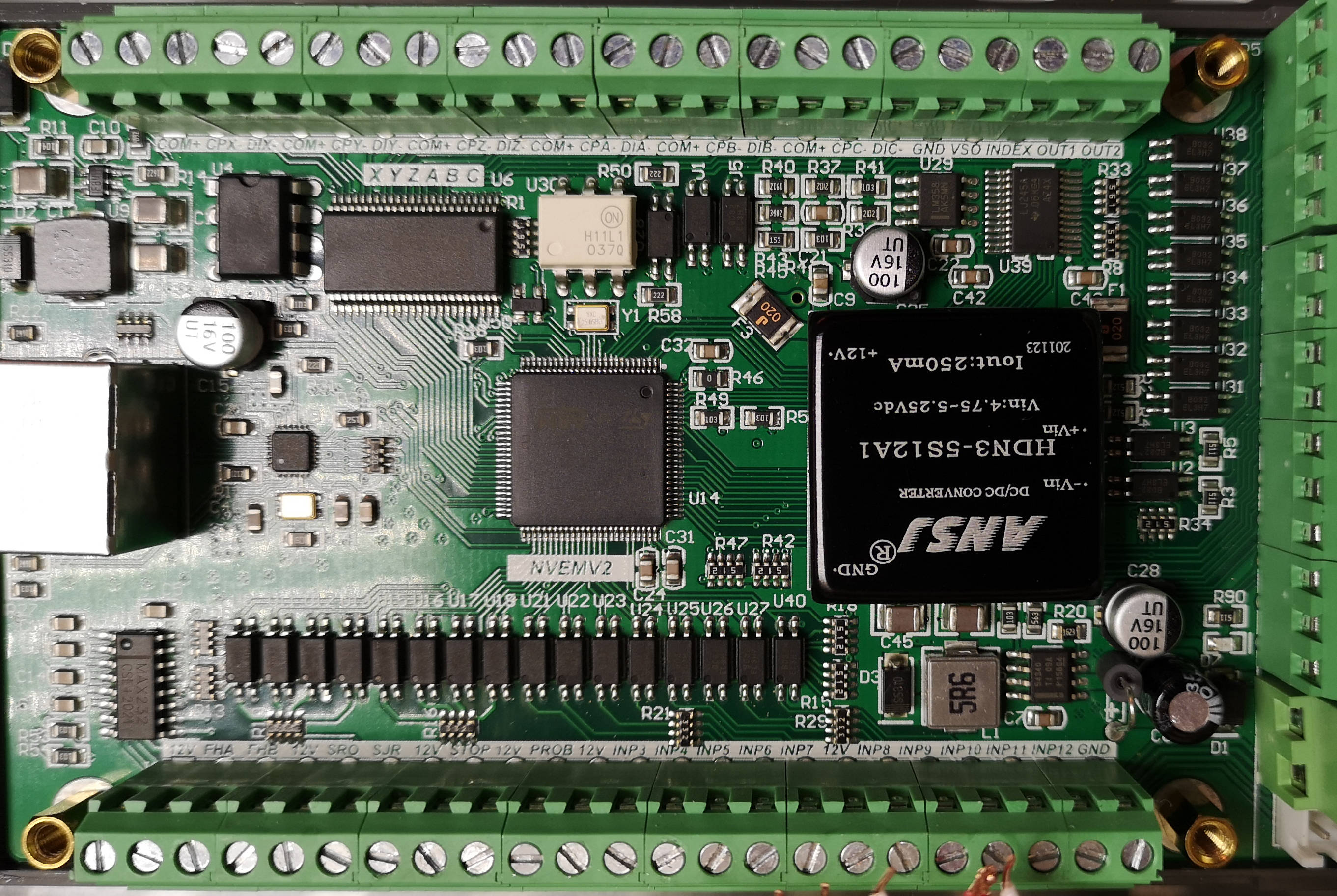

- Posts: 21958
- Thank you received: 7478
10 Feb 2023 22:38 #264259
Replied by tommylight on topic Remora - ethernet NVEM / EC300 / EC500 cnc board
STM32F207, that is the micro controller, so probably should use the firmware for it.
Also might want to wait for the more experienced members to reply as i had no time to play with Remora, yet.

11 Feb 2023 06:17 #264272
by dec0077
Replied by dec0077 on topic Remora - ethernet NVEM / EC300 / EC500 cnc board
What kind of frequency are we talking about here? Because if it is between 1 and 3 KHz I could try to intercept the PWM signal before the op-amp and send it to something like this:
www.amazon.it/stronerliou-Signal-Voltage...+%2Caps%2C96&sr=8-23
(of course I would have to know where on the board to attach a lead... I'm guessing to one of the inputs of the LM358?)
Thank you
Thank you
Here are the pictures of my board, I hope they can give all the info needed.
Yes, an earlier version which uses an op amp circuit to convert the PWM into analogue. The PWM frequency used to drive the PWM to analogue chip on the new boards is quite slow. Maybe a higher frequency is need.
