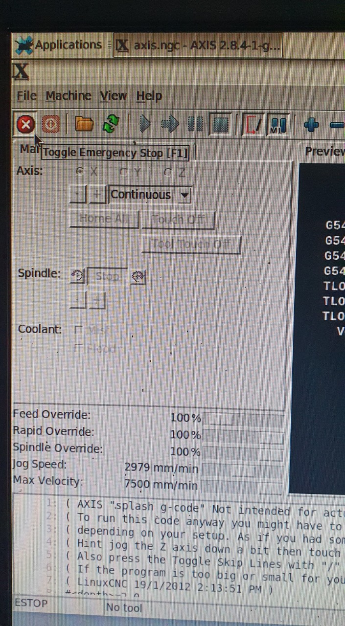

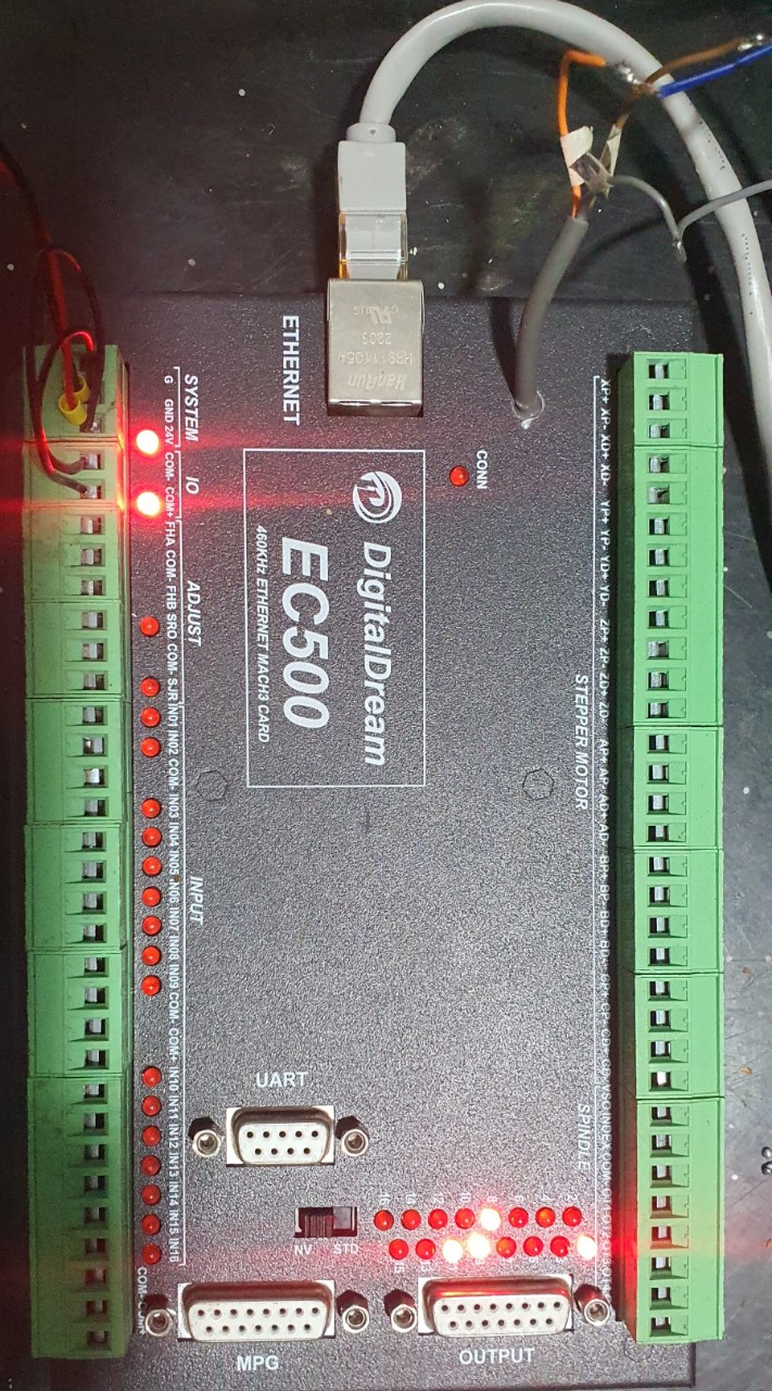

I am trying to play with LinuxCNC on my EC500, but not success. I follow these steps:
1. Flash Firmware with Pyocd=> Successed
2. Install the lastest LinuxCNC on my PC, then do halcompile the "remora-nv.c" => OK

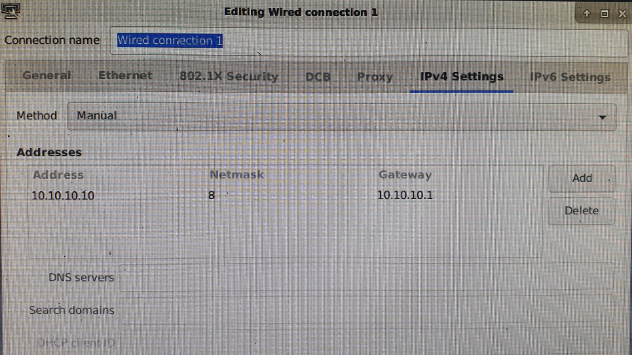

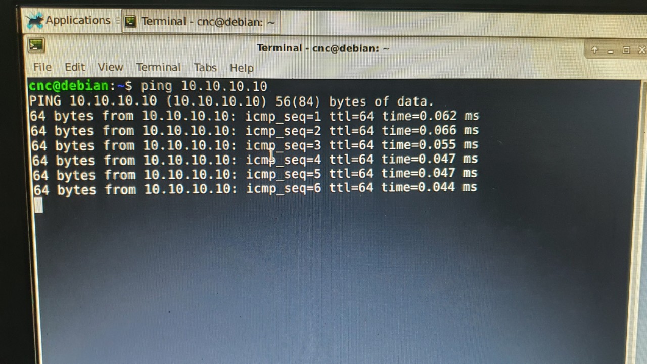

3. Set the PC ip to: 10.10.10.10, netmask set to 8, Gateway set to 10.10.10.1 then try to ping IP with good respond.
4. Copy the basic config from Scotta to Linux config folder.
5. Run LinuxCNC fine !
==> But no lucky that the LinuxCNC always at ESTOP state so I cant do anything with it. Try to use NO switch as Emergency button, connect one wire to COM- Pin, another wire to IN02 then test for sure but nothing.
I go through page to page to find out anyone have the same problem but till no luck, as Scotta said seem my board have not successfully connected to PC.
Please help me how to check where the problem come from, correct me if I wrong, Thank all guy.

10.10.10.10 is the ip address hardcoded in the firmware, you should set the ip address of your pc on the same subnet but with a different ip, i.e. 10.10.10.2. If I'm not mistaken, the netmask is /24 instead of /8; you don't need to set a gateway.
As things are now, at best you are pinging yourself on the pc network interface instead of the ec500 card, at worst there is an ip conflict on the subnet: it's not surprising LinuxCNC does not want to come out of the estop state as it's not really communicating with the card.

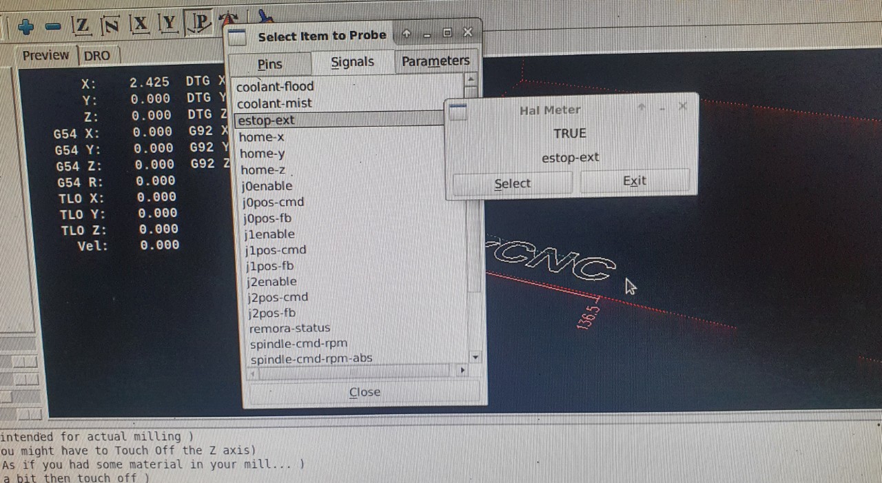

Thanks for reply! That my fault, re config IP as you said then problem solve. But something weird with my config that extend estop button not working (LinuxCNC not jump to Estop state when triggered). I do check the Hal status and it show True and False value when extend estop is triggered/ untriggered (picture attached), so Linuxcnc knows the signal but not respond to it.
