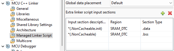

21 Jun 2023 04:57 #273979
by scotta
Some good news. I think I've finally solved the Ethernet issues with my C++ attempts. The issue was related to the caching of the Ethernet buffers. When I converted the C code in MCUXpresso, the following additional linker script settings did not flow over to the C++ Linker settings. Definitely a trap and something I hope others can learn from my mistake.
I've started a new repo for the development of the C++ version for the RT1052, which all going well will have the all the same dynamic configuration capabilities as the original STM32 version for the NVEM / EC300 / EC500.
github.com/scottalford75/Remora-RT1052-cpp
