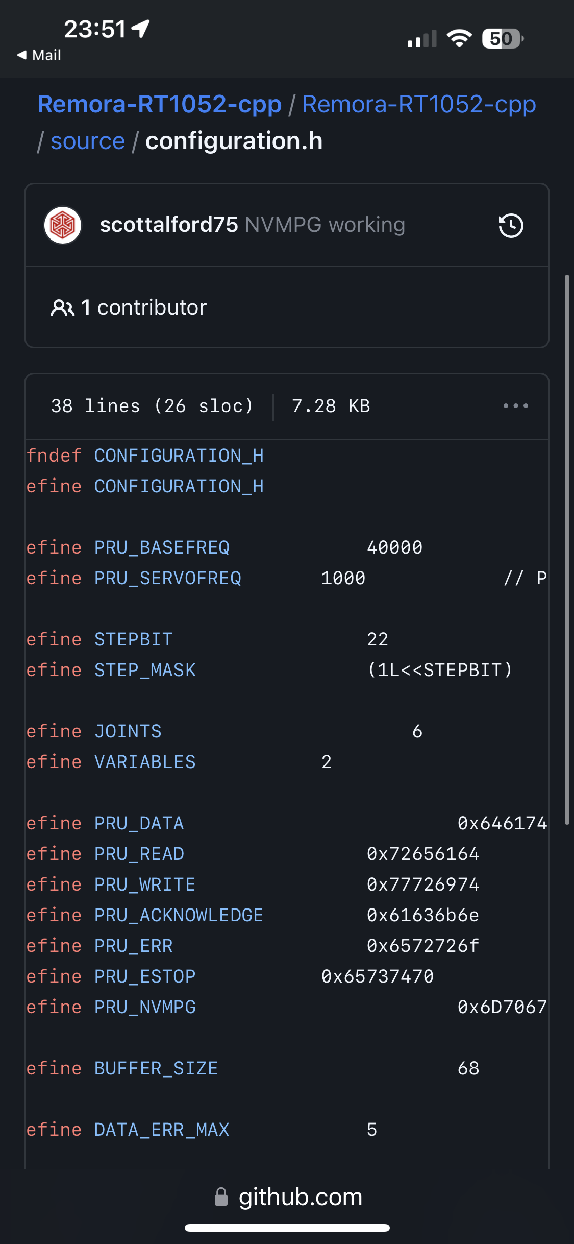

Hey tux, the project is still in early stages, so there is not much in the way of example configurations or documents related to the NVEM portion of the project. The NVEM part of the project is not OEM, but an aftermarket firmware. In these early stages the project, it is not for beginners. This fact is reflected by lack of documents. If you wish to use the project in its early stages, you will need to either make an attempt to read/understand the code, wait patiently for beginner documents, or politely ask for help from other users.
Is the ec500 using the rt1052?
Is stepgen happening in in one base thread or 2 with this version? It looks like the newer ones are 1 base thread interval but Im not sure with theses new ones.
Thanks Scott, it seems to work excellent.
Is there anything particular you’d like me to test?
What is the max step rate EC500 with remora fw can do?
Original firmware for mach3 states 460kHz, but if I recall correctly, with remora firmware it’s different. Dependant on some hardcoded value in firmware.
Im asking because I have set 1000 steps per mm (0.001mm step resolution) and at 40mm/s = 40kHz it’s OK, but at 50mm/s I already get following error.

04 Jul 2023 21:53 #274794
by zmrdko
Replied by zmrdko on topic Remora - ethernet NVEM / EC300 / EC500 cnc board
I have no idea. This is probably question for @scotta.
but here is a screenshot from config file from rt1052 firmware github:
PRU_BASEFREQ = 40000

04 Jul 2023 22:20 #274797
by scotta
The firmware base thread is 40khz so that's why you are getting following errors. The advantage of the latest firmware is the ability to modify the thread frequency!
Just tested at 80khz, failed at 120 kHz.
In your configuration.txt file add the Thread section:
And then in your hal file add the PRU_base_freq
Getting higher step rates will need the DMA stepgen work ported over to the RT1052, which with the faster processor hopefully allows the DDS calculations to be completed within the servo period. The reason why work was stopped on the STM32.
Super!Thanks Scott, it seems to work excellent.
"Board": "EC500",
"Threads":[
"Thread": "Base",
"Frequency": 80000
"Modules":[
{And then in your hal file add the PRU_base_freq
# load the Remora real-time component
loadrt remora-nv PRU_base_freq=80000Getting higher step rates will need the DMA stepgen work ported over to the RT1052, which with the faster processor hopefully allows the DDS calculations to be completed within the servo period. The reason why work was stopped on the STM32.
