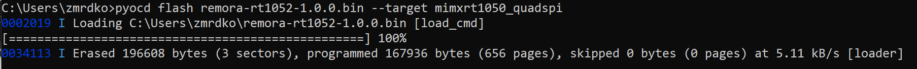

I'm back from mach4 after a while.
I have just flashed new firmware and inputs and outputs seems to stop working on my recent settings.
And also some outputs seems to be on: 5, 7, 12, 14, 16 on startup.
And changing output states in Halshow (Pins->remora->output) does not really change output state.
What did I miss?
I tried default config (github.com/scottalford75/Remora-RT1052-c.../remora-rt1052-basic) and it's the same.
What did I miss?
