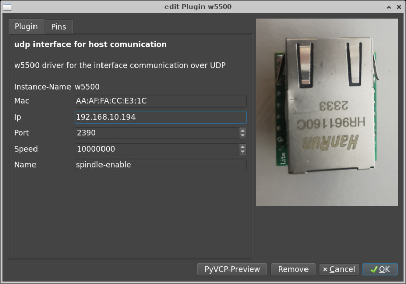

No exaggeration. It is what it is. In fact it works so well it's creating a huge dilemma for myself at this point. The end goal is about to shift from having a simple dumb 3axis/3switches co2 laser retrofit, extended to having my parport milling machine reworked entirely also. It's getting even more confusing as I trial the plugins you've written. (addictive).
How did you get the w5500 spi speed field turned on? So much injustice going on. I see I see.

spi speed field is new and maybe i have not pushed it yet to github.
i have done also some critical changes and have to test it all before i set it live

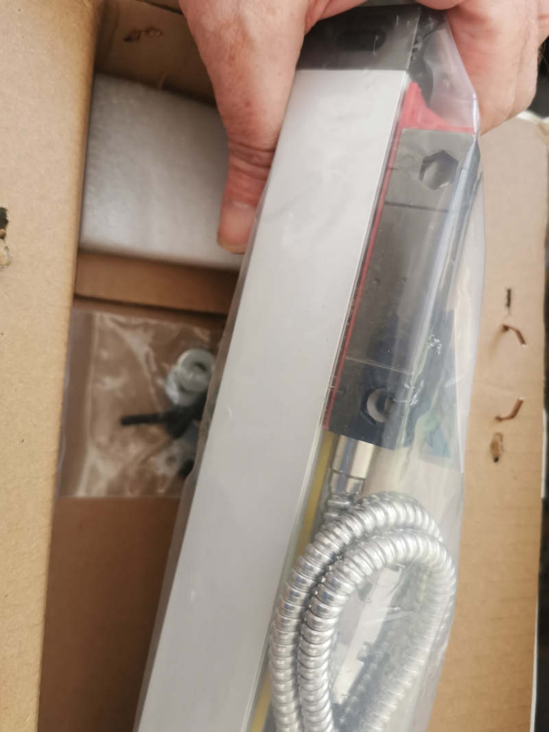

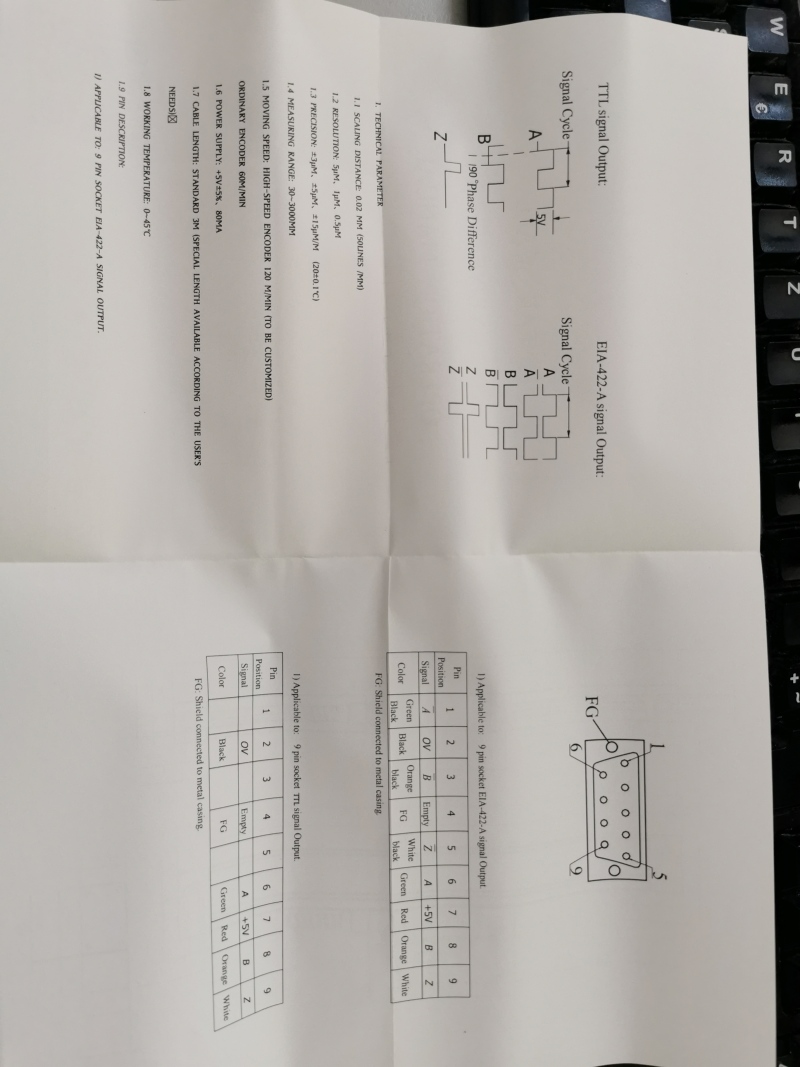

new toy
www.amazon.de/dp/B07SSL1G18?psc=1&ref=pp...dt_b_product_details
works like a rotary-encoder, i think it should work in RIO
