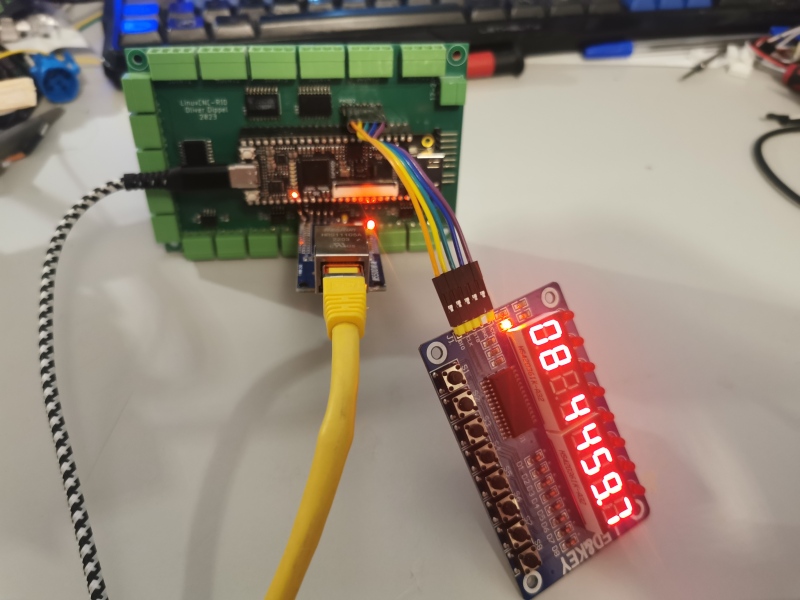

my professional test setup
why didn't I try this before
i am sooo stupid, well, at least i realized it at some point
now i can also increase the SPI speed and in python the looptime dropped from ~0.88ms to 0.42ms
the problem was, when checking whether a new packet was received, the size was also read out, if this check happened exactly during the transmission and the packet was not yet 100% there, the size was not correct and the check failed
a second before i wanted to send this message, there was a timeout, but ok, this is running over my home network, so it can happen, but it has become extremely good now, i have to let it run isolated for a while.
thank you all, if i hadn't kept asking, i would probably have resigned myself to the esp32 solution
tx (280): [116, 105, 114, 119, 0, 0, 0, 0, 0, 0, 0, 0, 0, 0, 0, 0, 0, 0, 0, 0, 0, 0, 0, 0, 0, 0, 0, 0, 70, 5, 0, 0, 0, 0, 0]
rx: [97, 116, 97, 100, 151, 2, 0, 0, 0, 0, 0, 0, 31, 202, 0, 0, 0, 0, 0, 0, 0, 0, 0, 0, 0, 0, 0, 0, 0, 0, 0, 0, 0, 0, 0]
0.8819103240966797tx (280): [116, 105, 114, 119, 0, 0, 0, 1, 0, 0, 0, 0, 0, 0, 0, 0, 0, 0, 0, 0, 0, 0, 0, 0, 0, 0, 0, 0, 70, 5, 0, 0, 0, 0, 0]
rx: [97, 116, 97, 100, 0, 0, 0, 0, 0, 0, 0, 0, 0, 0, 0, 0, 0, 0, 0, 0, 0, 0, 0, 0, 0, 0, 0, 0, 0, 0, 0, 0, 0, 0, 0]
0.4222393035888672the problem was, when checking whether a new packet was received, the size was also read out, if this check happened exactly during the transmission and the packet was not yet 100% there, the size was not correct and the check failed

03 Aug 2024 02:50 #306822
Replied by Cant do this anymore bye all on topic LinuxCNC-RIO - RealtimeIO for LinuxCNC based on FPGA (ICE40 / ECP5)
docs.wiznet.io/Product/iEthernet/W5500/A...tion/spi-performance
If you have a look at the figures on the wiz net wiki you’ll see as packet size drops so does the overall throughput.
All I could find is the implementation and proposed data integrity stuff. I know you're past your daylight but when you have a chance tomorrow, see if you can find that bit of info you ref'ed and we'll talk to their engineer about it. See if we can flip a Magic Register to disable that supposedly/suspected throttling thingy...
Impl. Ref: docs.wiznet.io/Product/iEthernet/W5500/Application/udp
