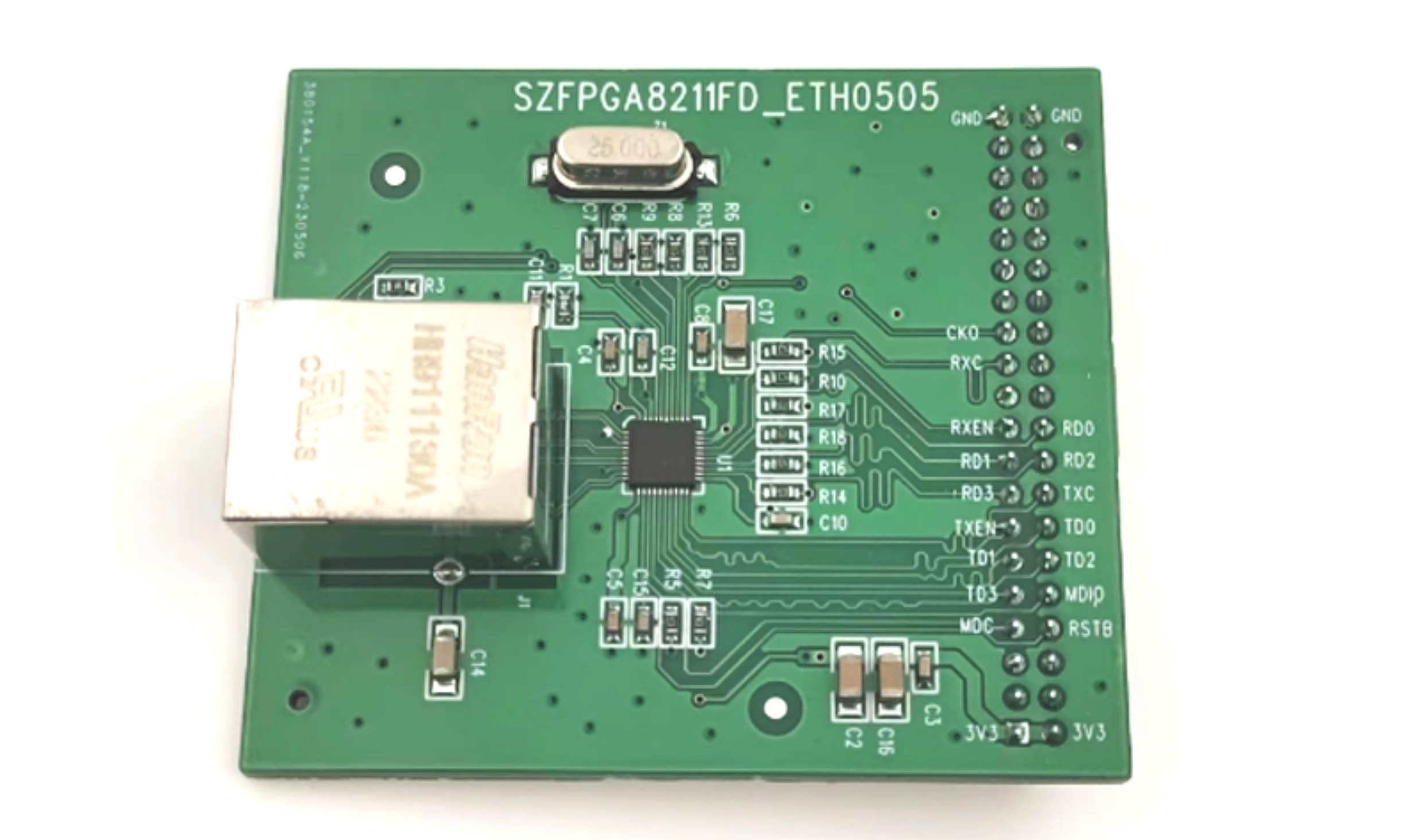

I'll schematic the rtl8211 silicon and passives for you, pass on BOM, and contribute a 100/1000 verilog for RIO tests soon.
Replied by Mecanix on topic LinuxCNC-RIO - RealtimeIO for LinuxCNC based on FPGA (ICE40 / ECP5)
Snap, that can't be good. Wonder if the socket got opened correctly... need a look at. More and more I think about it though, let's just 'fuck it' (pardon!) and go full 1000 gaga-bit phy/mac from the ground up. Placed my original idea/proposition on order, should get in here in about 72hrs.I did a test with the new w5500.v, initialization of the IP seems to work, I can ping.
but port 2390 is not openso I can't communicate with it either

@meister
A 1000 meg base ethernet/phy onto "rgmii_txc & rgmii_rxc" buffers. Have a look and let us know if RIO can deal these two buffers.
Let's get this lag over with and league up a notch!
Synthesized, Placed and Routed Code in hands. If interested, DM an address I can send bitstream source too [16mb].
RTL8211FD Schematic attached (pdf). Same real-estate as the wizzy part, 10x performance increase though.

ps. yes gigabit phy. Correct. If you need the bitstream, shoot an addy I can email -or- a drag & drop box.
I'll standby. That's awesome news to hear, I know you'll figure it out with time. Oh man!!at the moment, i try to debug a little bit the old w5500 driver and found out that it do not receive the last package
