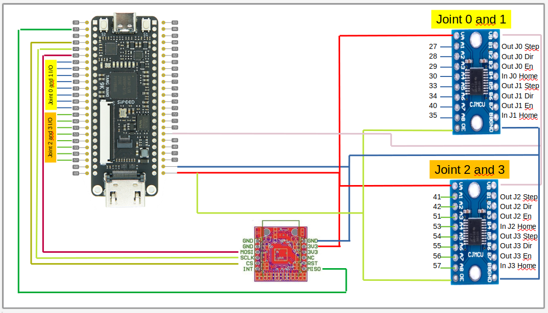

I noticed that the one of my outputs is not always switching. It's tied to the "machine on" but when I toggle the machine on an off, sometimes it's not reacting. I also get some error messages in the Terminal.
This is my current wiring.
What error messages? I had to tune FERROR and MIN_FERROR a bit for my setup to solve some following errors.

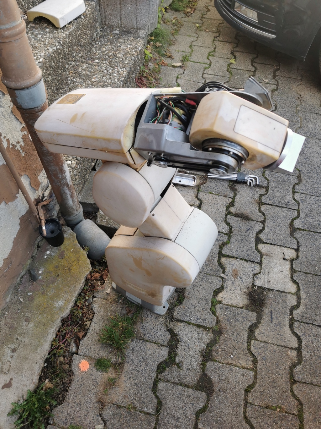

I approve of this excuse!if i have overlooked any open questions, please ask again, i was a bit busy at the weekend and lost the thread
here is my excuse:mitsubishi rv-e2
without controller and one harmonic drive is broken
Quick question about the iceshield config:
Should the pi be emitting 18mHz, rather than 5mhz via pin 7 instead, since the oscillator is configured as 18mhz on pin 35 on the up5k? I wonder if this is the source of my following error at higher speeds?

Good idea, I tried setting the feedrate low, but no difference.
Then I measured with my oscilloscope. The Tang outputs all work as intended. Direction, Enable and Step. Focusing on Step the signal looked really good no matter what feedrate. However, the issue is the logic converter. I am using the Texas Instruments TX0108E. www.ti.com/lit/ds/symlink/txs0108e.pdf?ts=1730734048833 But the step output signal is only 0-2.5V and not the intended 0-5V. Sometimes the output goes up to 5V, but not very often. The enable and direction pin are a bit more reliable but even they are not always 0 or 5V and are sometimes in between. I thought I made something wrong or the level shifter are damaged, but found this video. The issues he has are very similar to mine and even all the comments under the video don't give an solution.
Anyone an idea how to get the TX0108E working correctly ??
I ordered last time some of those as well, the order is supposed to be here this week. I have 1x 3.3V to 5V and 2x 3.3V to 12V in the order. I wonder if i can use the 3.3V to 12V with just 5V for the stepper driver www.aliexpress.us/item/3256803586254541.html

05 Nov 2024 12:19 #313809
Replied by tommylight on topic LinuxCNC-RIO - RealtimeIO for LinuxCNC based on FPGA (ICE40 / ECP5)
Just a stab in the dark, but does the TX0108E have capacitors wired to power lines and close to the chip?
A 10 microFarad electrolytic and a 0.1 micro ceramic should do.

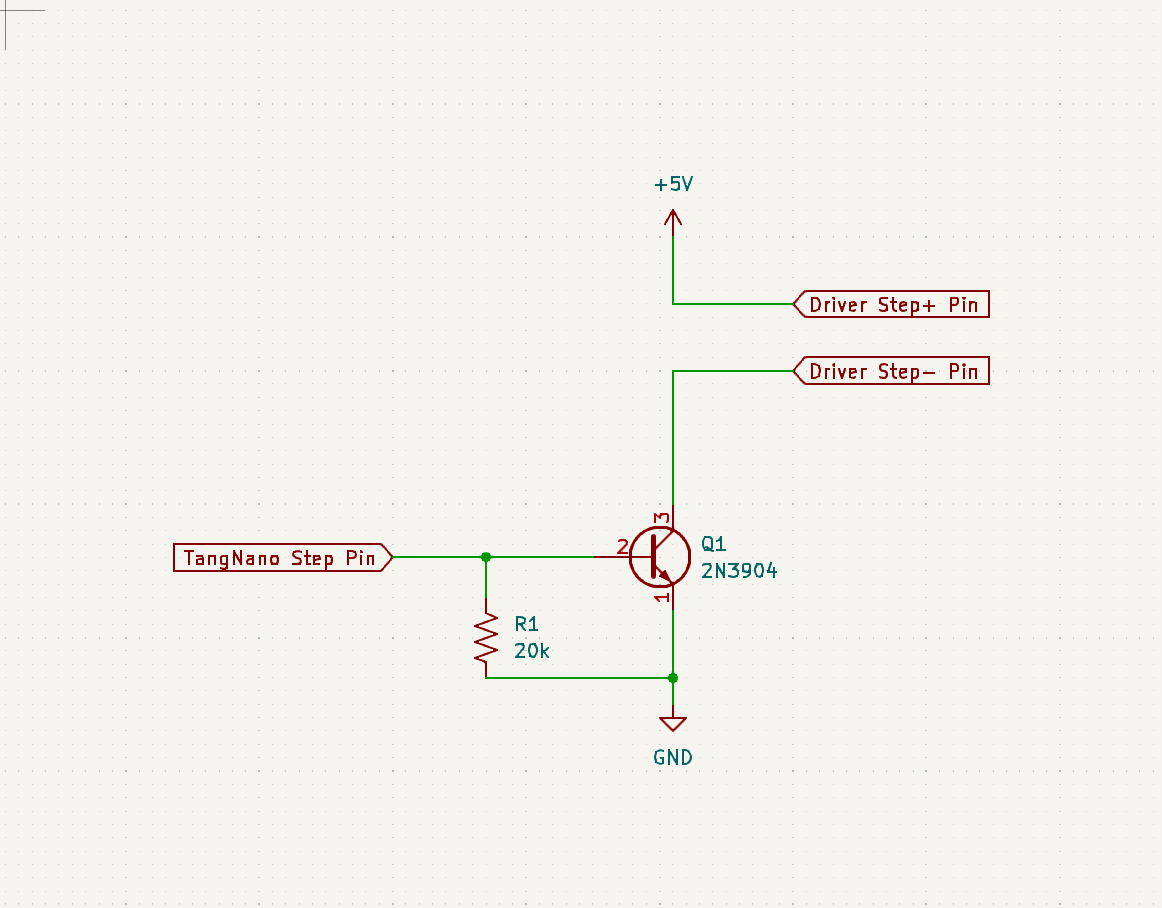

I wonder if you're running into voltage drop on the TX0108E if you're switching the high side? I also wonder if the Tang Nano can't push enough current on the 5v rail for your application, maybe provide an external 5v source to VB? Perhaps monitor VB with the scope as well, see how stable that is?
Replied by digiex_chris on topic LinuxCNC-RIO - RealtimeIO for LinuxCNC based on FPGA (ICE40 / ECP5)
I'm not as familiar with the TX0108E , but another option is to switch the low side instead of the high side. Such as a simple transistor between the - of the driver and GND, if that's an option for your stepper driver. (See image).Just a stab in the dark, but does the TX0108E have capacitors wired to power lines and close to the chip?

05 Nov 2024 16:17 #313823
by mBender
The power supply from the Tang is stable. I had that suspicion too and tested it with my oscilloscope. 5V is clean and no power drop.
What I have found out is that the bidirectional level shifter have some weird logic to figure out which side is driving and it seems they create often problems. I even tried to put the output side with a pull up / pull down. No difference.
I think something like a 74ACT245 where you can external control the direction might be better for this application.
Replied by mBender on topic LinuxCNC-RIO - RealtimeIO for LinuxCNC based on FPGA (ICE40 / ECP5)
I thought about the Transistor solution as well. I have actually some transistors laying around, but the fact that the new level shifter should arrive any minute has me stopped that. At least for the moment.

05 Nov 2024 16:32 #313826
by meister
On the Tangbob board I use the TXS0108EPW with pull up/down resistors on the input side.
However, to switch optocouplers in the output stages, for example, you still need a driver like the ones installed on the BOB boards (uln2308), the level shifters are not designed for this
Replied by meister on topic LinuxCNC-RIO - RealtimeIO for LinuxCNC based on FPGA (ICE40 / ECP5)
