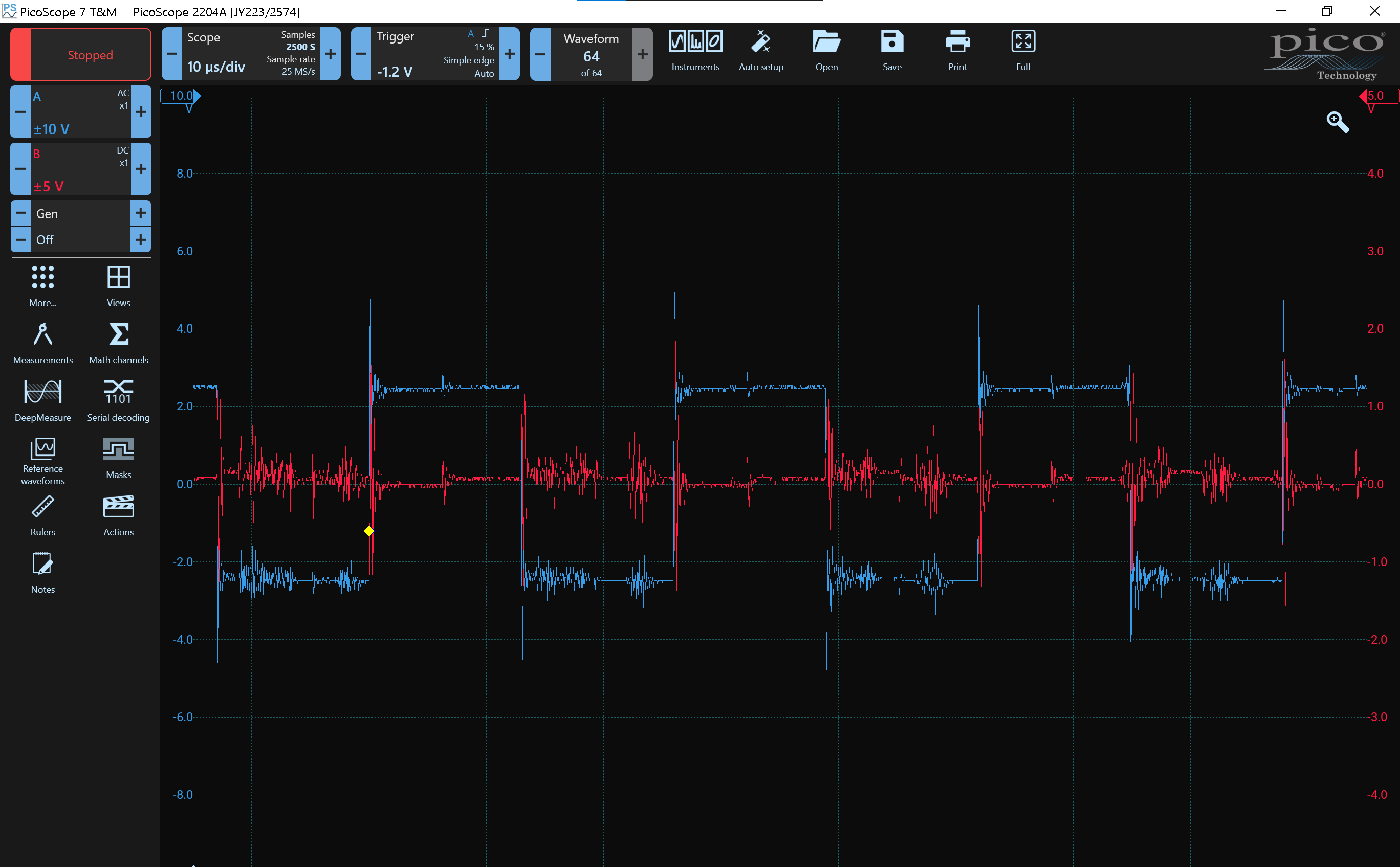

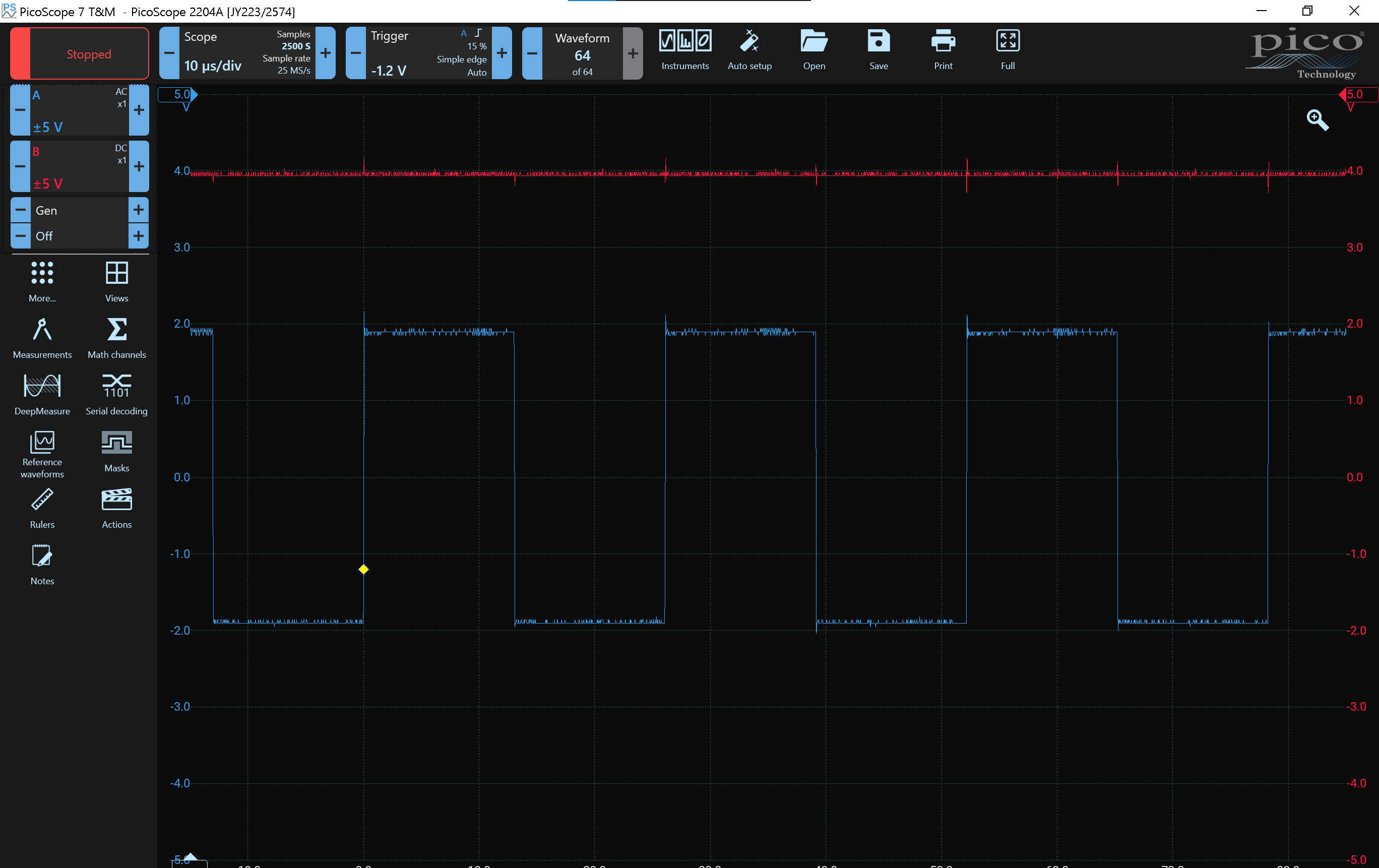

I changed motors, drives, wires and pins and the stalling still happens. Then I thought measuring Direction and Step at the same time. And I believe I found the error. I measured the output of the Tang which is almost perfect. A tiny bit of noise, but really not a lot. When I measure Step and Dir at the drives Dir has a lot noise! See pictures below. I have the step and dir per motor in a single 2 conductor cable. I changed that and put the 2x dir in one cable and the left the step each in a separate cable. No change. I think I have so much noise that the driver probably thinks to change direction.
Anyone an idea how to reduce the noise? Channel B (red) is direction.

I finally gave up. I have spend hours and hours trying to find out why my motor stall. I even contacted the manufacture of the drives and motors with no success. I replaced all wires,motors, drives, added ferrite cores,.... There is almost nothing I have not tested.
I am convinced it has nothing to do with the Rio software. But the tang vs parallel port makes the difference. The signal after the BOB comes out with less noise when I run it from the parallel port as when I have the tang connected. I don't know why and I don't know why my DM332T don't make an issue either way, but the Microkinetics does.
