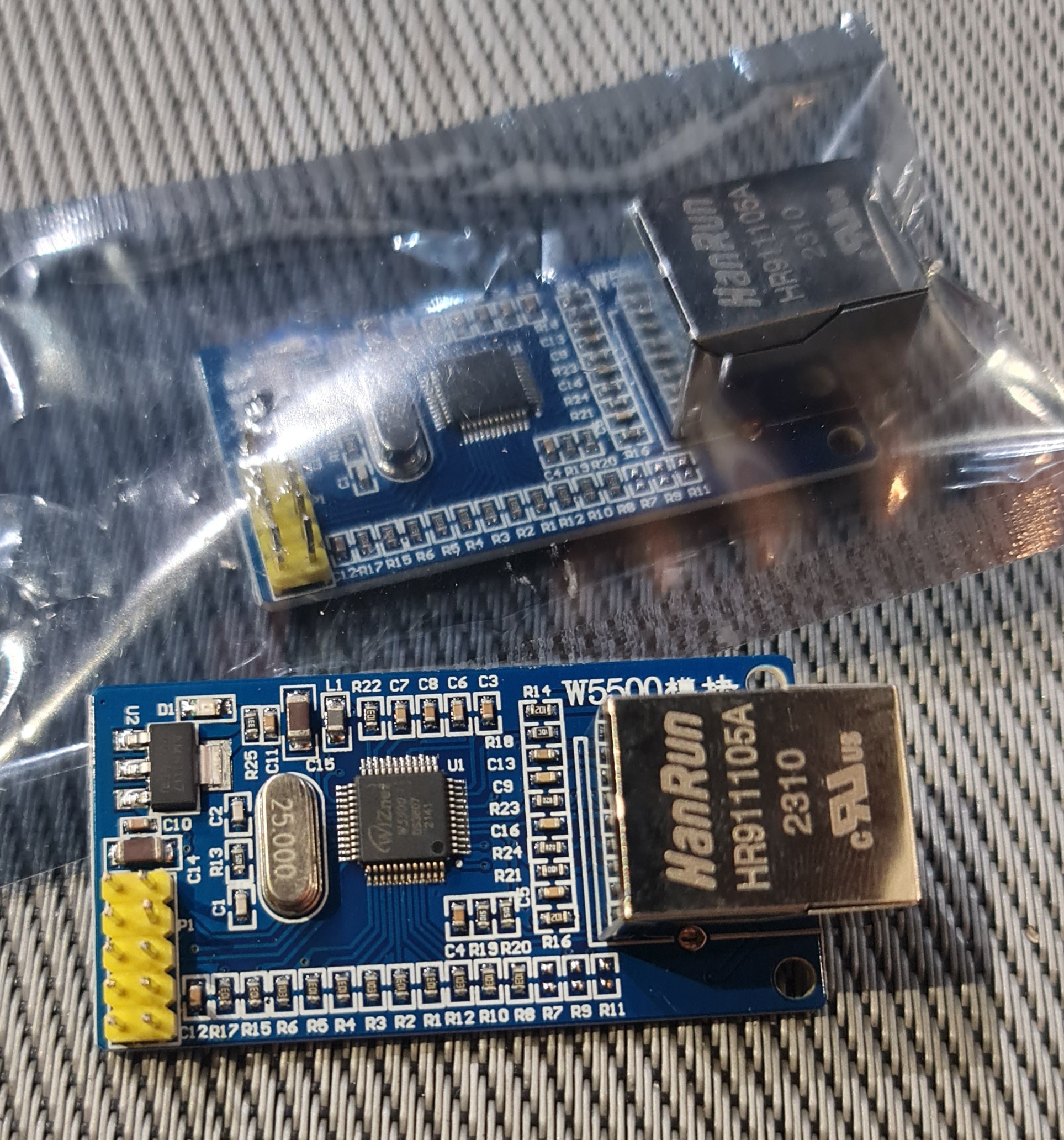

Replied by tommylight on topic ESP32/S2/S3 LinuxCNC Controller (6 axis hardware step gen), USB plug-and-play
@Wez,
How the hell did you cram all that stuff into an ESP32?
Hal2UDP version works, your version is refusing to work on a Wroom module, no network, and ipconfig will reset it.
The rest seems ok, can set motors, enable wifi, etc.
Will report back later if i manage to find the culprit.
It is the "doit" version with strange pinout so had always issues with it, will also try another board

01 Nov 2024 03:29 - 01 Nov 2024 03:33 #313587
by michaeln
Replied by michaeln on topic ESP32/S2/S3 LinuxCNC Controller (6 axis hardware step gen), USB plug-and-play
@tommylight
i had the same way and problems.
It is a pity that wez apparently no longer works on this project and finish it. But he made a good job. Thanks to him.
Hal2UDP is plug and play.
But this is not so easy to get it working.
For me first i need a lot of time to see what is future and what is working with this code.
Please have a look to the for from SybexX: github.com/SybexX/ESP32_LinuxCNC_MotionController_RealTime
He fixed the Linux compile errors and added the ESP32_WROOM_DEV board.
What is not working for me, is it the configuration for the spi-ethernet. First i want to change the configuration for the Hal2UDP wiring, but it is not working and seems there is a bug. You have to change the wiring to the default and it should work.

- Posts: 22048
- Thank you received: 7506
01 Nov 2024 04:10 #313591
If you get an error compiling the LinuxCNC component, rename the containing folder and remove empty spaces in the name.
You will also get an error when compiling for ESP as there is something with 2 letters in upper case but the other file has it in lower case, forgot what file and where.
Use serial monitor and

01 Nov 2024 05:09 - 01 Nov 2024 05:27 #313596
by michaeln
Does the spiethconfig work for anybody?
I tested a lot, but i don't find the problem.
I insert printf commands in the code and get strange outputs. I change from picocom to putty, the same.
The command in short and long version:
spiethconfig -s 19 -i 23 -c 18 -e 0 -t 4
spiethconfig --miso 19 --mosi 23 --sck 18 --csenable 0 --interrupt 4
The output:
Invalid or missing Chip Select pin (0>128)
Command returned non-zero error code: 0x1 (ERROR)
I insert some printf-commands ( bold my changes):
printf("argc: %d\r\n", argc);
if (result.count("s")) { miso_pin = result["s"].as<int>;(); }
printf("MISO pin: %d \r\n", miso_pin);
if (miso_pin < 0 || miso_pin > 128 ) { printf_P(PSTR("Invalid or missing MISO pin (0>128)\n")); return EXIT_FAILURE;}
if (result.count("i")) { mosi_pin = result["i"].as<int>;(); }
printf("MOSI pin: %d \r\n", mosi_pin);
if (mosi_pin < 0 || mosi_pin > 128 ) { printf_P(PSTR("Invalid or missing MOSI pin (0>128)\n")); return EXIT_FAILURE;}
if (result.count("c")) { sck_pin = result["c"].as<int>;(); }
printf("SCK pin: %d \r\n", sck_pin);
if (sck_pin < 0 || sck_pin > 128 ) { printf_P(PSTR("Invalid or missing SCK pin (0>128)\n")); return EXIT_FAILURE;}
if (result.count("e")) { cs_pin = result["e"].as<int>;(); }
printf("CS pin: %d \r\n", cs_pin);
if (cs_pin < 0 || cs_pin > 128 ) { printf_P(PSTR("Invalid or missing Chip Select pin (0>128)\n")); return EXIT_FAILURE;}
if (result.count("t")) { int_pin = result["t"].as<int>;(); }
printf("INT pin: %d \r\n", int_pin);
if (int_pin < 0 || int_pin > 128 ) { printf_P(PSTR("Invalid or missing Interrupt pin (0>128)\n")); return EXIT_FAILURE;}
and get the result:
argc: 7
MISO pin: 19
MOSI pin: 23
SCK pin: 18
CS pin: 255
After that i change the sequence of the variables, the problems stay at the forth position. i saw that the out from argc stay at maximum 7 (in my opinion it should be 11).
Does it work for anybody?
If yes, what does is made wrong?
Thanks and best regards
michaeln

- Posts: 22048
28 Nov 2024 20:41 #315506
Had the same issue, so it was easier to resolder the pins, but still did not work.
Had no time to test anymore, it is sitting on my desk here for quite some time, but i think i might give it a go these days.
Did you get any further?

- Posts: 22048
29 Nov 2024 09:11 #315554
No worries, using this for experimenting only, for anything and everything i use Mesa, just had some ESP32 around from messing with drones.
I did test with hal2udp though for over a day and did not notice any issues, but that is much simpler than this. And it uses a base period for software stepping.
Whenever i get a chance i will be testing this on a production plasma machine, just to see if the antena RX/TX survive the HF/HV pilot arc from plasma.
I hope i do not forget to make videos, i always forget to make videos...
Wez did a magnificent job for sure, i ordered some ESP32 S3 yesterday just because of this, he deserves a lot of respect for cramming all that stuff into a micro controller. And so do the makers of Marlin.
I wonder if Wez is OK...
