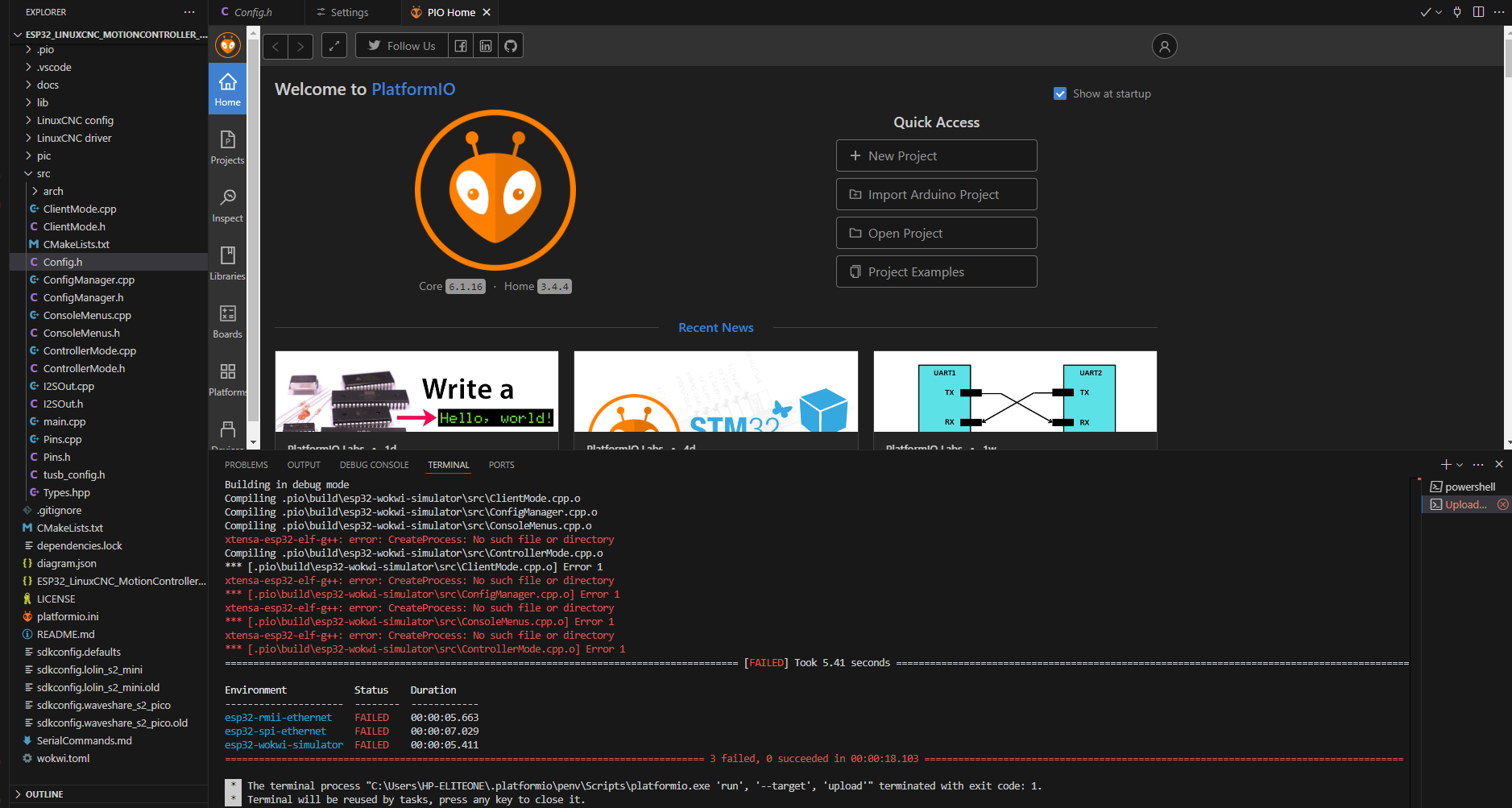

have problem install with platformio the message is :

src/Config.h:11:12: fatal error: Eth.h: No such file or directory

========================================== [FAILED] Took 2.89 seconds ==========================================
Environment Status Duration
esp32-rmii-ethernet FAILED 00:00:02.890
===================================== 1 failed, 0 succeeded in 00:00:02.890 =====================================
* The terminal process "platformio 'run', '--environment', 'esp32-rmii-ethernet'" terminated with exit code: 1.
* Terminal will be reused by tasks, press any key to close it.
i searching eth.h file but does not found any

22 Dec 2024 09:43 #317144
by michaeln
Replied by michaeln on topic ESP32/S2/S3 LinuxCNC Controller (6 axis hardware step gen), USB plug-and-play
Please test this fork:
github.com/SybexX/ESP32_LinuxCNC_MotionController_RealTime
SybexX corrected a few typing errors

22 Dec 2024 13:41 #317155
Replied by tommylight on topic ESP32/S2/S3 LinuxCNC Controller (6 axis hardware step gen), USB plug-and-play
#include "Eth.h"
That is Wez's version, somewhere in the files it says the above but the file in question is named eth.h , notice the lower case, edit the src/Config.h with the lover case eth.h, it works then.
Let us know if the Wez's version works for you, it did not work for me, namely the networking on the W5500 does not work, to test in the console type ipconfig, if it reboots, well....
The version Michael linked does work right up until you enable LinuxCNC, then it keeps rebooting for me.

thanks worked for sybexx... not use from wezzhunter file since sybexx file succes thanks for all guide, now next problem i cant isntall udp driver from linux terminal they says :

check your config.h file.. some case have to change Eth.h with ETH.h , have full message from platformio?
