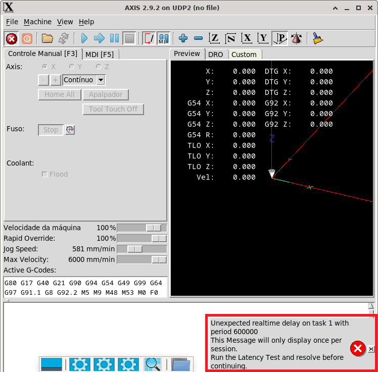

- aparecido
- Posts: 100
- Thank you received: 6
15 Dec 2024 07:17 - 15 Dec 2024 07:18 #316704
by aparecido
Replied by aparecido on topic ESP32/S2/S3 LinuxCNC Controller (6 axis hardware step gen), USB plug-and-play
Has this error message appeared for anyone?
If so, how did you resolve it?
Can you tell me why it appeared?
Last edit: 15 Dec 2024 07:18 by aparecido.
