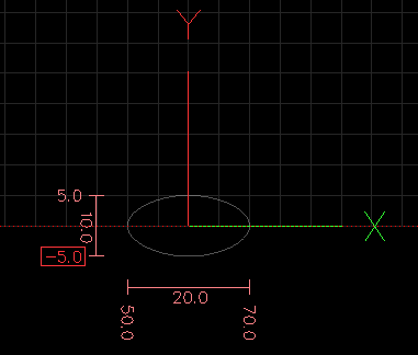

Finally I can show some G5 code that actually runs in linuxCNC. Against my previous posts, the parameters I,J,P, Q are indeed given relatively to the start and end points. This should give a circle of Radius 10 mm:and this an ellipse of size 20x10 mm:
Details on github with some reorganization of the files.
github.com/Matttab/spline-examples/tree/main/linuxCNCsplineTest
G0 X10 G5 X0.000 Y10.000 I0.000 J5.200 P5.200 Q0.000
G5 X-10.000 Y0.000 I-5.200 J0.000 P0.000 Q5.200
G5 X0.000 Y-10.000 I0.000 J-5.200 P-5.200 Q0.000
G5 X10.000 Y0.000 I5.200 J0.000 P0.000 Q-5.200G0 X10 G5 X0.000 Y5.000 I0.000 J2.600 P5.200 Q0.000
G5 X-10.000 Y0.000 I-5.200 J0.000 P0.000 Q2.600
G5 X0.000 Y-5.000 I0.000 J-2.600 P-5.200 Q0.000
G5 X10.000 Y0.000 I5.200 J0.000 P0.000 Q-2.600Details on github with some reorganization of the files.

In axis you can go to File and next Proprieties (or gcode proprieties, can't remember the correct name ) and you can see the respective length of the Spline(s).
This value can be compared if matches the length of the Spline on CAD program. Its a quick way to confirm is its correct.
