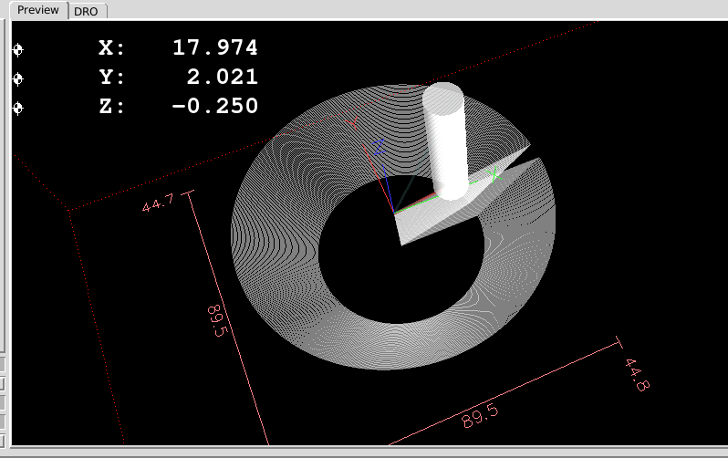

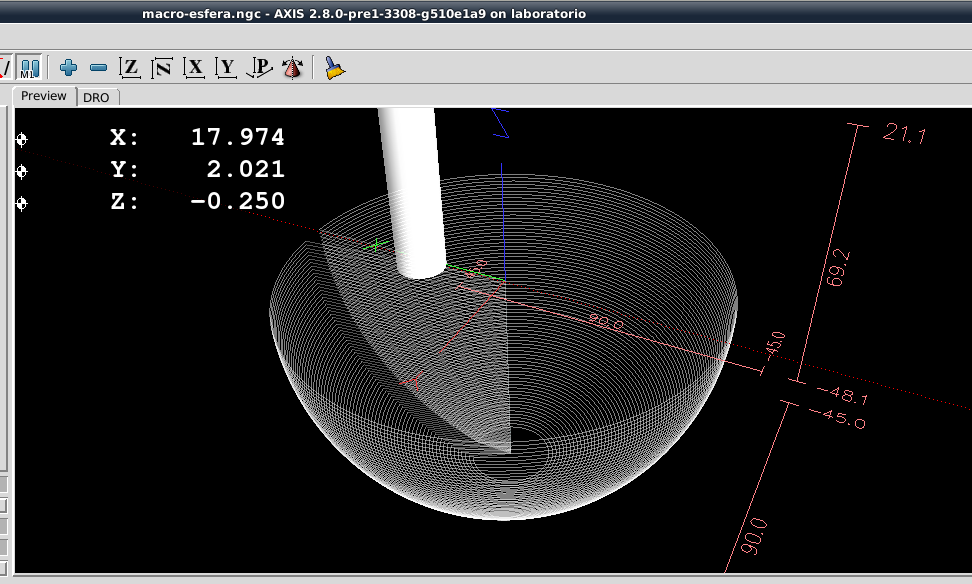

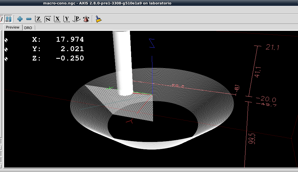

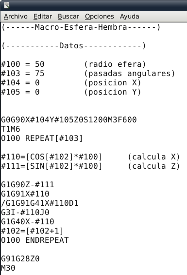

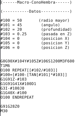

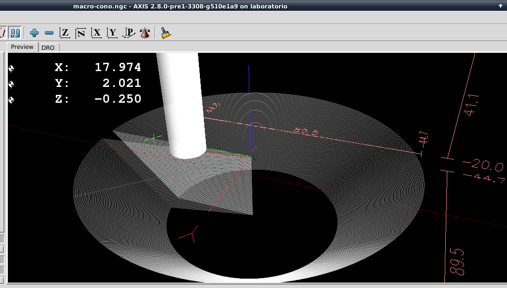

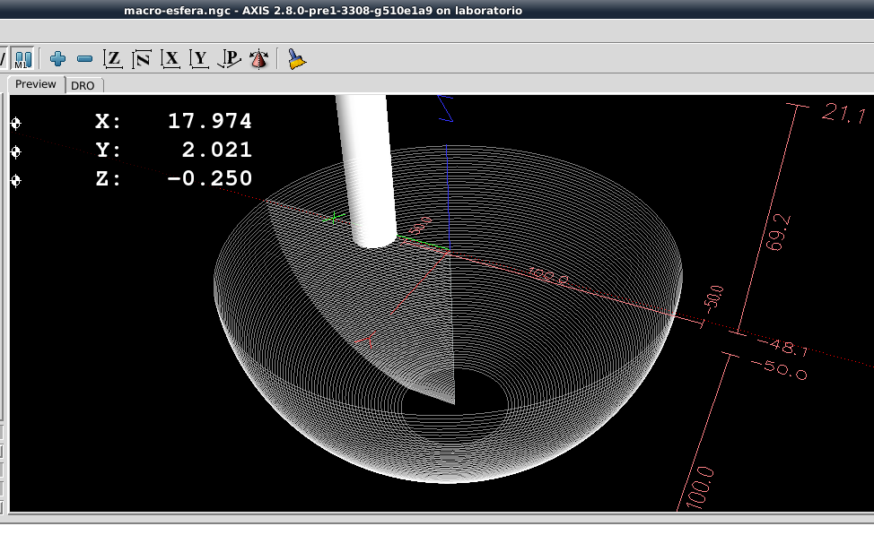

In order to be able to visualize the erroneous way in which linuxcnc generates an input path, I leave a basic example of parametric programming so that it can be understood how complex and unnecessary it can be to perform auxiliary input motions. My intention is that this conceptual error be corrected by linuxcnc developers.

Adding one line of g-code to your program will make it run the way you wished it to. It's only a work-around, but it will get you where you want to go.
#100=50
#101=45
#102=20
#103=0.25
#104=0
#105=0
#106=0
G0G90X#104Y#105Z#106S1200M3F600
T1M6
o100 REPEAT [[#102/#103]]
#100=[#100-[TAN[#101]*#103]]
G1G91Z-#103
G1X[#100-[#5410/1.999]] (This is the key line)
G1G41X#100D1
G3I-#100J0
G1G40X-#100
o100 ENDREPEAT
G91G28Z0
M30
Last edit: 30 Aug 2017 22:34 by Todd Zuercher.

dear Mr. Todd Zuercher. I am showing basic levels of parametric programming. As a programmer I should not have to generate any extra movement to generate a path. Only Linuxcnc requires it, no other cnc requires it, I try to ask developers to correct the way linuxcnc enters a path. thank you very much for writing regards

30 Aug 2017 23:00 - 30 Aug 2017 23:03 #98260
Replied by Todd Zuercher on topic G41 and G42 Input path error
The exact same line of code I suggested above would work the same with that (if the #100 variable is changed to #110)
Last edit: 30 Aug 2017 23:03 by Todd Zuercher.
