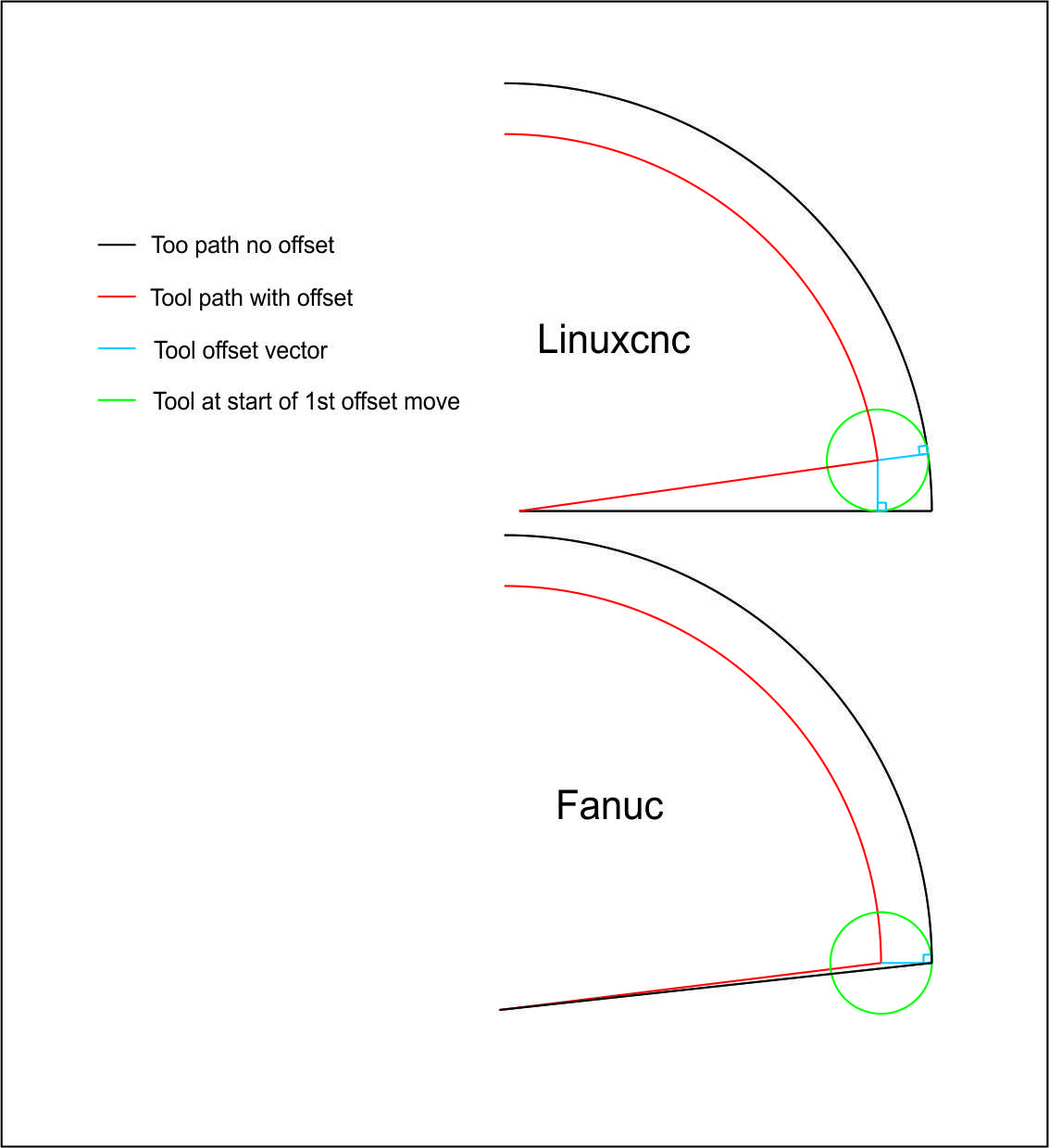

It is not the programmer who must add an additional line to generate the same desired path with G41. Linuxcnc must possess the intelligence of being able to enter a compensated path in the same way that it enters without it. Your answer is not a solution to the problem that I am posing, in more complex programs this line should be added many times, and that is not correct. I am planting the correction of this situation since 2008 and I can not make the developers interested in solving such a serious problem. Linuxcnc is a great application, it should not work in this way, Fanuc and all other controls do not require any additional line, allowing comfort to the programmer for very complicated work, for example in the area of mold manufacturing. For example, to make a linuxcnc cavity allows me to perform a roughing by cad-cam sistem, but it does not allow me to adjust the measurement using G41 and the tool table, I must generate many termination programs with different adjustment measures until the correct one, if this error is corrected, only a program with g41 and table are needed.

Dear Todd, thank you very much for your reply. The image that you posted is an excelent example of the diference between linux cnc and fanuc. I will try to convence linuxcnc developers to resolve this problem.

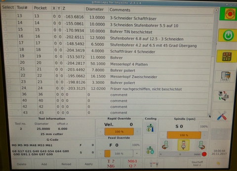

can you show an image of your tool table?

- RobotMatic
- Posts: 199
- Thank you received: 25
20 Nov 2017 10:26 #102065
by RobotMatic
Replied by RobotMatic on topic G41 and G42 Input path error
yes. G41 reads the value stored in the position of the tool table to use it. Your program does not load the value. you must do it manually or with the instruction G10 L. If this value is greater than the input path, it will give you an error. for example. There is no way to use G41 compensation without using the tool table. for that is this !!!!!!!!
D23 indicates the reading position in the table.
What is the value of Radio tool in position 23?

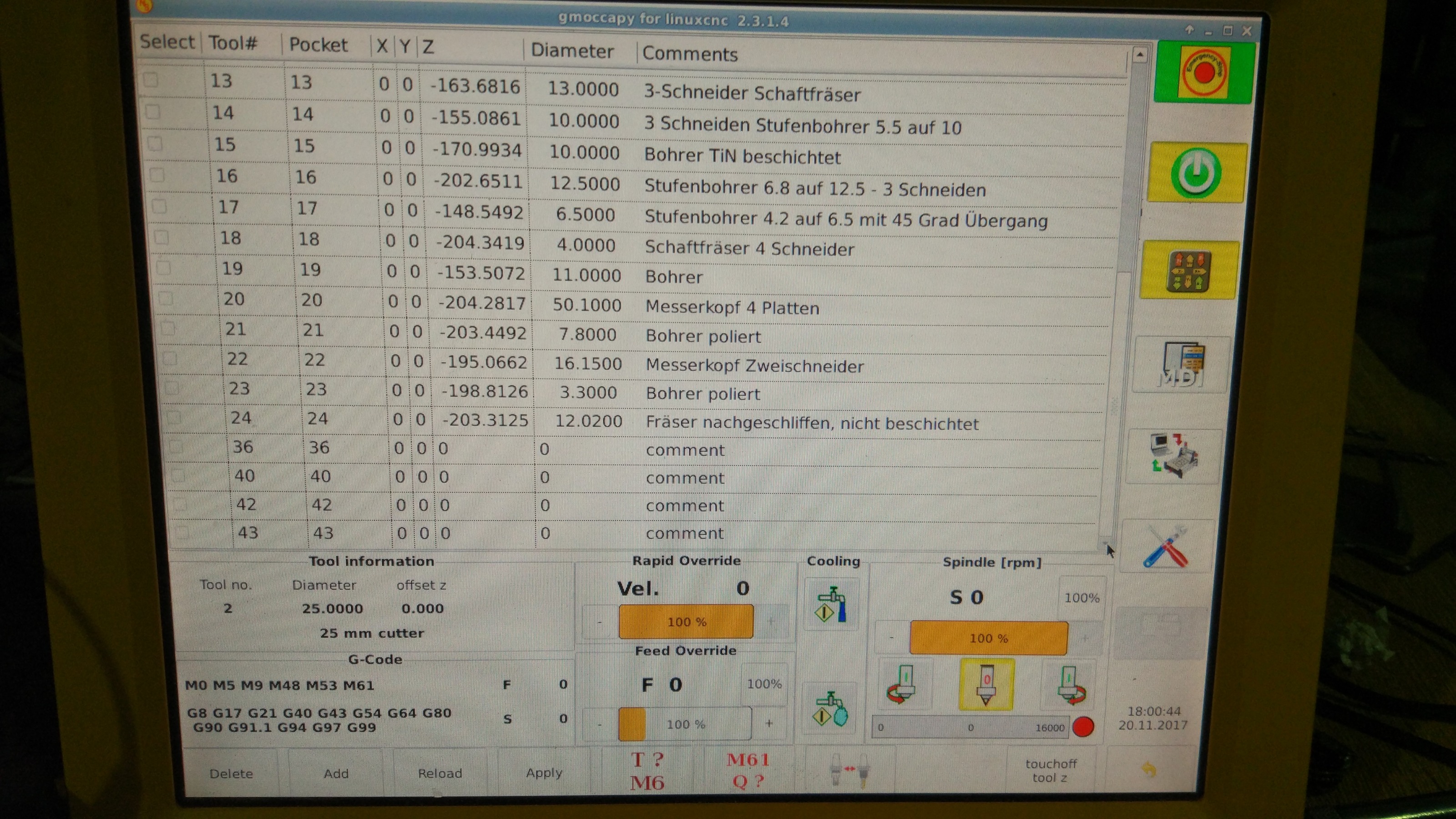

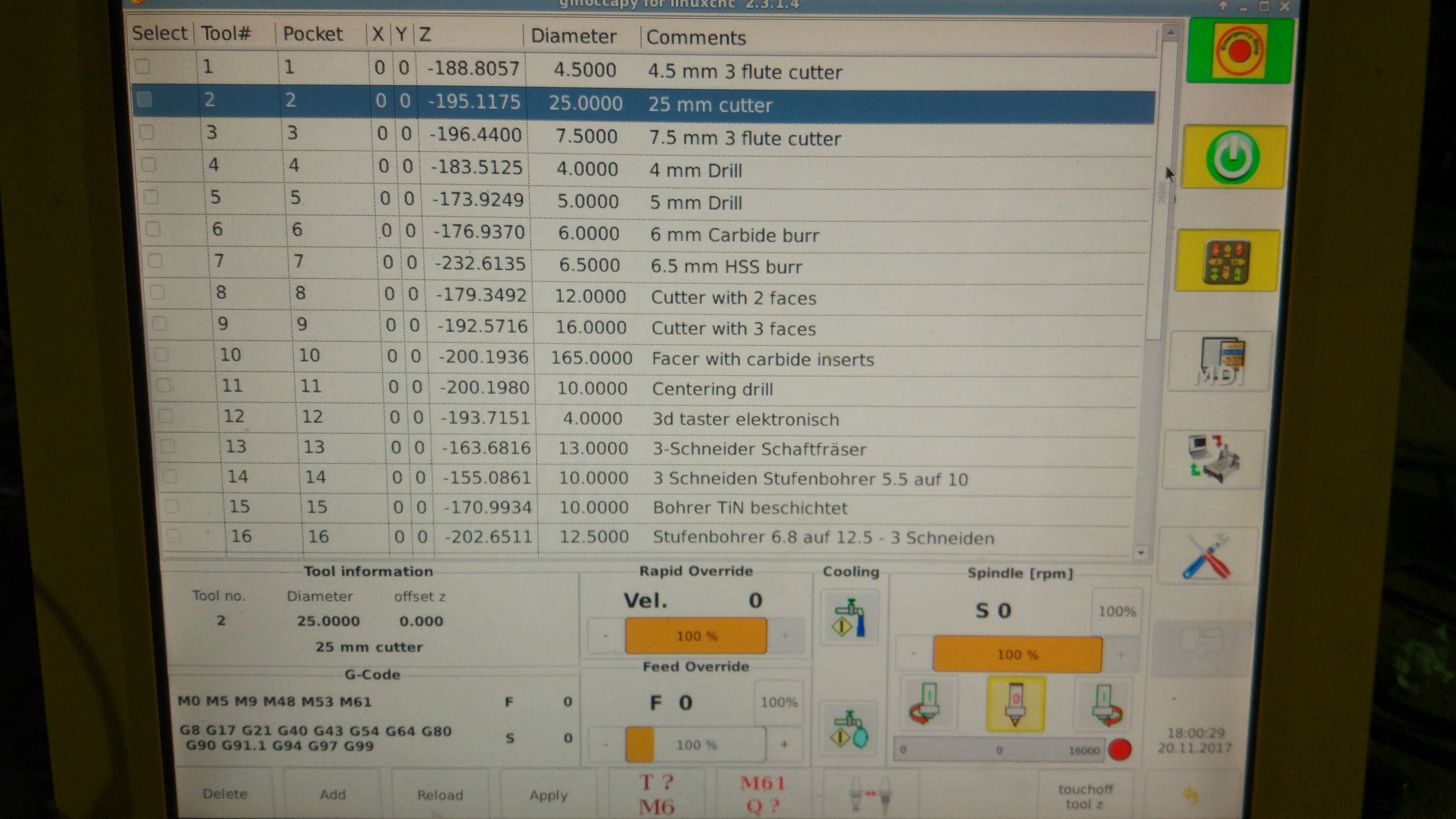

by crisiacuf
Sorry, but until this day I survived without needing to edit the tool table. I read about G41 arguments already but i have no idea where the postprocessor takes D23 from.
But Isn't the tool declared T03?
On position 23 in my tool table there is a 3 mm tool indeed. But where is "23" coming from? Blackmagic gcode ? In Solidworks CAM tool 3 has ID16.
I tried deleting D23 but same error message.
