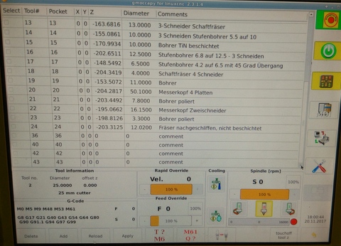

20 Nov 2017 16:16 #102110
by RobotMatic
Replied by RobotMatic on topic G41 and G42 Input path error
D23 is taken from your selection of tools in your cam. you will surely find the value in the configuration. For example, I use Surfcam and I can tell the system which table number to use, you should be able to do the same. But you do not have the problem in D23 as table position, your problem is in the value of the diameter (3mm is too big for the length of entry to the path you have programmed), so that your program works well, your diameter should be smaller to 1mm. Remember you must always place the value of your tool diameter in the table in order to use G41 or G42. it is from there where the value to be compensated is taken.
The following user(s) said Thank You: crisiacuf
- verticalperformance
- Posts: 55
- Thank you received: 11
20 Nov 2017 23:52 #102123
by verticalperformance
If you want to use tool #3 change the D23 to D3, but the real problem is that your next move after the entry move is less than the tool radius - it moves from X36.7 to X37 = 0.3 Cutter needs to be less than 0.6 diameter. Change the first move after comp to X36.7 + more than half the tool#3 diameter and see if that works.
Refer to www.linuxcnc.org/docs/2.7/html/gcode/too...:cutter-compensation
Best way to learn cutter diameter compensation is to write the code by hand and understand what it is doing. Alternately, in you CAM just turn it off, and let the Gcode reflect the tool centreline path, rather than the coordinates of the part itself. Will work provided that the tool diameter used in CAM is same as actual tool diameter!
As for where the T01 and D23 comes from - that is some sort of issue with the CAM postprocessor.
Replied by verticalperformance on topic G41 and G42 Input path error
T03 M06 ; This changes the tool to tool #3 (diameter unknown as screen grab doesn't show tool#3)
T01 G43 Z-3. H03 ; This seems to be preparing to load T01 (but doesn't because there is not an M6 yet) then sets the length compensation to that of tool#3
G41 D23 X36.7 Y16. F1988.82 ; This is turning on cutter radius compensation, and setting diameter used for compensation to that of tool 23
X37. F2651.76 ; First move after compensationIf you want to use tool #3 change the D23 to D3, but the real problem is that your next move after the entry move is less than the tool radius - it moves from X36.7 to X37 = 0.3 Cutter needs to be less than 0.6 diameter. Change the first move after comp to X36.7 + more than half the tool#3 diameter and see if that works.

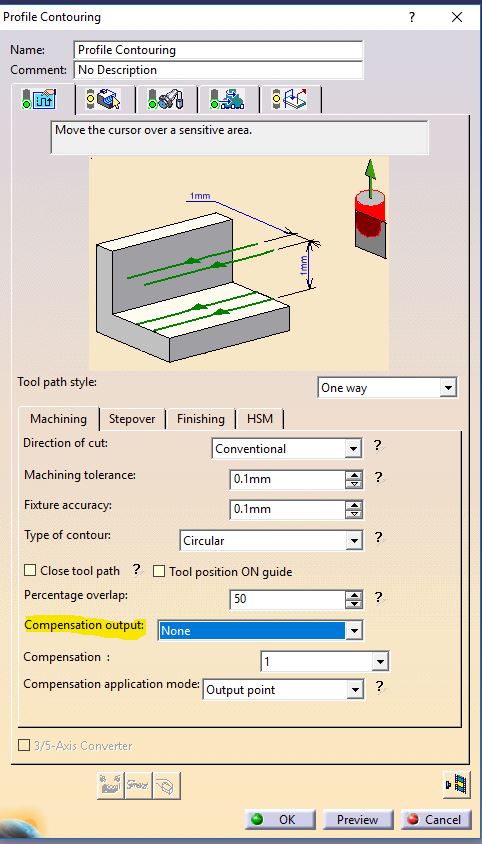

- Posts: 55
25 Nov 2017 16:27 #102341
Why don't you change your design to reflect your choice of tool? If you want to use a 10mm cutter it is normal for the pocket rad to be bigger than 5mm to allow the NC to "drive" around the corner, rather than stop and change direction, which will leave a dwell mark in the corner.
For the solidworks CAM questions, you might want repost those specific questions in the CAM section of the forum. I don't use solidworks but I think many do. In CATIA you usually have to explicitly turn on the compensation (see attached), many production CNC made parts suppliers don't use tool diameter compensation now anyway it seems.
Usually the post is supplied by the NC machine manufacturer, and they are usually not easily (if at all) tweak-able. CATIA generates an "NC Neutral" format APT file, which the post's generally convert to g-code. There are a few sample posts supplied with CATIA, and the FANUC 30 one generates g-code that works pretty well with linux CNC.
