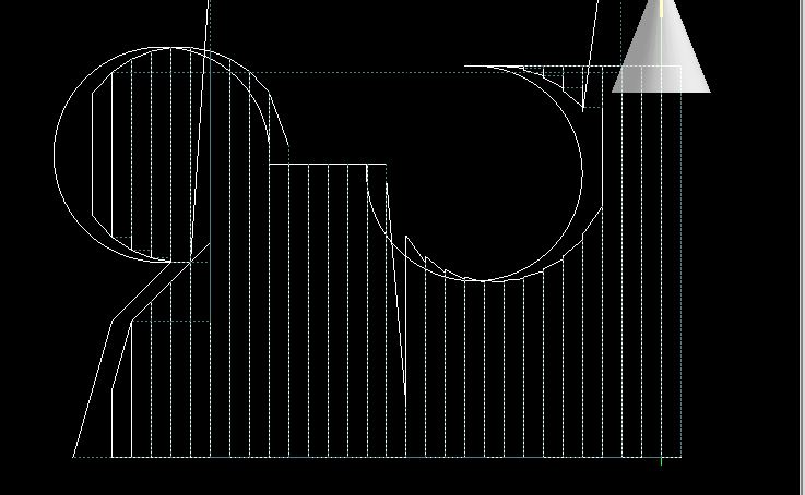

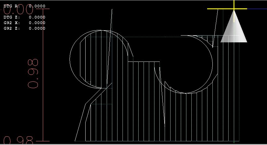

by r.lol
Replied by r.lol on topic G71
07 Jun 2019 17:23 #136235
Replied by andypugh on topic G71
It doesn't look like you are selecting any tool.
And I think that the error messages are reasonable, there is no way to make those shapes with any real tool.

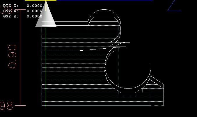

31 Jan 2020 14:23 #156255
by eneias_eringer
Replied by eneias_eringer on topic G71
Hello @andypugh and thankyou by the great work on this G71 !!!!! But i am facing problems when i try to use a o<>call before the G71 , in my case i use a o<m6>call to change tools , and when i call a tool before the g71, the rough shows but dont execute ... my solution now is just call g43h on sub , if i put a T M6 the cicle shows but dont execute...
31 Jan 2020 18:00 #156264
Be aware that there is work underway to incorporate a G71(with pockets) into LinuxCNC base code.
Have you considered using a G-code remap of M6 rather than an O<m6> call? I think this would probably work better, and would mean that you can use CAM G-code unmodified.
If you have an existing G-code subroutine then remapping M6 to call that directly is very easy.

31 Jan 2020 19:20 #156269
by eneias_eringer
got it this way:
T0101
M61Q1
and is working now ...but i dont know were is the problem !!!
T0101
M61Q1
11 Feb 2020 13:29 #157049
If you have remapped T to do a tool change there should not be any need for M61.
Does your remap include an M6?

11 Feb 2020 16:15 #157077
by eneias_eringer
andypugh , my problem is , if i do not put the M61 , G71 is show on "graphic" but dont execute , like in my video . this problem only ocurr when i use a subprogram or a remap code to change tools , in my tests, if you only put a T01M6 on a sub an try , have the same problem.
