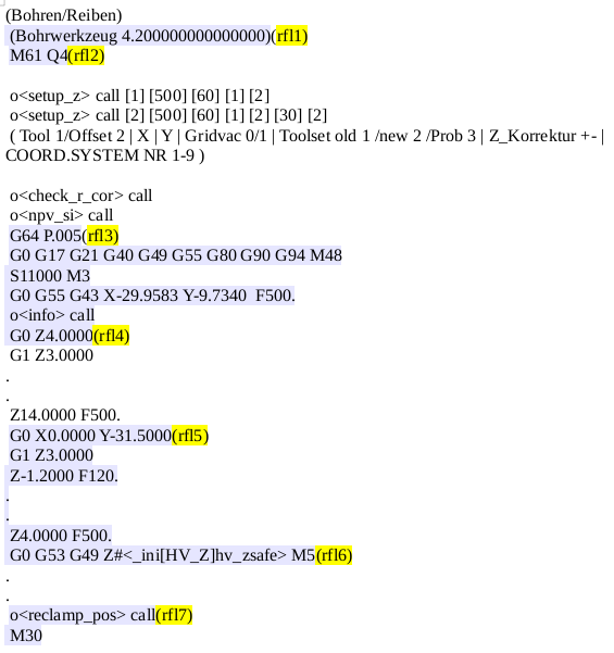

The following text is from the rfl.py file.
# If you are working with many subroutines, there likely would happen some problems with run from line
# for safe workflow this filter can be used, you decide which lines in your code will be used for machining.
# ini [FILTER]
# PROGRAM_EXTENSION = .py Python Script
# PROGRAM_EXTENSION = .rfl RunFromLine
# py = python
# rfl = /home/path/to/folder/rfl.py
# sudo chmod 755 /home/path/to/folder/rfl.py and set executable.
# Make a copy of your ngc file, attach ending .rfl to your ngc file to make it recognized by the filter.
# eg AirguideX.ngc.rfl It is tested with AXIS.
# Always 2 lines must have at least the comment (rfl). For better understanding,
# (rfl_s), (rfl_e) etc is accepted. Case sensitive, at least ' rfl ' must be lower case.
# So this lines and the lines between are in the filtered file for machining now.
# The last section until EOF, only need the start mark. If you don't go to EOF, last line with M30 needs (rfl) also.
Probing is started, or a rapid across the machine, or rapid in Z down to hell...
That is why I work on a workaround for me. The first attempt with the script is a safe way, but not so comfortable.
So now I work with a Filter, easy to stay in the machining environment, but also here its good advice to carefully select
the sections to be used for machining.
