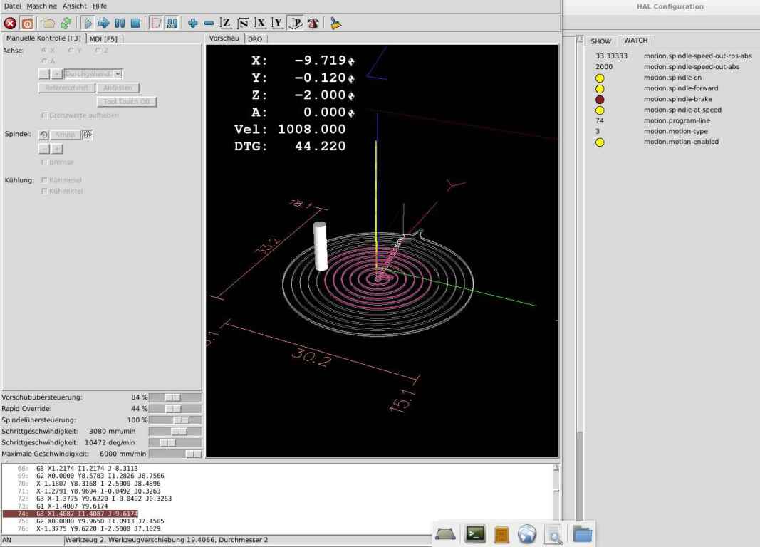

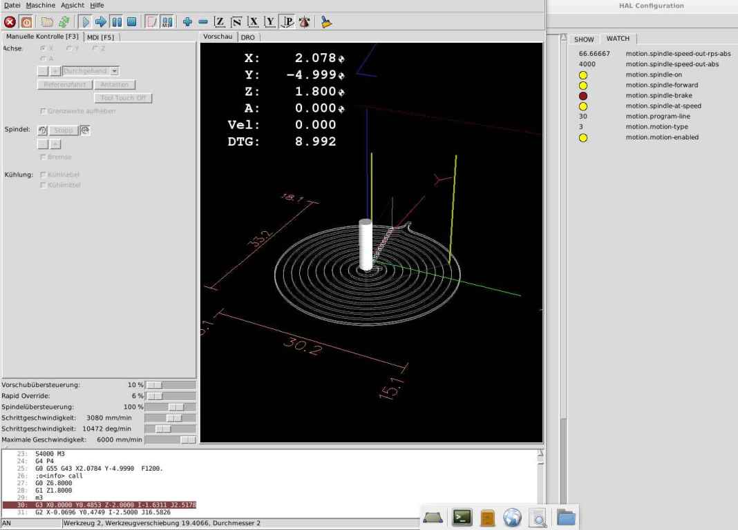

After spending hours working on this problem, I have found something, that I understand what I can do, what I have to and what is possible.
My configuration uses TIMEDELAY to give spindle time to speed up before G1 move. And LINCURVE is used to set minimum speed to 6000rpm.
I don't know how deep LINCURVE is involved, but at least TIMEDELAY leaves spindelcontrol pins disregarded when run from line, but comes back with M3 applied.

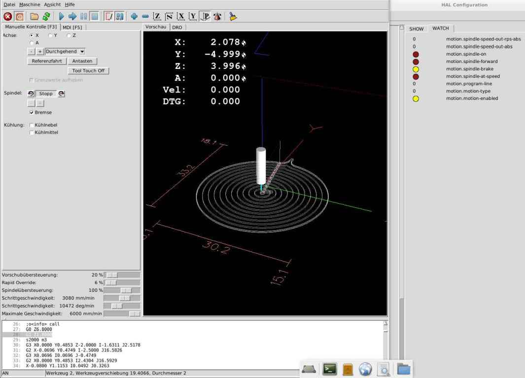

About this problem:
When run from line, even motion.spindle-at-speed is not true, machine makes feedmotions.
Action:
MDI, Start spindle, then run from line and everything looks correct, also motion.**** pins for spindle are correct then, or edit the .ngc file, insert M3 after run from line line.
The more complicated problem Run from line and Subroutines is much more complex, and not really understandable:
Some subroutines are skipped, others are executed, depending on content, when run from line. If they contain M66 E0 L0, chance raises, they get executed.
Subroutines for Log, or display (msg )or (debug) some information do not really harm,even they are executed.
Subroutine used for a certain machining operation may get executed with wrong tool in spindle, if there are Toolchange before the targetline.
If subroutines doing calculations, setting or shifting ofsets or toolparameter, are before the target line and in case the get executed, trouble begins. If you are lucky and get kicked out of working area, there is at least an error.
If by fault a subroutine is executed after run from line, motion.program.line and as well the line in text display in axis pointing to a line in main program.
Action:
Tough there is need to edit the .ngc file and spoil it in a way for further use, i would comment all subroutines before target line, and take care spindle starts, then run from line should work fine.

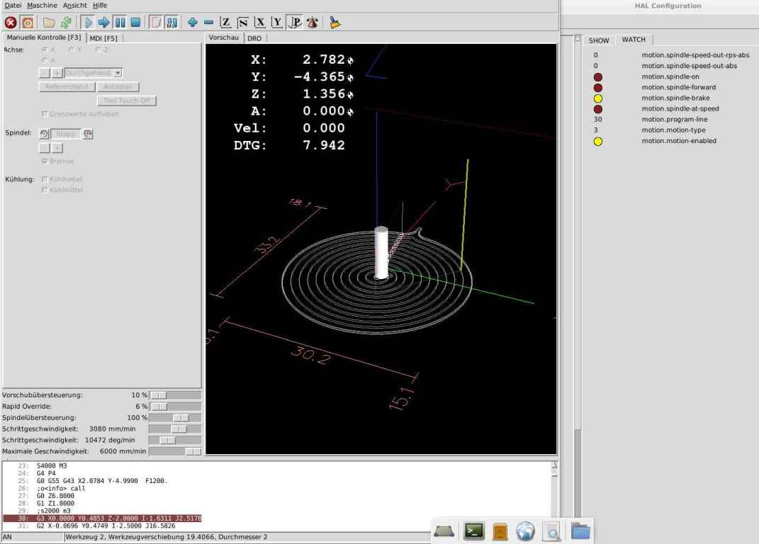

Finally also made a new Filter. On the first line of the .ngc file #<_rfl> = 1122 (startline) can be entered and it goes from line 1122 to EOF. From there should be easy to run from line and avoid subroutines hassling your workflow. I used #<_rfl> to set the startline, so it can be used for further anything if needed.
This is my final solution as a few times already. But now it is really quick and easy, as i require. As i think it gonna be very difficult to get rid of this superstrange behaviour run from line / subroutines, this is ok for me now, and the case is solved.
Machine idle, before run file
Program started, state timedelay, S4000 M3 is at line 23, but motion.program.line is still 0, even the spindle is at speeding up
Program running. Everything correct
Run from line, feed motion, spindle not active
Run from line, feed motion, M3 inserted on line 29, spindle active, everything correct

Even this was (amost) solved for me, there is always some headroom for improvement, keep up to date and a short conclusion about my workaround so far, and the most recent gcode filter I use now. Working with some setup for a while, finding various solutions, I made step by step improvement.
Starting with the shellscript was solid, I had a file as output, but the effort was too big for me, also to take modifications back to the source file.
Next, the first gcode filter, looking for labels named (rfl), was a good idea, but the name needs to be more unique and I didn't like editing the .ngc file, setting the marks at various positions, as the files are stored in an archive and get reused.

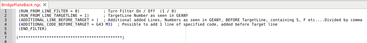

The next attempt, a new gcode filter, looking for an entry at the beginning of the file, containing just the targetline number. Working very good, fading out everything before this line. Easy to use, but for me not versatile enough, but still a good one. I think this is the one, just to skip a part of the program.
The most recent filter, now in use for a while, is almost, what I am looking for. Also here have to make an entry on top of the file:
(RUN_FROM_LINE_FILTER = 1) ; Turn Filter On / Off (1 / 0)
(RUN_FROM_LINE_TARGETLINE = 237) ; TargetLine Number as seen in GEANY
(ADDITIONAL_LINE_BEFORE_TARGET = 187,193,194,195) ; Additional added Lines, Numbers as seen in GEANY, BEFORE TargetLine, containing S, F etc....Divided by comma
(ADDITIONAL_CODE_BEFORE_TARGET = G0 G55 G43 X-24.3888 Y38.3571 F500 M3) ; Possible to add 1 line of specified code, added before Target line
(END_FILTER)

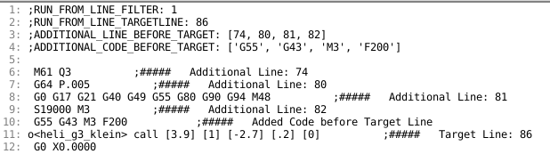

Header in .ngc file
Now able to turn filter on/off, have additional lines before targetline and also 1 line of gcode of choice can be added. I think, having the filter configuration in the gcode file, is the safest way. Even a panel or input box could be nice also.
When I start a Job, .ngc file is used. On occasion to restart from line, I make the entrys at the header, save file as, adding ending .rfl and run this file.
1st pass the Filter reads until (END_FILTER), then apply the various input, 2nd pass insert additional code and additional lines, then start file output at target line. All the inserted lines and target lines have a mark, to understand the source.
What you see when running with Filter applied...
Now I am used to this workflow, producing many parts this way. I always edit the .ngc file for modifications, then save as, add endig .rfl. For me it is a safe way, because ending .ngc the full file is running , alternative ending .rfl and (RUN_FROM_LINE_FILTER = 1) the filter is aplied.
Shure, need to doublecheck if physical tool and Tooldata are correct, G43, feed for Z position, offset, just what one needs to check anyway.
Info is also in the file "runfromline.py"

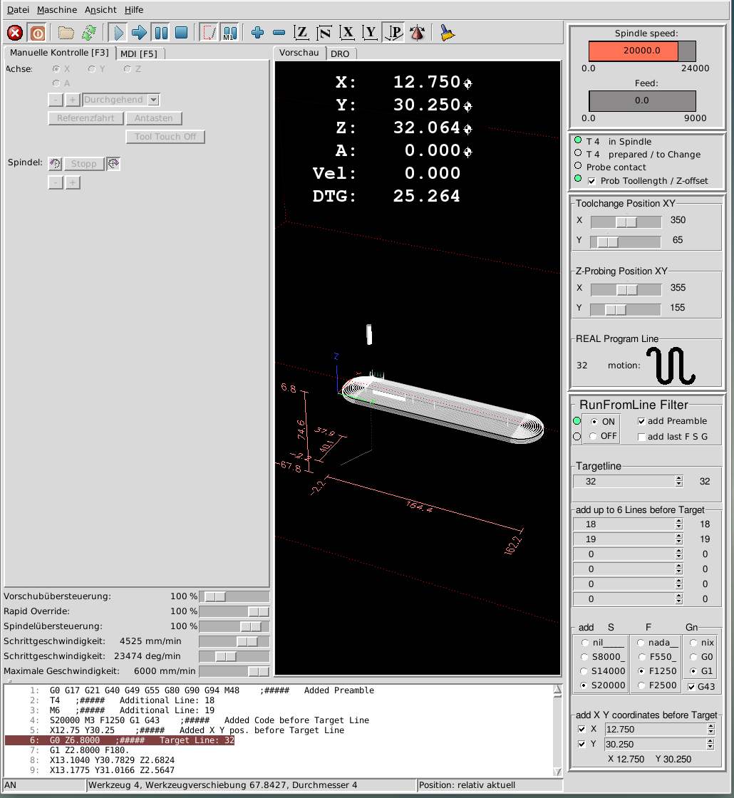

Did a lot of work, using the new sidepanel, it is perfect for my workflow, break, redo or continue is simple now. Only had to do some minor modifications.
I managed to always display the highest number of motion.program-line, and it stays displayed on break, reseted by reload file.
Toolchange and toolprobing position adjust by slider works fine. Now i save the values, after restart recover the selected positions.
Have the filter turned on and loading a new ngc file is no good. The filename is saved to a temp file now, when load a new file
compare with argv[0]. The message component is used to remind me, if the filter is on when loading a new file. I feel now, the air is getting thinner for more improvements.
