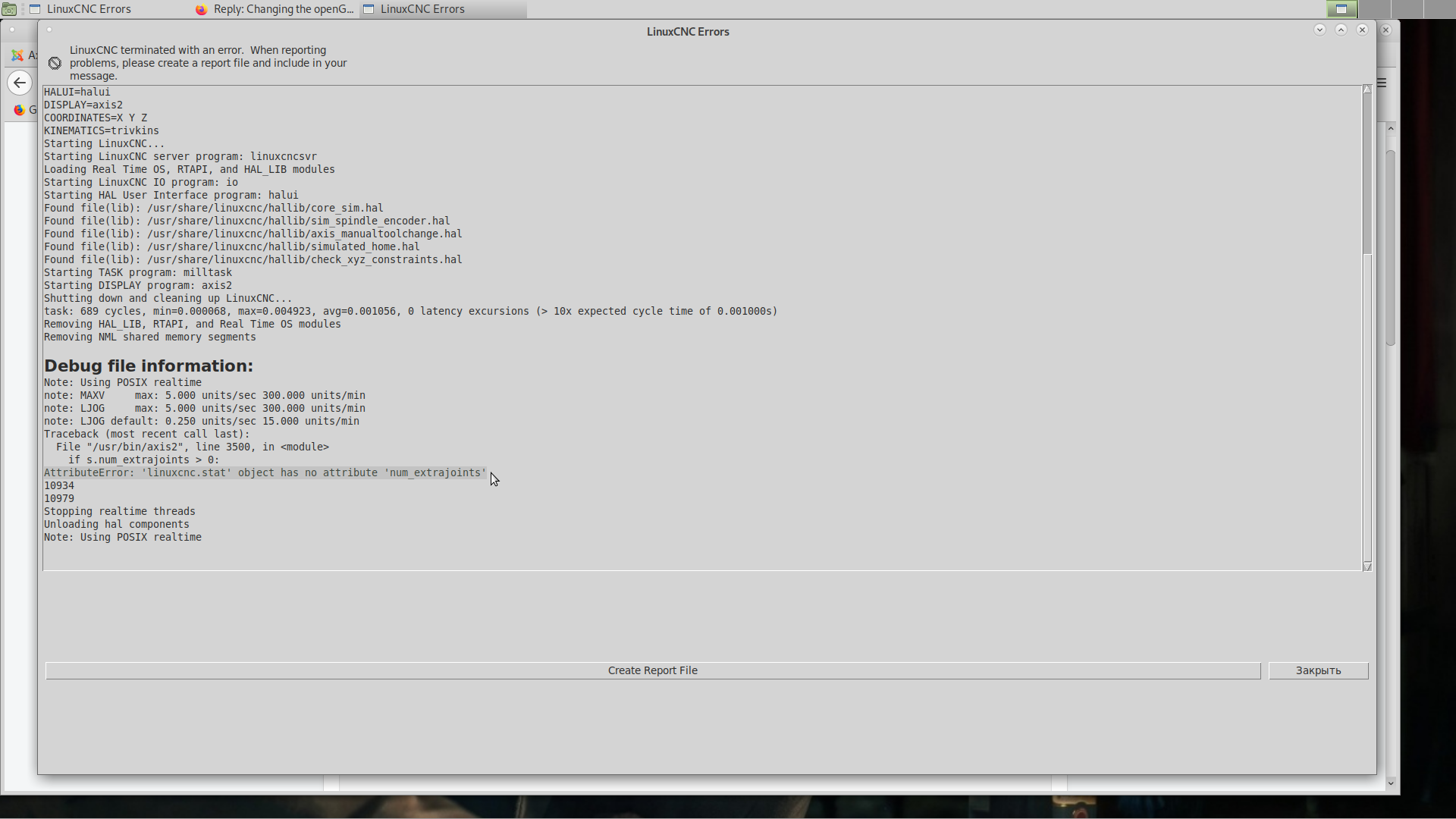

- SvenH
- Posts: 71
24 Dec 2020 09:10 #193121
by SvenH
Replied by SvenH on topic Changing the openGL colors in the Axis GUI
I tried to get the last files to work,
Copied them in a file manager as root
Changed names after renaming the originals
Changed permissions to what the originals were
Made the .py file executable
Did I miss how to properly get them working somewhere in this thread?

15 Apr 2021 11:41 #206018
by zack
Replied by zack on topic Changing the openGL colors in the Axis GUI
please test again
