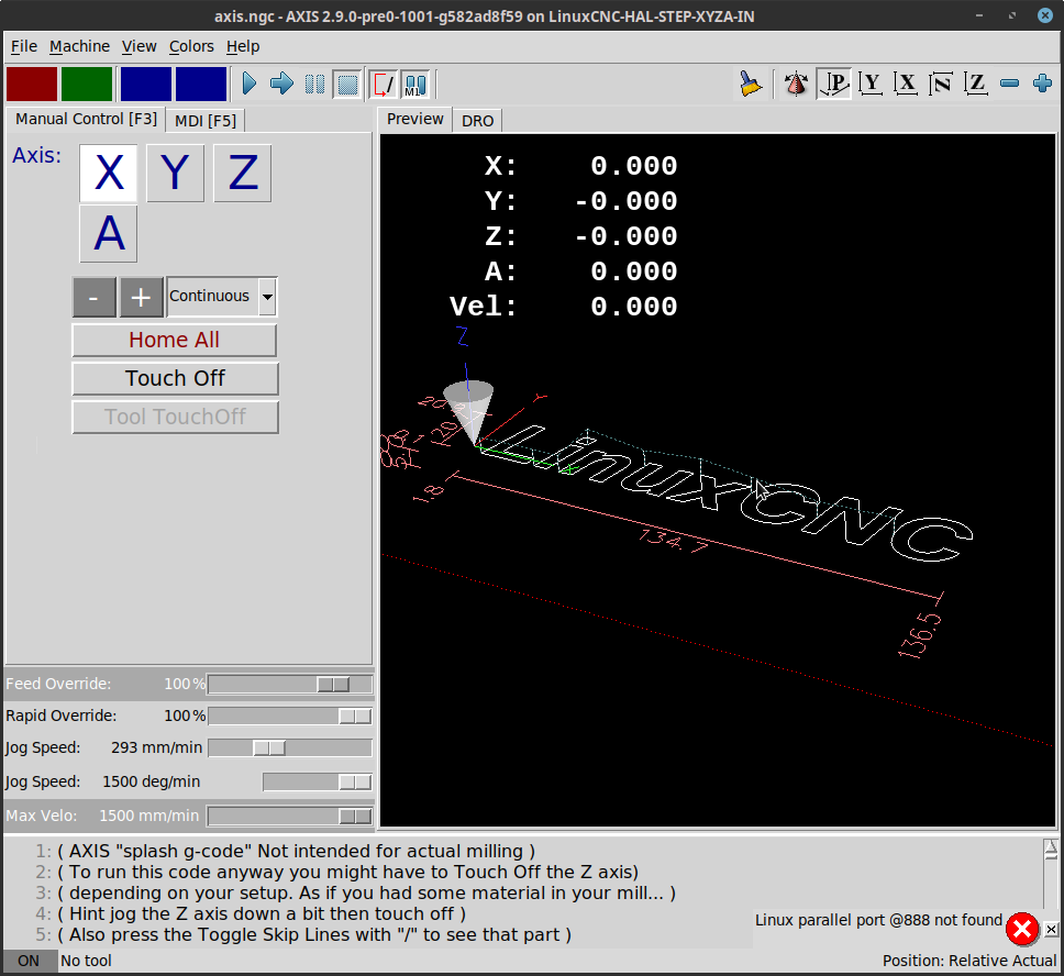

23 Mar 2020 01:26 #161194
by zack
Replied by zack on topic Changing the openGL colors in the Axis GUI
Kept it the same as per Tommys suggestions,
but can do anything you need to enhance for touch screen
maybe enlarge sliders etc.
I was thinking of making all the colours variables and having a
dialogue menu for users to customize the look themselves.
see attatched, dont forget to make it axis.tcl and put in usr\share\axis
with root permission

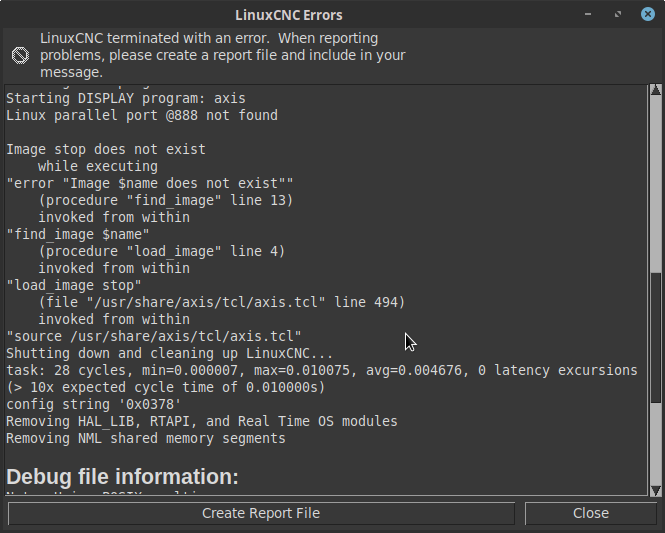

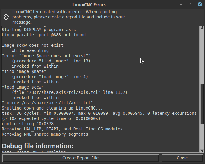

23 Mar 2020 10:35 - 23 Mar 2020 10:52 #161227
by zack
Apologies thought i removed those icons
Please send a screenshot of this example attached

23 Mar 2020 11:36 #161231

23 Mar 2020 12:30 #161237
by zack
Dannit i keep forgetting those custom icons.
I would rather keep it simple.
Please please try again.
- Online
- Posts: 22043
- Thank you received: 7506
23 Mar 2020 13:45 #161242
Replied by tommylight on topic Changing the openGL colors in the Axis GUI
Can you upload those custom icons ?
- Online
- Posts: 22043
23 Mar 2020 13:48 #161243
The following user(s) said Thank You: joekline9, zack, Soccer Kid

23 Mar 2020 15:15 - 25 Mar 2020 15:23 #161267
by zack
Sure will post icons when the set is complete, do you think i should keep the original naming in case they don't get uploaded by a user. or should we just go with text.
I can also embed the data in the axis.tcl file. it will remain small if i use index colours.
there is a color menu item please try it out for feedback purposes.
how many users still use Axis ?
Do you guys think its worth sorting this GUI out, I was also developing a qtpyvcp custom panel, but rather like axis, basically started with the first version a decade ago.
any suggestions welcome
