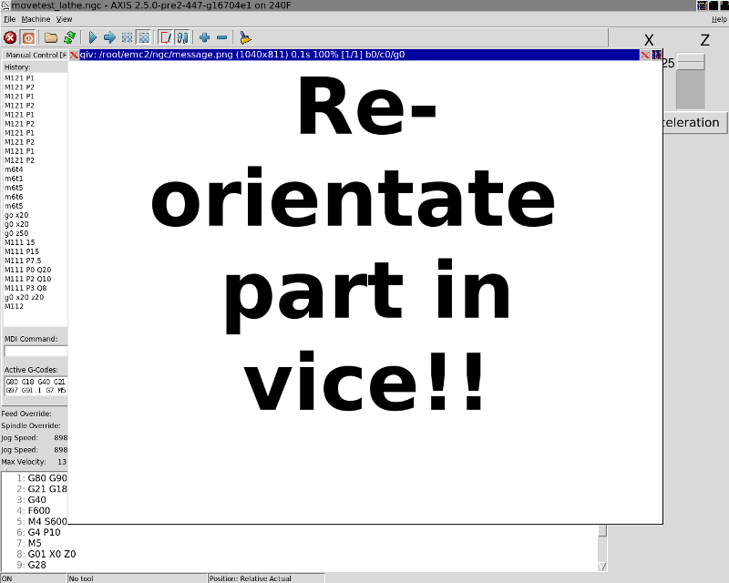

Is there a way to print a message from a G code program to the AXIS screen?
It would be nice to be able to prompt the operator when the machine pauses
for a manual part reorientation in the vice.

Yes, you use a message comment.

Yes I have that part. I failed to explain that I was hoping for is a way to make the message large
enough to be seen from a distance, say ten feet the distance from my Bridgeport mill to the CNC
rig.

The you want to check out GladeVCP, it is quite versatile. That is in 2.5 btw...
linuxcnc.org/docview/2.5/html/gui/gladevcp.html
and
linuxcnc.org/index.php/english/component...ew&catid=48&id=16439

Another easy way to do this is to use a 'user M code'.
The zip contains a .png image which contains the text "Re-orientate part in vice!!"
Place this together with the file M112 contained in the .zip in the directory specified in your .ini file under PROGRAM_PREFIX=
You may need to edit M112 if the location of the image differs or if you use a different viewer in place of qiv
(make sure you leave it executable - chmod 755)
To run you just have to use the M112 in your g code program.
Very simple and save messing about with glade if you don't use it for anything else.
Just one of the many ways to skin this particular cat!

On a stock install from the LiveCD you might want to use the following line
eog /home/computername/emc2/nc_files/message.png
eog is Eye of Gnome which comes installed with the LiveCD.
John
