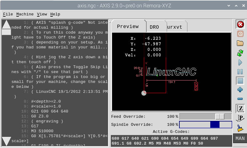

ok lets try and make this more touchscreen friendly
just a rough idea, still needs to be cleaned up, 2.9 only

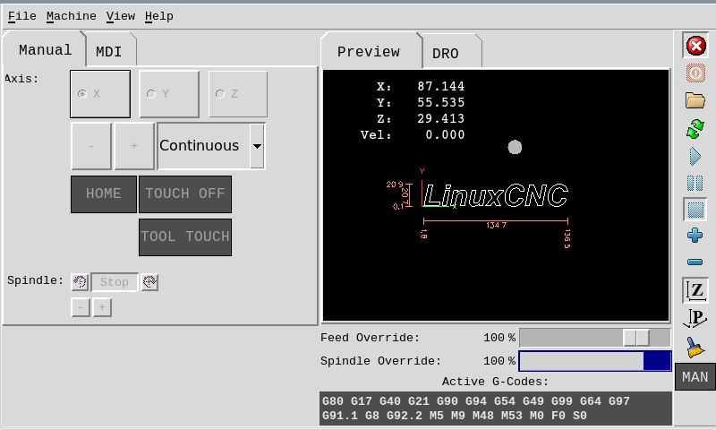

Replied by envyvan on topic [solved]Axis for 800x480 screen w/ usercommand
Hi Cakeslob,
I would need some help with the button of Pyvcp, Seems like only the radio button can hold the value, but they are too small for the touch screen usage.
I want to use them for Jog Axis select and the Jog Scale select.
Any suggestion would be appreciate.
- cakeslob
- Posts: 927
- Thank you received: 280
13 Aug 2021 03:24 #217651
by cakeslob
Replied by cakeslob on topic [solved]Axis for 800x480 screen w/ usercommand
I dont think that you can resize them in pyvcp at xml level, there seem to be a few work arounds like with halui and different pins/states using regular buttons, im not too good with computers so I still struggle with it. Im in the process of making them bigger in the axis manual tab though
- cakeslob
- Posts: 927

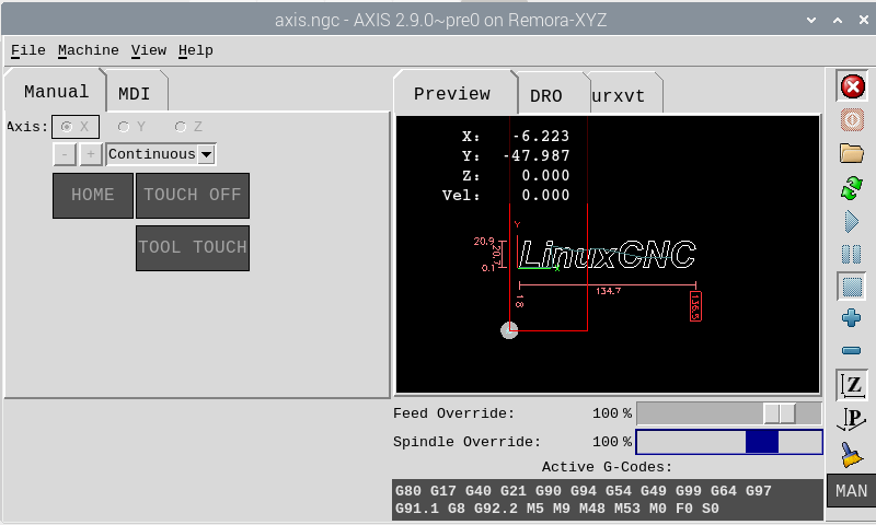

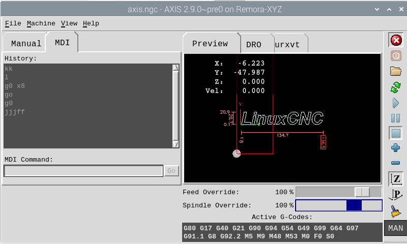

16 Aug 2021 03:43 #217855
by cakeslob
Here, add this to your usercommand file, it seems to work alright
W('.pane.top.tabs.fmanual.axes.axisx','configure','-width','5','-height','3','-relief','raised')
W('.pane.top.tabs.fmanual.axes.axisy','configure','-width','5','-height','3','-relief','raised')
W('.pane.top.tabs.fmanual.axes.axisz','configure','-width','5','-height','3','-relief','raised')
W('.pane.top.tabs.fmanual.jogf.jog.jogminus','configure','-width','5','-height','3')
W('.pane.top.tabs.fmanual.jogf.jog.jogplus','configure','-width','5','-height','3')
W('.pane.top.tabs.fmanual.jogf.jog.jogincr','configure','-font','10')Attachments:

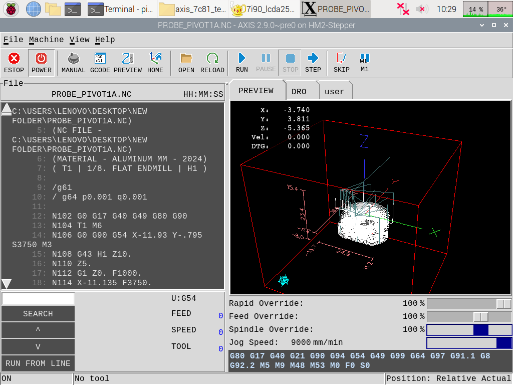

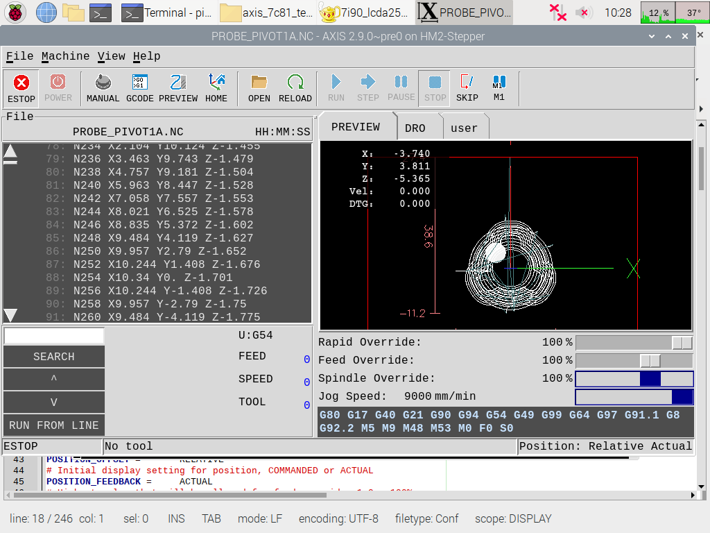

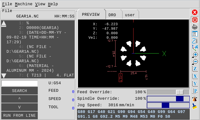

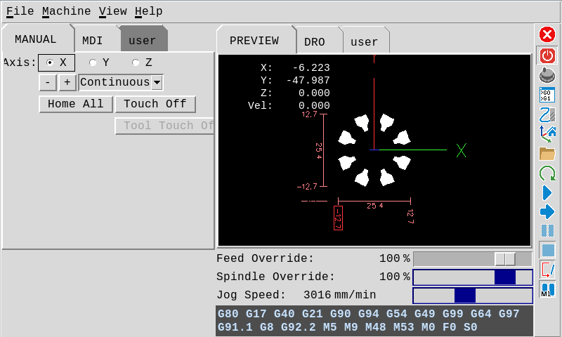

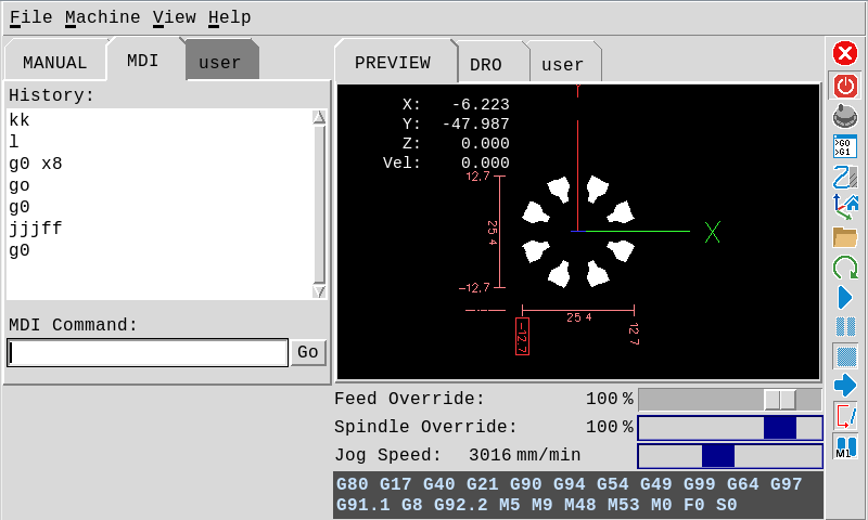

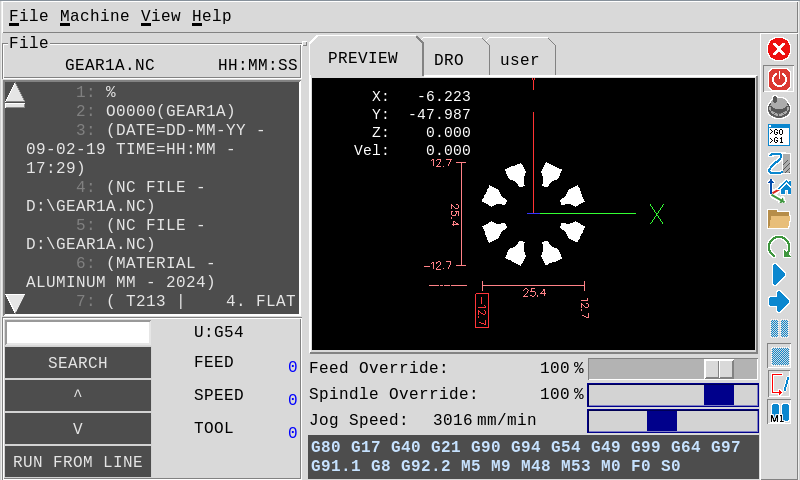

Here is my new version, I still need to clean up and remove all the experimental code , but it provides good working examples for others if they care to play with axis in this way, so here is the new one, pre release
I wouldnt run this pre release one on a production machine, the runfrom line button starts immediately, and other things need clean./
It has 2 modes, regular and small, this is done in the INI file
It also includes an image folder, this needs to be placed in the folder your config/usercommand file is running
LOAD_LASTFILE will load the last file you opened
TOOLBAR_RIGHT , this changes from larger screen to smaller 800x480 screen. set yes for smaller screen, without it, the screen can fit 1000x600 screen. It is a tight fit into 800x480 but it can make it when its fullscreen
There are 4 new buttons on the top toolbar.
-MANUAL - this loads the manual/mdi tabs into view
-GCODE - this loads the gcode buttons to the toolbar and brings up the gcode window
-PREVIEW - this loads the preview control buttons and hides the gcode buttons
- HOME - this just home all button. I added for easy access
this was the only way I could keep all the buttons with out loosing space.
There is also a user panel at the bottom under the gcode window. I will probably remove this for the final version, but for the reference version, it has some cool things to play with like run from line button and gcode search box. I also have examples of adding and populating new tabs and if nothign else , serves as a good reference tool for others. It also has feed, speed,tool and offset labels that work
TODO
fix runtime clock
fix search (hangs when there is no entry found)
make better for touch screen
make run from line safer with a warning
[DISPLAY]
LOAD_LASTFILE = YES
TOOLBAR_RIGHT = YES
USER_COMMAND_FILE = usercommand_800_pre.pyIt also includes an image folder, this needs to be placed in the folder your config/usercommand file is running
TODO
fix runtime clock
