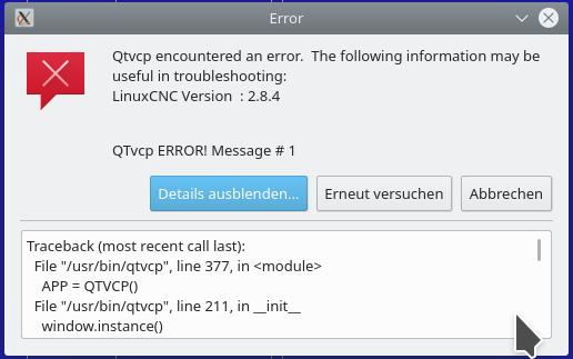

Oh yes I forgot about the python2/3 encoding trouble. Sorry about that.
Looks like its the code to subscript the increment display.
I don't think I have a system that runs 2.8 at the moment so can't advise how to adapt it.
It.
Chris
It.
Chris
The following user(s) said Thank You: seuchato
- Posts: 7368
- Thank you received: 2182
12 Nov 2022 14:11 #256528
Replied by cmorley on topic Can't install camview in buster
I think if you use the 2.8.4 camview_widget.py but use the updated 2.9 cam_align handler, you will at least be able to set the rotation increment from the INI.

chris, tried as per the above quoted posts:Increment is stuck at 0.5°
greez
chris
Replied by seuchato on topic Can't install camview in buster
I did commit changes to 2.9 to allow setting the rotation increment with the INI with -o rotincr=.2
/usr/share/doc/linuxcnc/examples/sample-configs/sim/axis/qtvcp$
grep cam_align qtvcp_tab.ini
EMBED_TAB_NAME= cam_align
# EMBED_TAB_COMMAND= halcmd loadusr -Wn qtvcp_embed qtvcp -d -c qtvcp_embed -x {XID} cam_align
EMBED_TAB_COMMAND= halcmd loadusr -Wn qtvcp_embed qtvcp -d -c qtvcp_embed -x {XID} -o size=2304,1636 -o rotincr=.1 cam_aligngreez
chris
