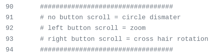

06 Nov 2022 08:53 #256051
by seuchato
Replied by seuchato on topic Can't install camview in buster
Playing around with cam_align: Knocks me off my socks. How hot is that:
Taken from here: "github.com/LinuxCNC/linuxcnc/blob/master...mview_widget.py#L281"
cmorley: I declare myself a fan of you and that super work!
Thanks a ton for this!
chris
chris

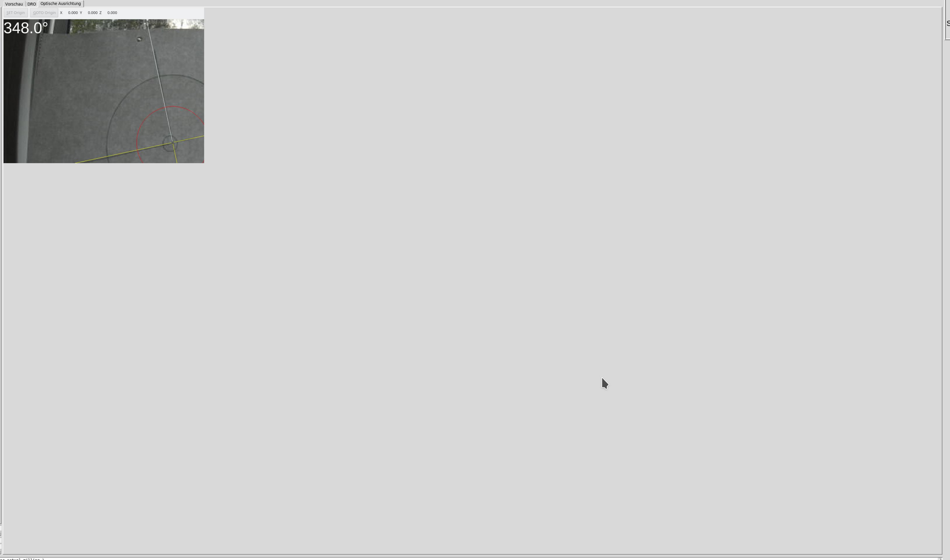

06 Nov 2022 15:51 #256078
by seuchato
Hi allIgot the delay down to a few seconds. While this is acceptable to me, I don't know why it decreased. That leaves a bit a bad taste and a kind of uncertanty: will it stay like that or come back to a higher delay later?For the time being, I consider this issue solved.I do have another issue though: While axis and DRO preview tabs scale nicely to the the space available, the cam_align tab does not:axis preview:
cam_align tab after resizing:
You can see, the cam_align picture is a) not expanded to the available tab camvas size b) after trying to resize with the mouse, the picture istelf is cut off.
I looked at the source code (github.com/LinuxCNC/linuxcnc/blob/master...mview_widget.py#L281), and indeed, the window size is hard coded:
I guess, that could be changed. I will try to change the fixed size to another value. I do write apps in C++ though and a few java thingis. As I am not familiar with python, I guess, I cannot suggest an appropriate modification. Maybe Chris Morley could?
It would be the dot an a perfect thing
greez
chris
greez
chris
- Posts: 7361
- Thank you received: 2173
07 Nov 2022 05:29 #256115
Replied by cmorley on topic Can't install camview in buster
Ideally the tab would resize automatically.
In pyqt4 it worked pretty well. pyqt5 not so much.
I could make the default size settable from the INI when loading I think, if that would help.

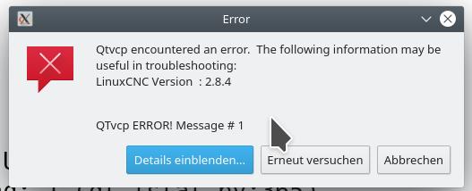

09 Nov 2022 13:35 #256285
by seuchato
Chris
Found the file with your patch here: "github.com/LinuxCNC/linuxcnc/tree/master...vcp/panels/cam_align"
I renamed the existing .ui and .py to .ui/py.sav copied the ui and py file from above reference, chown them to cncn user and group.
my cam_align.inc:
The comments hopefully help to trace it down.
Greez
chris
my cam_align.inc:

# EMBED_TAB_COMMAND= halcmd loadusr -Wn qtvcp_embed qtvcp -d -c qtvcp_embed -x {XID} cam_align
# Does not work, linuxcnc crashes immediately after logoshows => -U-crash.txt
EMBED_TAB_COMMAND= halcmd loadusr -Wn qtvcp_embed qtvcp -d -c qtvcp_embed -x {XID} -U size=800,600 cam_align
# Does not work, linuxcnc starts, shows manual toolchanger message and then an errormessage, waits seemingly for ever to
