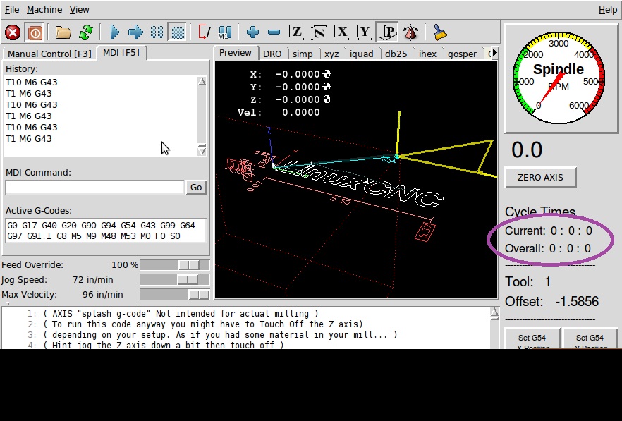

Where did you see it? First place to ask?
(Your current timer is one Probotix cobbled together using classic ladder timers by the look of it - is this Probotix related too?)
Replied by ArcEye on topic help with Timer
I noticed that someone had a accumulative type which I have enclosed a picture of.

the screen shot was from a google search
www.google.com/search?q=linux+cnc+pyvcp+...-15.html%3B882%3B597
the other was from this forum
www.linuxcnc.org/index.php/english/forum...le-timer-not-working

Seems like you are in a loop, you posted on that same thread 6 months ago,
www.linuxcnc.org/index.php/english/forum...not-working?start=30
I'll leave JT to answer re his timer
The other screenshot is from pasha, may well have been when he was demo'ing the improved dial widget
Doubt you will be able to get hold of him

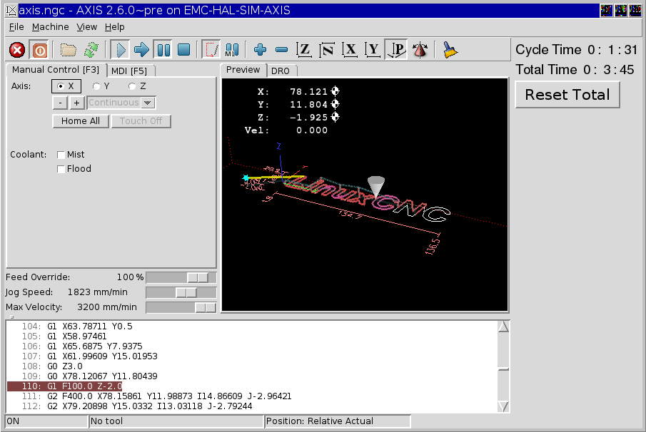

01 Feb 2014 23:33 - 02 Feb 2014 17:40 #43400
by ArcEye
OK
Here is JT's timer, modified to show a cumulative total of cycle times for all jobs since it was launched.
The cumulative timer should hold 9942.0539213 hours, ought to be long enough!
and here it is running
Instructions for compiling etc same as on the other thread
regards

02 Feb 2014 17:46 #43426
by ArcEye
There is no 'entire set of files' . All the info you need is in the header of the comp file
Cut and paste the whole file and save as time2.comp
Compile with sudo comp --install time2.comp
Add the pyvcp xml bit from the header to your pyvcp xml file, whatever it is called
Add the hal section of the header to your postgui.hal file ( you have not done this, it is still the old code)
(NB This component is called time2, not time, make sure you are loading the right component)
