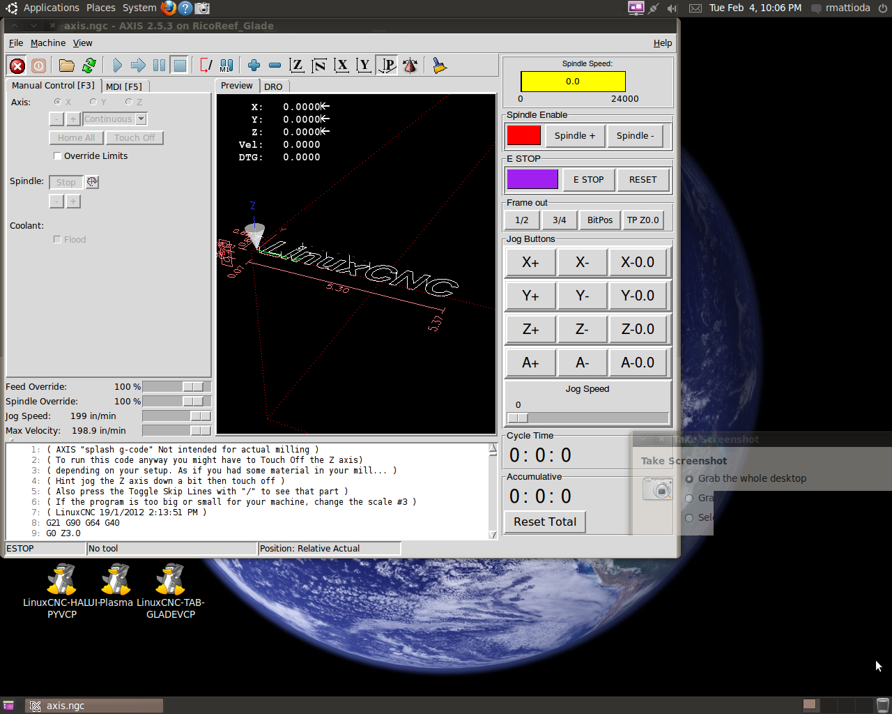

hey! me again.
what part of the file goes into the post gui?
cant seem to get them to work with the xml, plus it wont allow it to open, I can how ever get the time2 to loadrt,

04 Feb 2014 17:30 #43527
by ArcEye
Not at all, I was reaching for something MUCH heavier
Attached are the modified xml and postgui.hal file from the original config you sent
I can't zip the whole lot because I have heavily hacked it to run as a sim
Replied by ArcEye on topic help with Timer
Thanks for the help!!
ArcEye was ready to throw a stapler at me for sure

05 Feb 2014 12:09 #43566
by rmattioda
Replied by rmattioda on topic help with Timer
purrs like a kitten, now off to a touch plate
