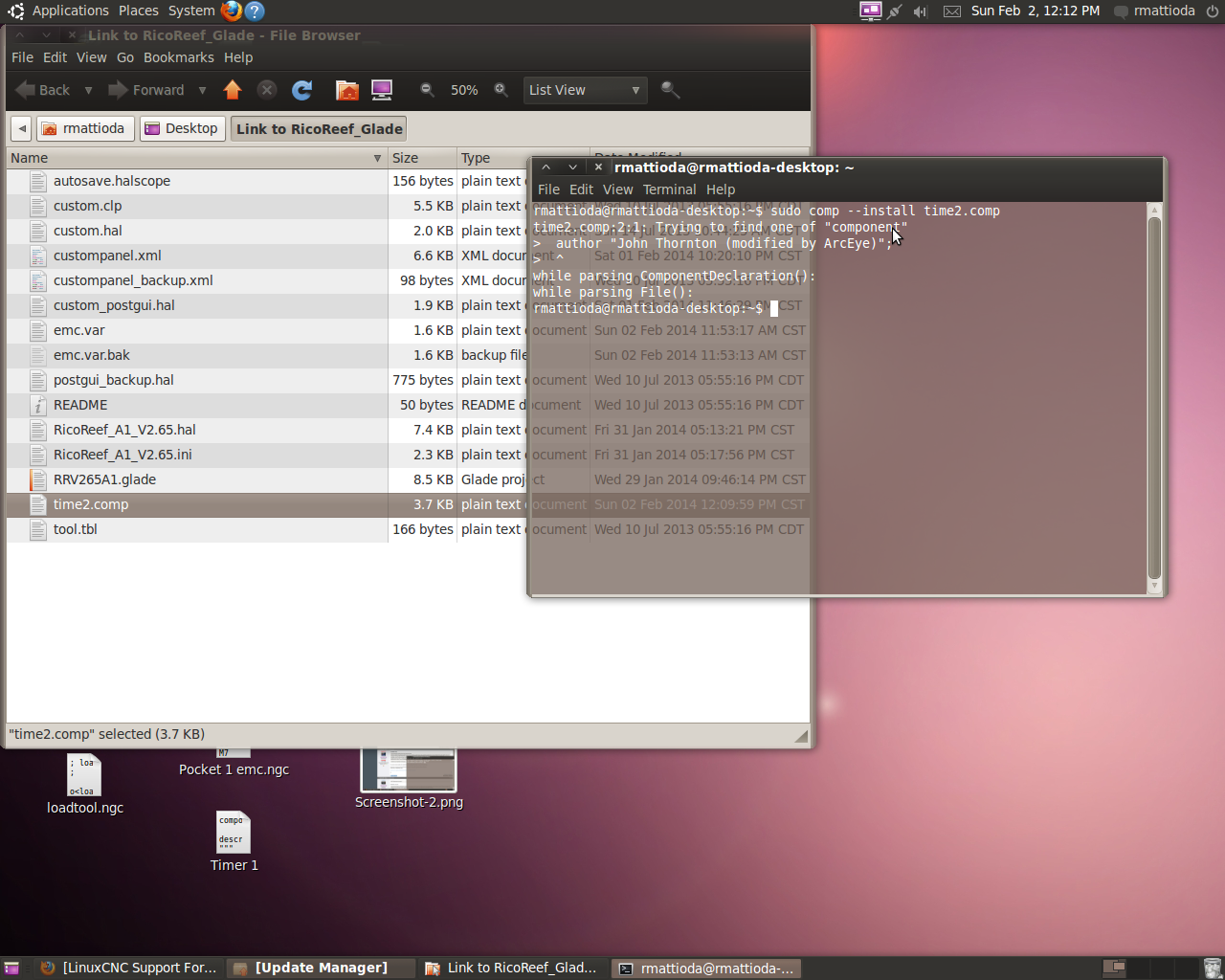

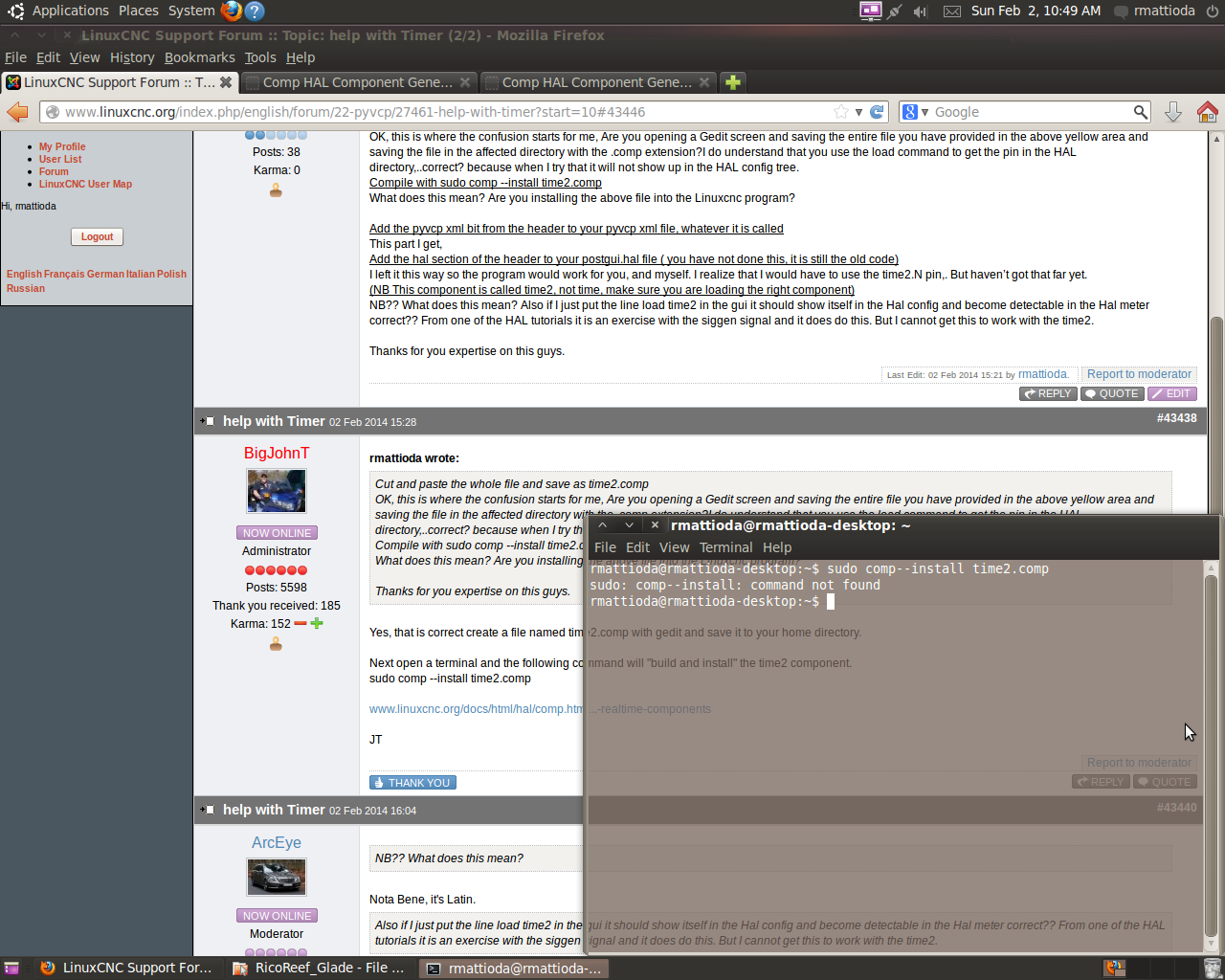

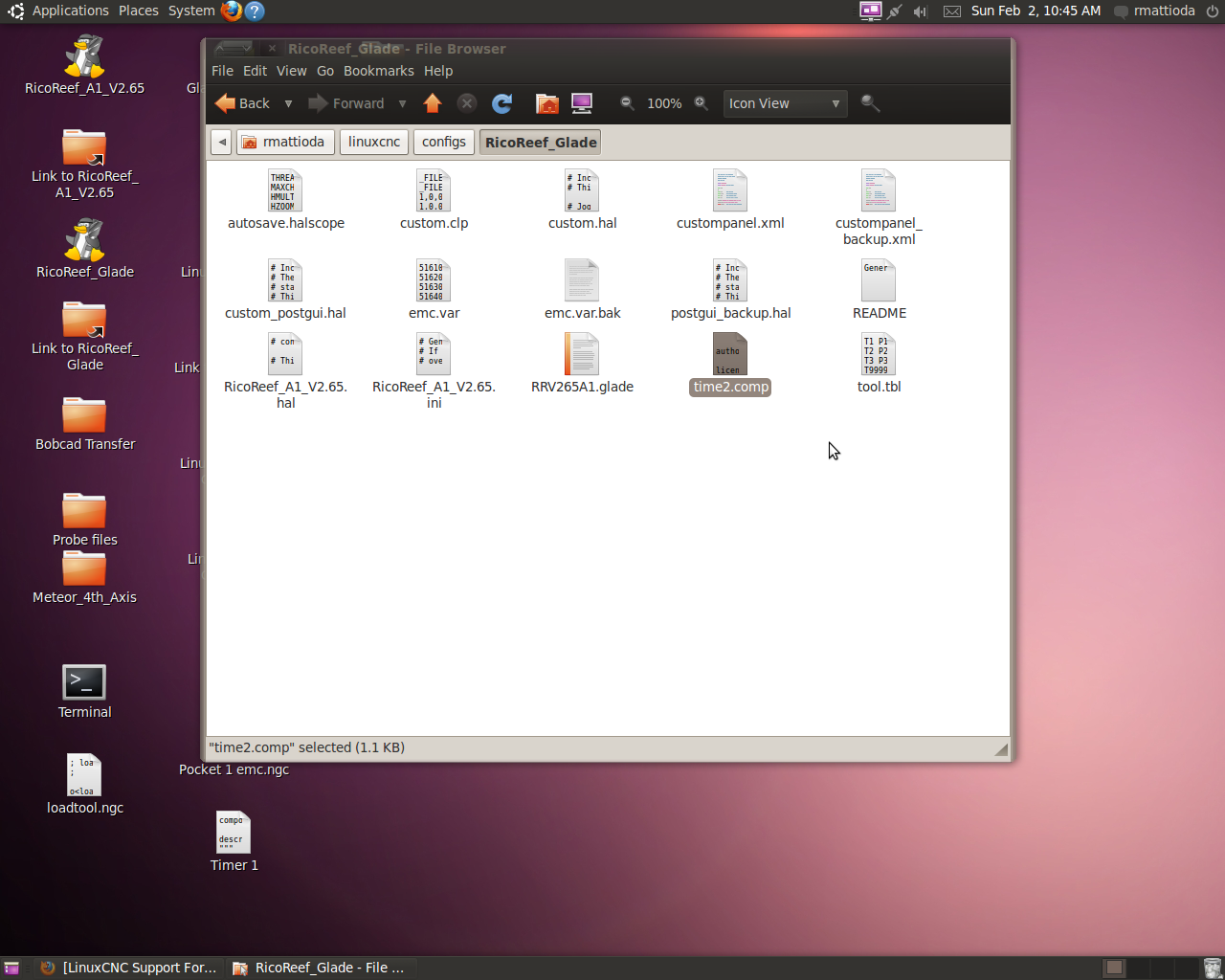

03 Feb 2014 00:43 #43447 by rmattioda
Replied by rmattioda on topic help with Timer
here are the screen shots of my install attempt
the first shot shows where it is placed
the second shows the install attempt
I have a feeling my time2.comp is the issue that's why I wanted you to look at it
thanks
03 Feb 2014 00:54 #43450 by ArcEye
Replied by ArcEye on topic help with Timer
There are 2 problems
The first is that you did not cut and paste the code I posted, you just cut the bit you thought was important.
The first line is the declaration of the component name, you need to cut and paste everything
sudo: comp --install command does not exist
The second problem is that you do not have linuxcnc-dev installed, thus comp does not exist
sudo apt-get install linuxcnc-dev
Then try again
