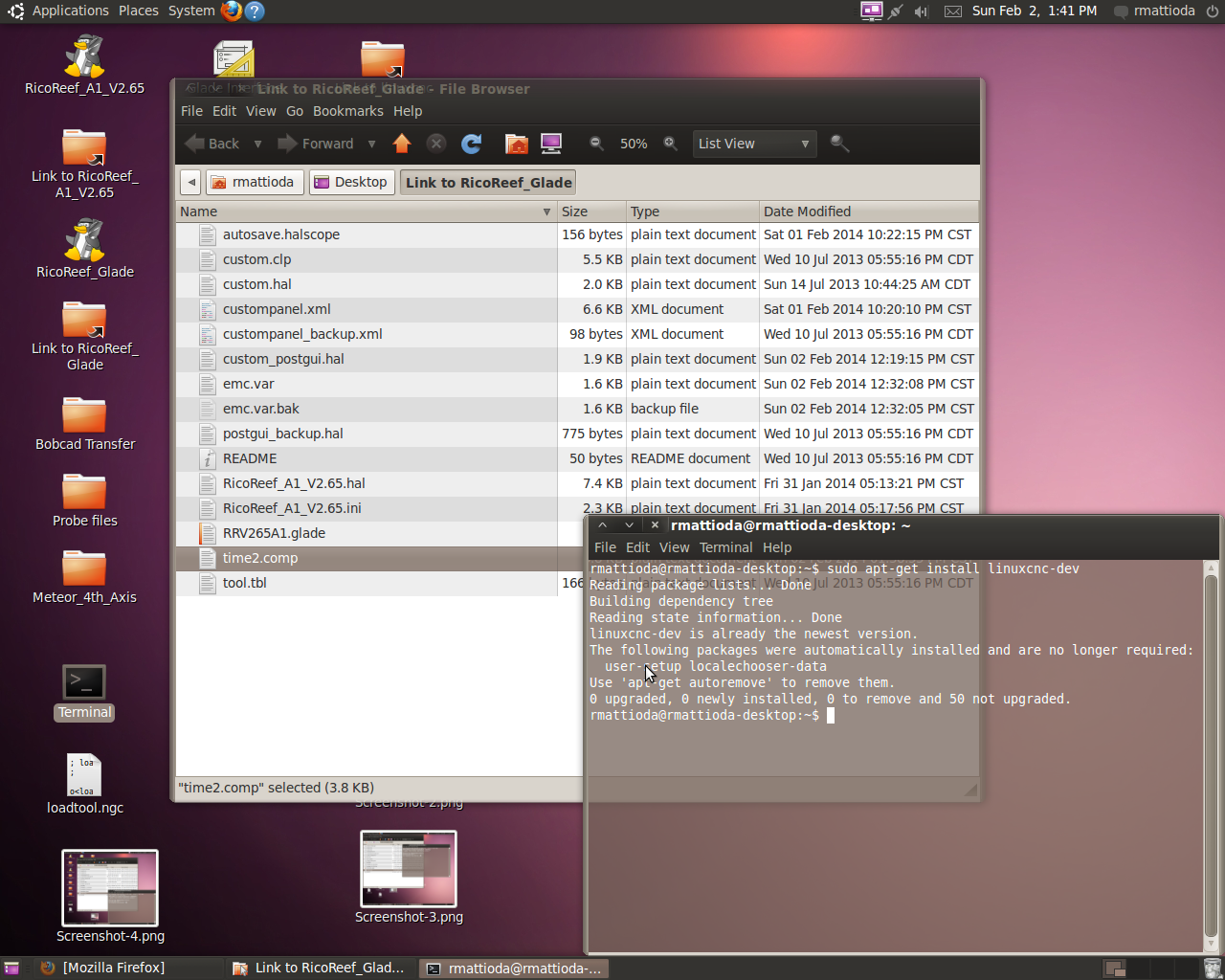

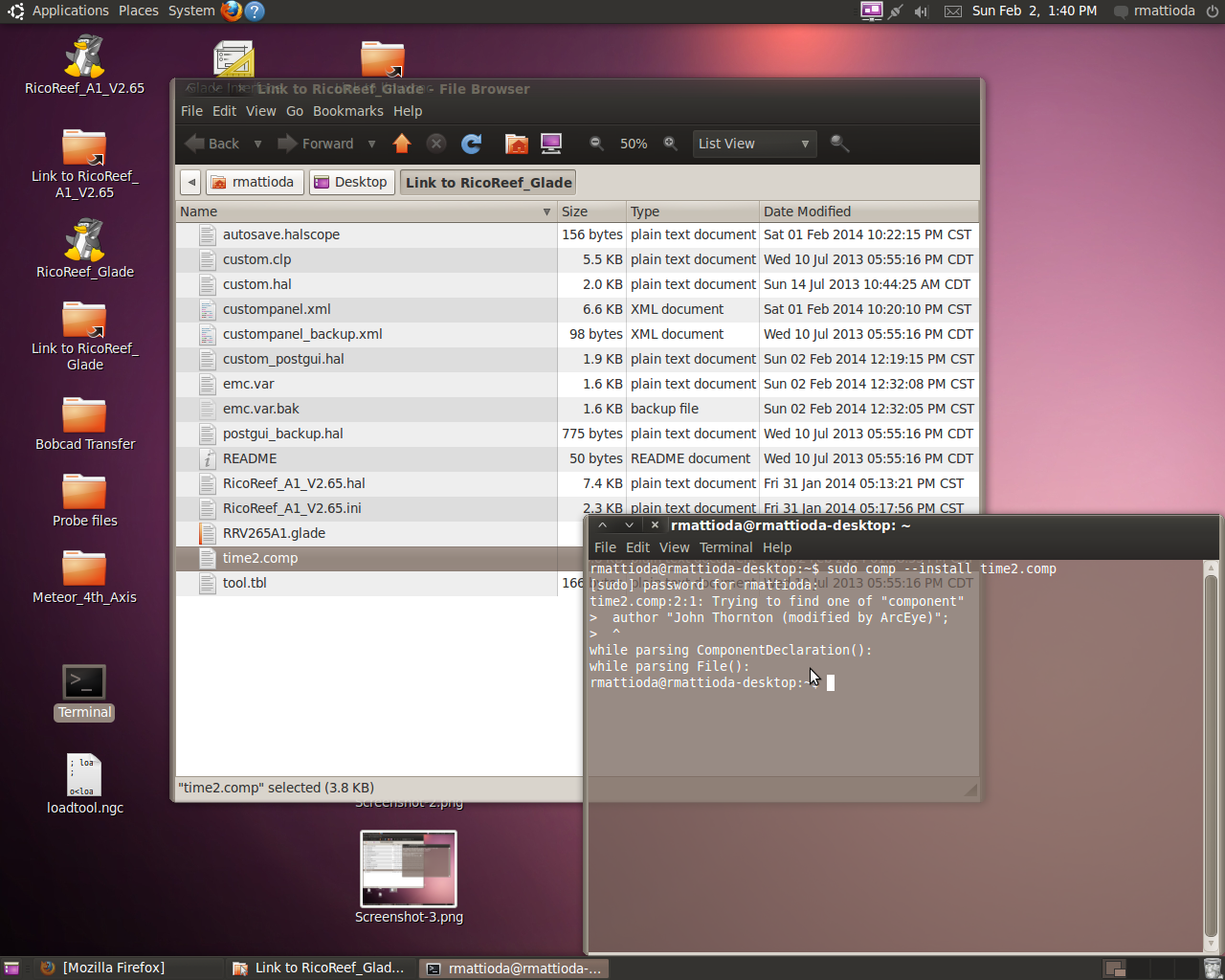

03 Feb 2014 03:35 - 03 Feb 2014 03:37 #43464
by rmattioda
Replied by rmattioda on topic help with Timer
same thing,..Screen 4 shows what I get when trying to install the time2.comp
screen 5 shows the screen after I command : sudo apt-get install linuxcnc-dev
is this normal?
so what do you think the issue is, do I need to re install linuxcnc?
do I have to download the linuxcnc-dev? or is already in the 2.5.X install?
I also attached the new file i used from your post.
is this normal?

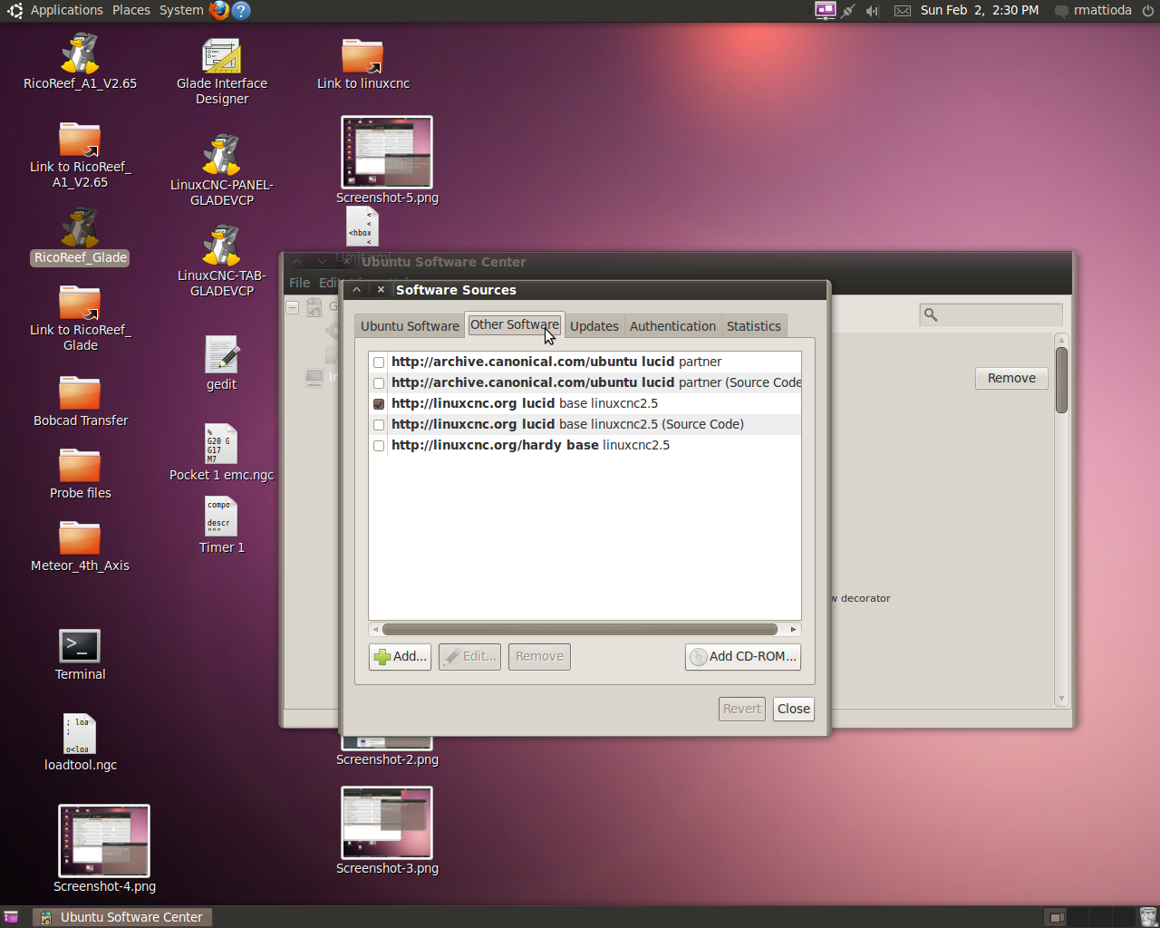

- rmattioda
- Posts: 55

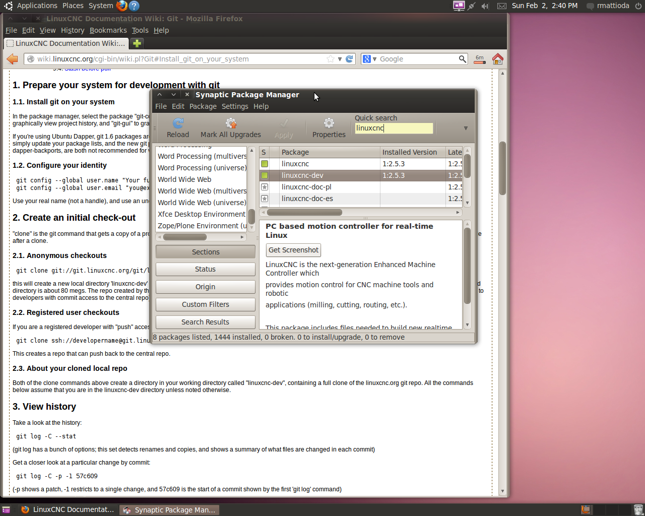

03 Feb 2014 04:03 - 03 Feb 2014 04:36 #43466
by rmattioda
thanks for all the help so far, appreciated
is there a terminal command to check what version you have?
does it have anything to do with this screen on the Ubuntu software update page?
when looking at the package manager it appears that it is installed, when I check the box it gives the option to "re install" which tells me that It is already installed.
(photos enclosed)
(photos enclosed)

03 Feb 2014 17:22 - 03 Feb 2014 17:24 #43484
by ArcEye
If you mean what version of linuxcnc you have, you don't need to, the screenshot of Synaptic clearly shows it is 2.5.3
I think things are getting confused.
You have linuxcnc-dev and thus have comp
Unless you have installed it, you will not have gcc or any of the compiling tools necessary to build the component, so next install the meta package build-essential.
sudo apt-get install build-essential
Then download the copy of time2.comp I posted at #43462 and save it in your config folder

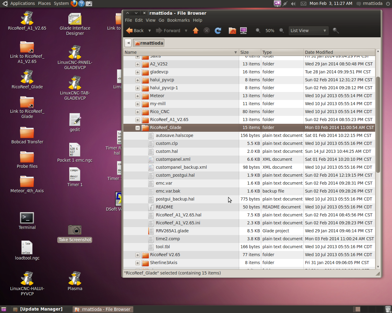

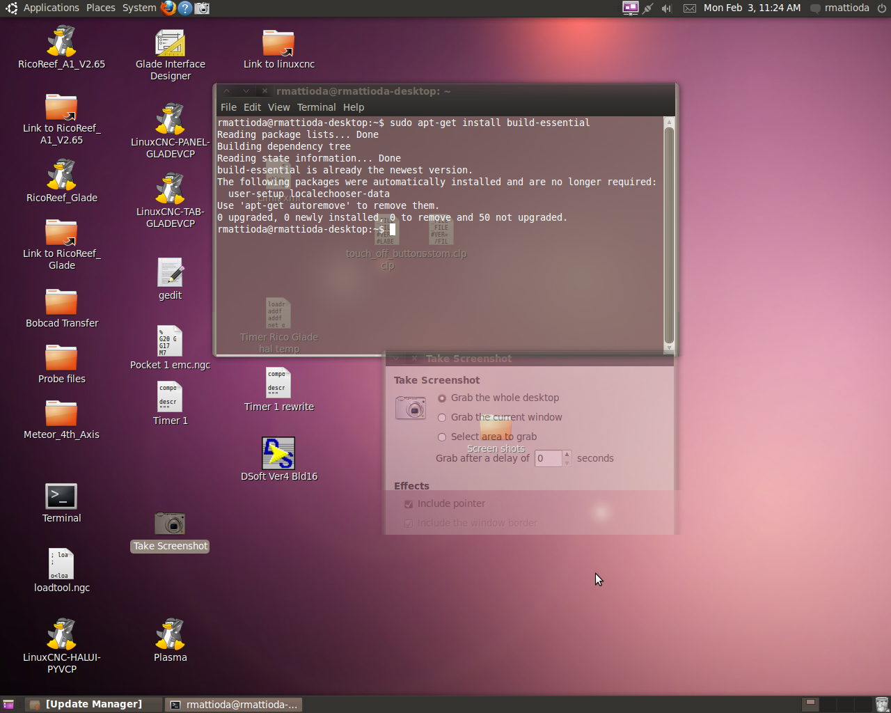

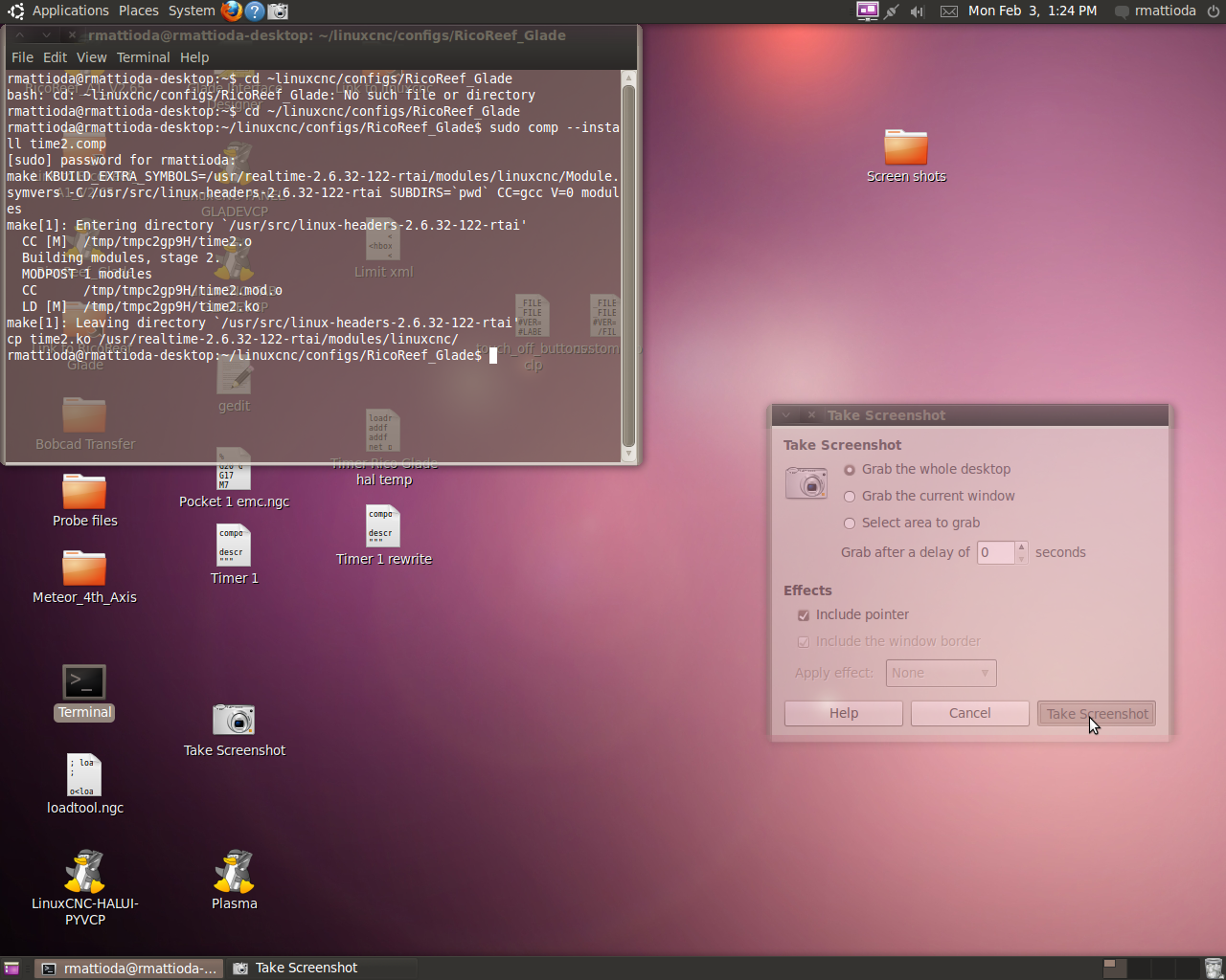

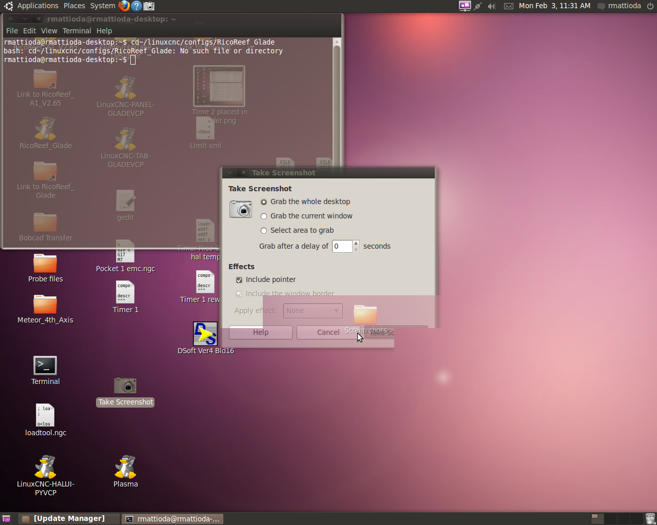

- rmattioda
- Posts: 55
04 Feb 2014 01:38 #43505
by rmattioda
ArcEye,
I tried everything as per your instructions and this is what I am doing.
*When I download your file from 43484, this is how i am doing it, 1. right click on the link save as a text document in gedit (I have enclosed that copy of the file)
*I then place that file in the config folder, in this case it is RicoReef_Glade (screens attached)
*Next I open terminal and execute the sudo apt-get install build essential (screen attached after I hit enter)
*Here is where the problem starts, once again in terminal I put the command in (cd ~/linuxcnc/configs/RicoReef_Glade)it says that it is not found. (screen attached)
*And for the sake of trouble shooting I exacuted the (sudo comp --install time2.comp) to see if it works (screen attached) with the same results.
once again
once again
- Posts: 19155
- Thank you received: 5291
04 Feb 2014 02:30 - 04 Feb 2014 02:32 #43507
Replied by PCW on topic help with Timer
needs a space between the cd and the ~/linuxcnc/configs/RicoReef_Glade
(there's no space in the screenshot)
The timer2.comp file you posted compiles fine
Heres what I get on my (very different) setup:
pcw@pcw-G41M-Combo:~/linuxcnc/configs$ comp --install time2.comp
Compiling realtime time2.c
<command-line>:0:0: warning: "_FORTIFY_SOURCE" redefined [enabled by default]
<built-in>:0:0: note: this is the location of the previous definition
Linking time2.so
cp time2.so /home/pcw/linuxcnc-dev/rtlib/rt-preempt/
Notice that I dont happen to need the sudo since my linuxcnc installation is a
Run-In-Place configuration

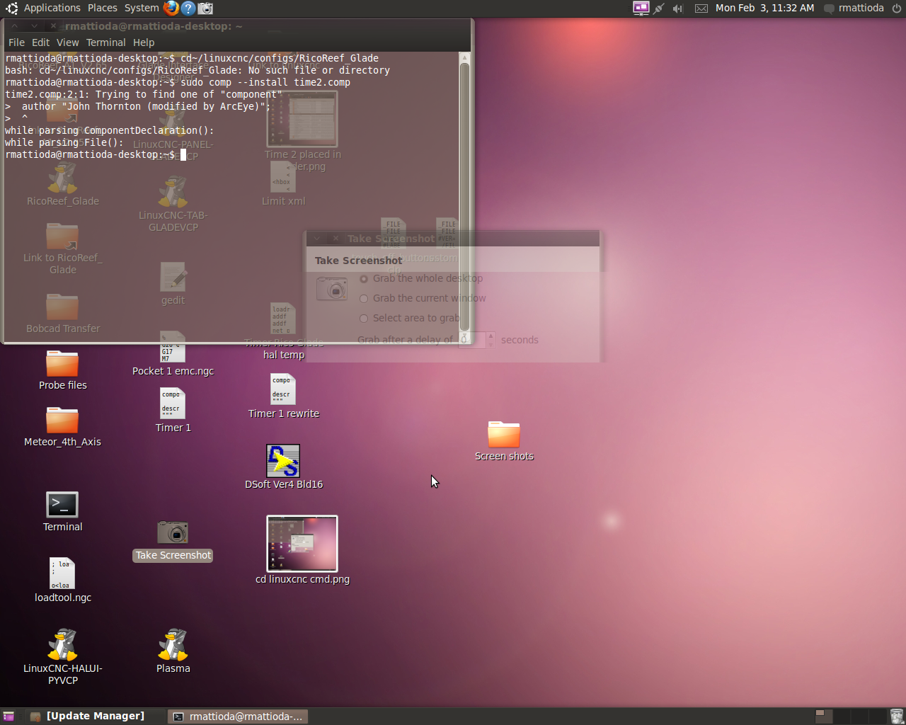

- rmattioda
- Posts: 55
04 Feb 2014 03:18 #43510
by rmattioda
this is what I got this time after using the sudo command, does this look right?
screen attached
screen attached
