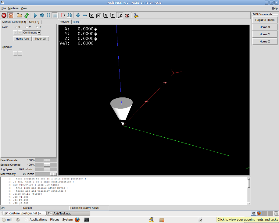

now about naming the pin.
do i use the name in the list halui.joint.0.home as in <halpin>halui.joint.0.home</halpin> in the xml file
or is it a name i can pick ? <halpin>just-home-x</halpin>
then bring that name to the hal file.

i have this now. MDI stiil works and the other one doesn't(not suppose to right now-no link)
took the other two buttons out til i get ONE right. when i put just-home-x in the hal file, says doesn't exist when starting EMC
i've tried
net home-x just-home-x => pyvcp.halui.joint.0.home
net home-x halui.joint.1.home => pyvcp.just-home-x
net home-x just-home-x => pyvcp.home-x
net home-x home-x => pyvcp.just-home-x
net home-x just-home-x => halui.joint.0.home
net home-x halui.joint.0.home => just-home-x
net just-home-x halui.joint.0.home <-- this one started emc but didn't work
the second location(pin) should be what i make up or the pin in the list halui.joint.0.home

Ok time to stop guessing... some important info to know
When you add a button with pyvcp and create a hal pin it adds pyvcp. to the pin name so your
<halpin>"just-home-x"</halpin>
becomes the hal pin pyvcp.just-home-x
So now we know the full name of your button hal pin you can create the net command to connect the two hal pins.
net home-x halui.joint.0.home <= pyvcp.just-home-x
John
John

thanks,
got all four buttons to work. i didn't(couldn't get) where the halui.joint.0.home went.
when i had it in the right place i guess i had something else wrong.
i really do appreciate all ya'll help (TWO DAYS) and i owe ya'll some cold beer.

- BigJohnT
- Posts: 6999
- Thank you received: 1176
05 Apr 2011 18:29 #8612
by BigJohnT
Replied by BigJohnT on topic Re:PYVCP format help
I was fixing to say where are the buttons??? LOL
