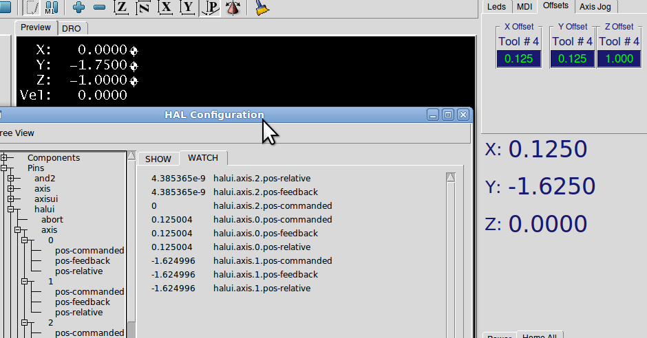

26 Apr 2011 18:42 - 26 Apr 2011 18:54 #9344
by piasdom
Replied by piasdom on topic Re:PYVCP format help
in the hal configuration window, i watch xyz's commanded,relative and feedback positions.
aren't they suppose to be different if offset are enabled ? aren't they suppose
to be different some way ? axis view is relative.
in the pic, axis Z is suppose to be zero, as it doesn't move in the file. but the offset is one inch.
isn't it suppose to be zero ?in my hal file for the pyvcp, i'm using
halui.axis.2.pos-relative for z's dro.
Last edit: 26 Apr 2011 18:54 by piasdom.
