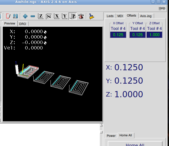

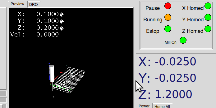

25 Apr 2011 12:04 - 25 Apr 2011 15:16 #9305
by piasdom
Replied by piasdom on topic Re:PYVCP format help
(at work now)
(making a DRO)
with the feedback, relative and commanded position pin. i get the same number.
if i have offsets, shouldn't one(or two) be different ? in Axis, if i have a
z offset of 1", "my" readout reads .9 while running and z is at -.1".
i tried all three pins and i get the same number. is the pins suppose to
be connected to another pin as well ?
offsets;
X - .125
y - .125
z - 1
(making a DRO)
offsets;
X - .125
y - .125
z - 1
Last edit: 25 Apr 2011 15:16 by piasdom.

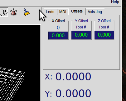

26 Apr 2011 10:22 - 26 Apr 2011 11:07 #9324
by piasdom
and i tried both below to get the relative position of the axis for the DRO. i tried
feedback, commanded and relative. all give the same output. i'm using number display
to get the reading.
halui.axis.N.pos-relative
axis.2.joint-pos-fb
<hbox>
<label>
<text>"Z:"</text>
<fg>"midnightblue"</fg>
<font>('courier 18',18)</font>
<width>2</width>
</label>
<number>
<halpin>"feedback-z"</halpin>
<text>"X DRO"</text>
<font>('courier 18',24)</font>
<format>"2.4f"</format>
<bd>2</bd>
</number>
</hbox>
to get the reading.
axis.2.joint-pos-fb
<hbox>
<label>
<text>"Z:"</text>
<width>2</width>
</label>
<number>
<bd>2</bd>
</number>
</hbox>
Last edit: 26 Apr 2011 11:07 by piasdom.
