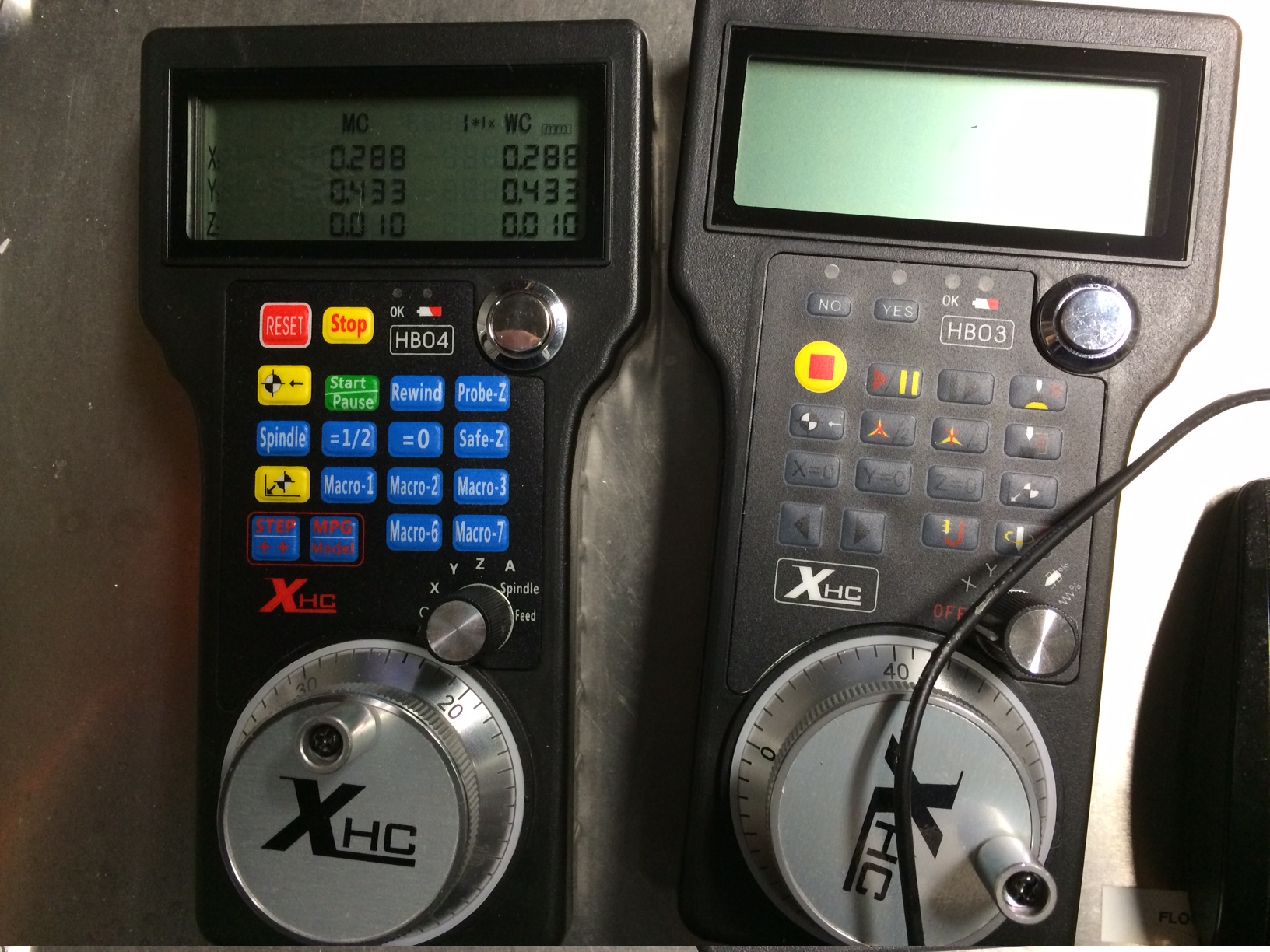

26 Jan 2014 13:11 #43181 by bottleworks
Replied by bottleworks on topic XHC-HB04 wireless MPG pendant HAL module
So, I have two of these wireless MPGs. The last results were with an HB03. Using the HB04, I am getting data returned when pressing the buttons. Any chance of the HB03 being usable? I haven't tried running EMC again to see if it now works.
26 Jan 2014 14:31 - 26 Jan 2014 14:34 #43184 by bottleworks
I've attached an open office spreadsheet of the Hex replies from my HB04. It looks like I've got everything working until I configure my setup and I'm not sure where to go.
It would be nice to figure out if that HB03 can get working for another LinuxCNC machine that I'm going to setup shortly. It ended up being free, so there isn't much loss if it's incompatible.
It looks like I can't attach a SS. Here it is:
Button	depressed
reset	04 17 00 00 00 1B
stop	04 16 00 00 00 1A
O ←	04 01 00 00 00 0D
start/stop	04 02 00 00 00 0E
rewind	04 03 00 00 00 0F
Probe-Z	04 04 00 00 00 08
spindle	04 0C 00 00 00 00
"=1/2"	04 06 00 00 00 0A
“=0”	04 07 00 00 00 0B
Safe-Z	04 08 00 00 00 04
L ← O	04 09 00 00 00 05
Macro-1	04 0A 00 00 00 06
Macro-2	04 0B 00 00 00 07
Macro-3	04 05 00 00 00 09
Macro-6	04 0F 00 00 00 03
Macro-7	04 10 00 00 00 1C
Step ++	04 0D 00 00 00 01
MPG Mode	04 0E 00 00 00 02
Knob to X	04 00 00 11 00 0C
Knob to Y	04 00 00 12 00 0C
knob to Z	04 00 00 13 00 0C
knob to A	04 00 00 18 00 0C	Repeated a stream
knob to spindle	04 00 00 14 00 0C
knob to feed	04 00 00 15 00 0C
knob to off	04 00 00 00 00 0C

26 Jan 2014 15:36 #43185 by bottleworks
Ok, I'm preliminary up and running. Sorry for all the posts.
But if anyone has any ideas on getting that HB03 to talk, please let me know!

26 Jan 2014 17:08 #43191 by f1oat
Replied by f1oat on topic XHC-HB04 wireless MPG pendant HAL module
There are some clues about WHB03 here: forum.planet-cnc.com/viewtopic.php?f=12&t=1125
Try to replace 0xEB70 by 0xEB6E at line 571 of xhc-hb04.c
It should detect the WHB03.
I do not know yet how much additional modifications will be needed for this MPG, but buttons may already work.
Frederic.

26 Jan 2014 17:51 - 27 Jan 2014 04:50 #43192 by bottleworks
I will give that a try on another machine and see if it will work. Thanks!
update:
I did a quick check of the IDs on my Macbook. This unit does have the different IDs you have listed. Hopefully that's all which is required.
Composite Device:
  Product ID:	0xeb6e
  Vendor ID:	0x10ce
  Version:	 0.00
  Speed:	Up to 12 Mb/sec
  Manufacturer:	KTURT.LTD
  Location ID:	0xfa130000 / 7
  Current Available (mA):	500
  Current Required (mA):	100
Last edit: 27 Jan 2014 04:50 by bottleworks. Reason: Additional data
