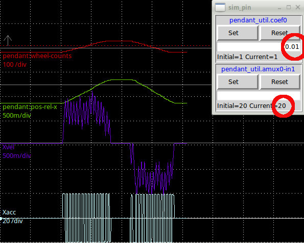

07 May 2015 22:04 - 07 May 2015 22:26 #58485 by dgarrett
Replied by dgarrett on topic XHC-HB04 wireless MPG pendant HAL module
The LinuxCNC 2.6 xhc-hb04.tcl script provide a lowpass filter (README: coefs)
With no filtering (coefs=1 1 1 1), and axis acceleration=20 (inch units),
the velocity and acceleration will have high frequency content: (oops, circled wrong item,
this is with coef=1 (Current = 1)):

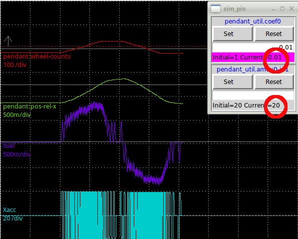

With filtering (coefs= 0.01 ...), the velocity is smoothed but the acceleration
will still be very high in frequency.

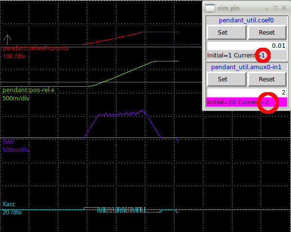

In LinuxCNC 2.7, xhc-hb04.tcl provides a new option to limit the acceleration
while jogging and the behavior is much improved for machines with high accelerations.

I installed 2.7.0 pre7 and tried the mpg_accel settings. I'm very impressed, very smooth acceleration at all feed rates. Another thank you to the developers.
