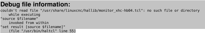

I recently migrated from Ubuntu 10.04/Linuxcnc2.7pre to Wheezy/Linuxcnc2.7.0 using the LiveCD. While my machine operation works as before, I'm having trouble with my xhc pendant. I am trying to follow the guidance given in the README file in the xhc-hb04 sim folder. When I run Linuxcnc, I get the following Debug info:
Is the monitor script not included in the LiveCD distribution? If not, how do I get it?

The error message posted seems to indicate that you
specified monitor-xhc-hb04.tcl as a [HAL]HALFILE= but it
is not a HALFILE, it is specified using APPLICATIONS]APP=
README excerpt:
A application named monitor-xhc-hb04 is included to monitor disconnects and
reconnects of the pendant.  This script runs in the background and will pop up
a message when the pendant is disconnected or reconnected.  Usage is optional;
if used it is specified with ini file entry:
  [APPLICATIONS]APP = monitor-xhc-hb04
The file is named monitor-xhc-hb04 (not monitor-xhc-hb04.tcl though
it is a tcl script) and it is located in /usr/bin and hence
in the standard PATH
Example query of a package install (uspace in this caae):
$ dpkg -L linuxcnc-uspace | grep monitor
/usr/bin/monitor-xhc-hb04
$ ls -l /usr/bin/monitor-xhc-hb04
-rwxr-xr-x 1 root root 4396 Sep 10 21:29 /usr/bin/monitor-xhc-hb04
Running one of the supplied simulator configs and studying
the ini file may be helpful
Ref: README for 2.7
git.linuxcnc.org/gitweb?p=linuxcnc.git;a...675ba593695c;hb=HEAD
