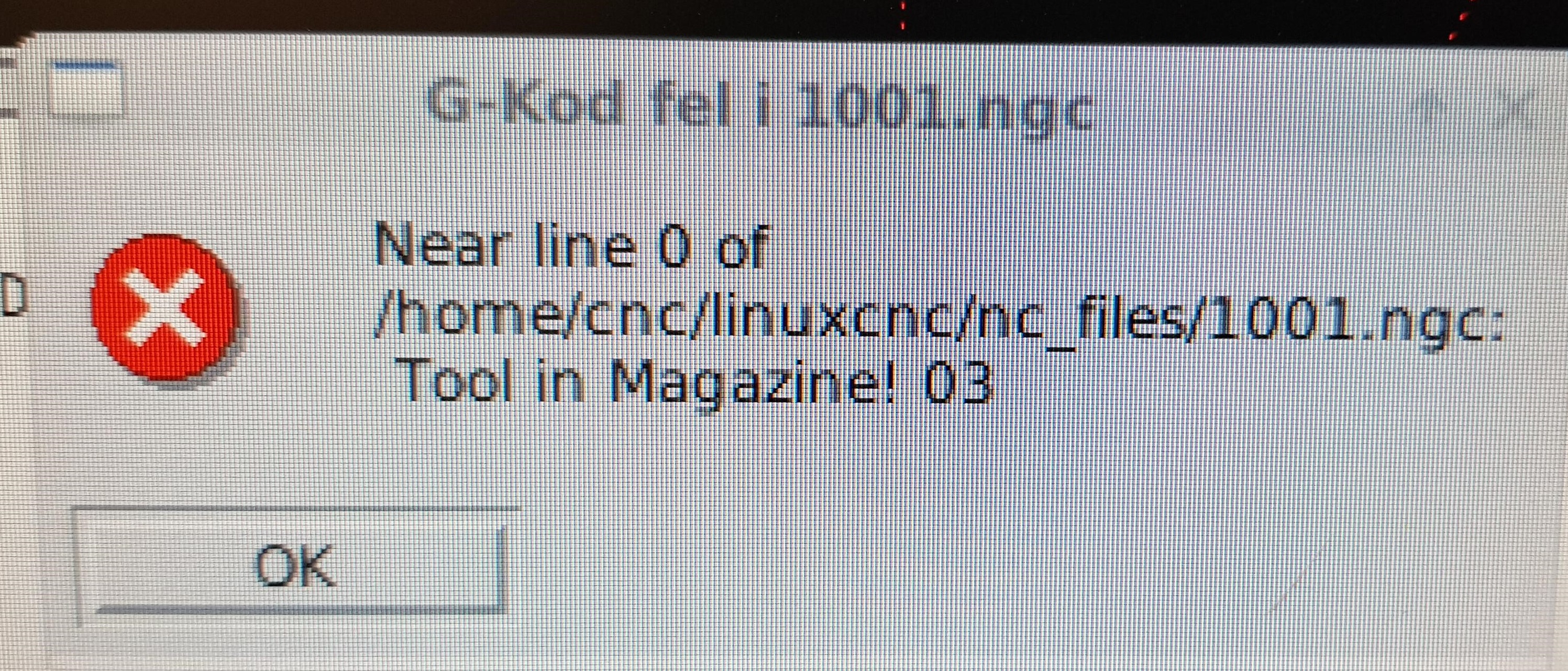

03 Dec 2019 10:37 #151832
by CNCDoc
Replied by CNCDoc on topic VMC related HAL questions.
Receives the following error message when I load a g code with the tool changes.
I comment off the line N25 the file opens properly. The text of the error message is from my tool changer sequence.
What causes this?
1001)
(T1 D=6.5 CR=0. TAPER=118DEG - ZMIN=-17.153 - DRILL)
(T2 D=10. CR=0. - ZMIN=-15.4 - FLAT END MILL)
N10 G90 G94 G17 G91.1
N15 G21
N20 G53 G0 Z0.
(DRILL2)
N25 T1 M6
N30 T2
N35 S3500 M3What causes this?
03 Dec 2019 11:10 #151837
Execution of the M19 won't complete until the spindle-is-oriented pin goes high.
linuxcnc.org/docs/2.8/html/gcode/m-code.html#mcode:m19
Replied by andypugh on topic VMC related HAL questions.
For the spindle to have time to index before alarm.
Was the idea.

Is this the cause of the error message above?

Replied by tommylight on topic VMC related HAL questions.
Error says line 0, that line is missing a bracket.

03 Dec 2019 11:53 #151840
by CNCDoc
excuse my lack of knowledge. bracket?

03 Dec 2019 12:06 #151842
(1001)
Should be:1001)
(1001)
