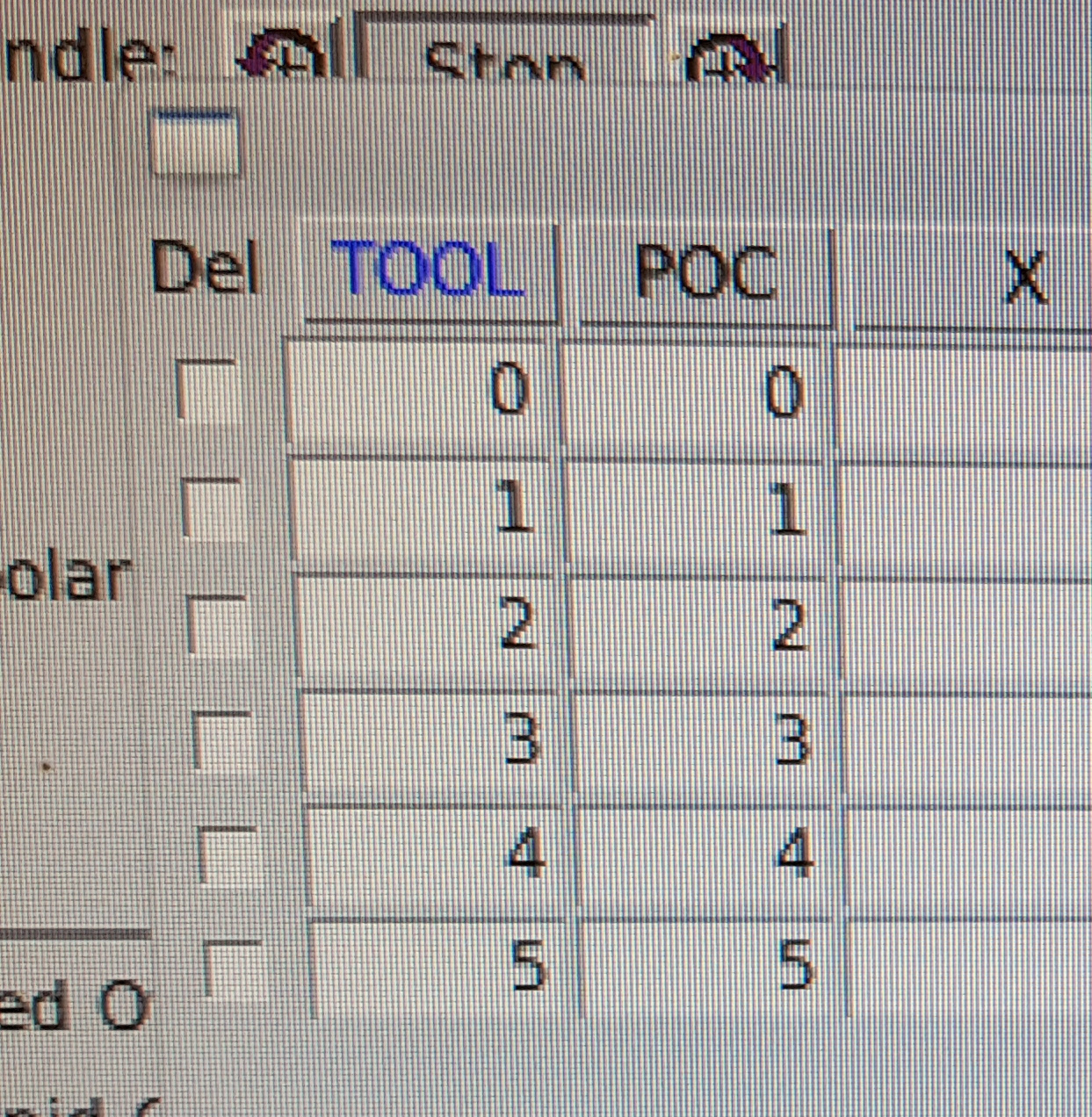

02 Sep 2019 17:30 #143908
Replied by andypugh on topic VMC related HAL questions.
Which pocket is tool 3 in in the tool table?
(typically you will have more tools than pockets, so there is a separate entry in the tool table for the pocket)

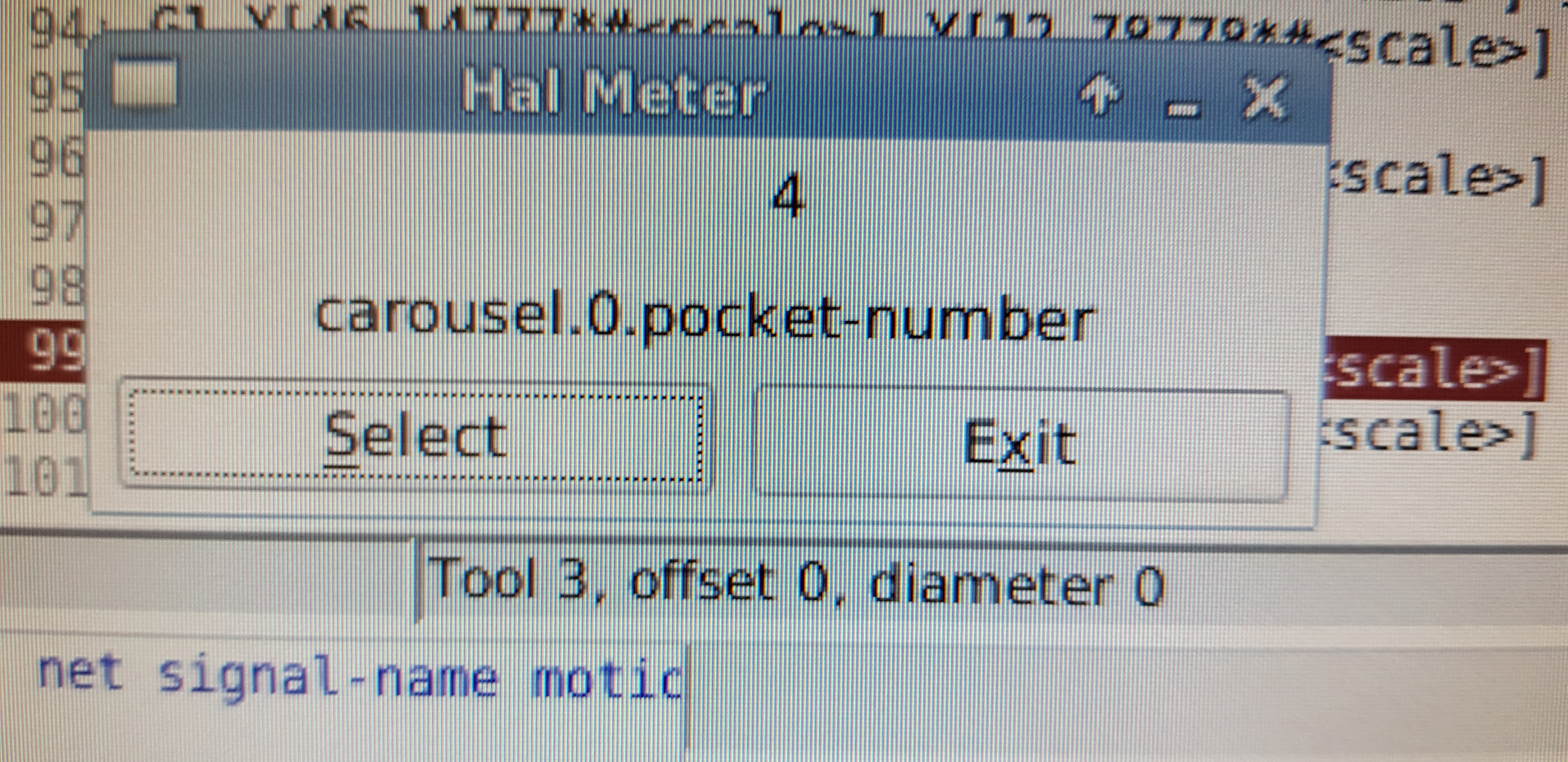

02 Sep 2019 17:31 #143909
You can also use Halmeter to check if the state of motion.digital-in-nn changes when there is a tool in the spindle.
