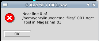

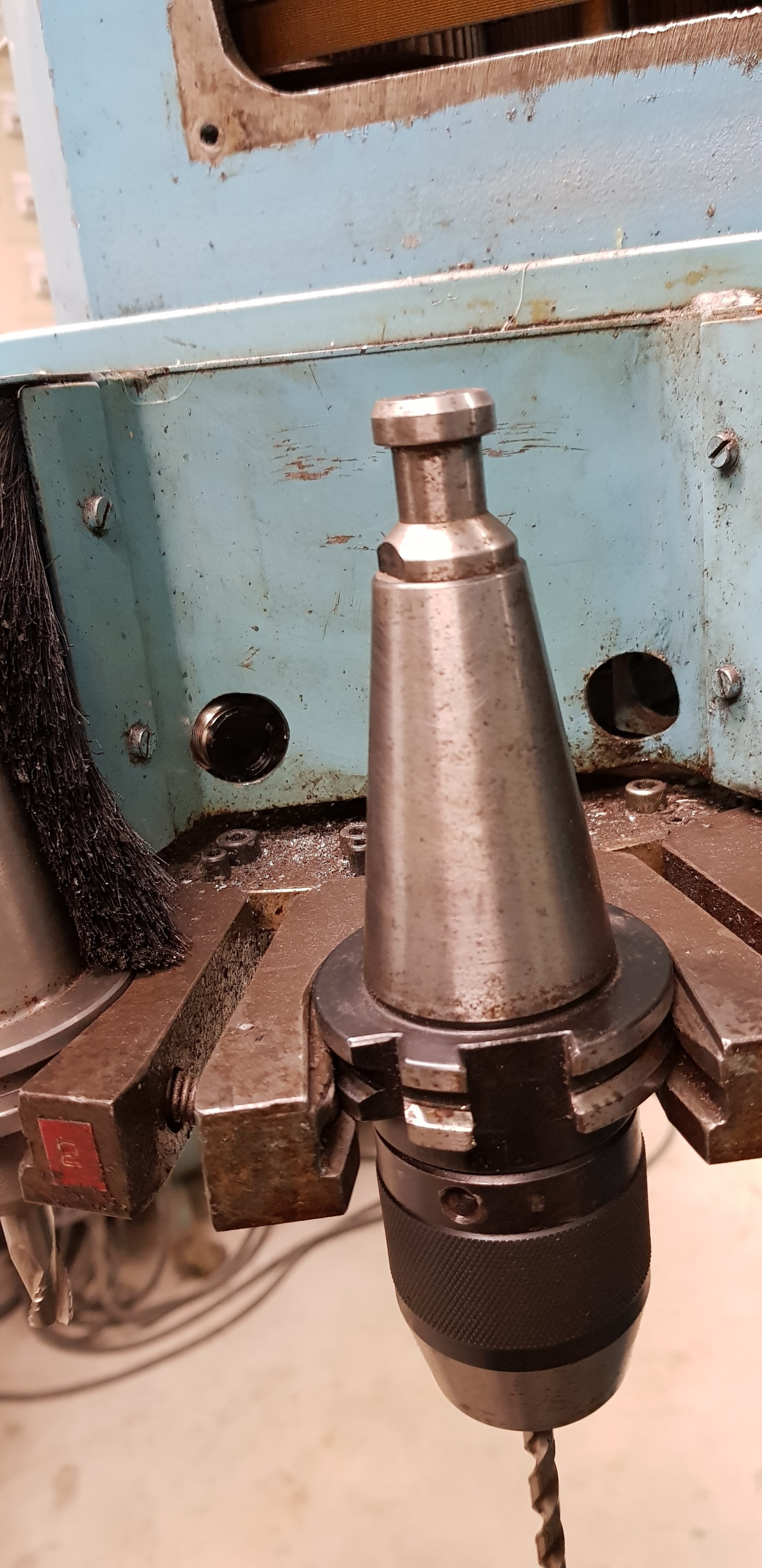

Because there is a tool holder there. the tool change sequence is read when i load g code?
Replied by CNCDoc on topic VMC related HAL questions.
The error message you show is from here:
(MSG, Checking MagPos 02) M66 P5 L0 ; Check if mag pos is empty? o103 if [#5399 EQ 0] (abort, Tool in Magazine! 03) o103 endif (MSG, Moving arm 04)
So you see the error message because G-code digital input 5 is true.
So, why is that? Is it true?
03 Dec 2019 14:29 #151871
Replied by andypugh on topic VMC related HAL questions.
Your remap may need to detect whether it is running or previewing.
linuxcnc.org/docs/2.8/html/remap/remap.h...apped-code-execution

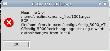

I have to do something wrong, it does not work
o999 IF [#<_task> GT 0]
o<toolchange> RETURN
o999 ENDIF
o<toolchange> sub

04 Dec 2019 10:40 #151965
The if/return/endif needs to be inside the o<toolchange>sub / o<toolchange> endsub tags.

04 Dec 2019 11:13 - 04 Dec 2019 11:21 #151973
by CNCDoc
Now I get the following error
o<toolchange> sub
O999 IF [#<_task> GT 0]

With this code I get the following error message when I load g-code
And this one when I try to change the tool

04 Dec 2019 11:42 - 04 Dec 2019 11:42 #151978
o<toolchange> sub
O999 IF [#<_task> EQ 0]
o<toolchange> RETURN [1]
O999 ENDIF
Last edit: 04 Dec 2019 11:42 by andypugh.
